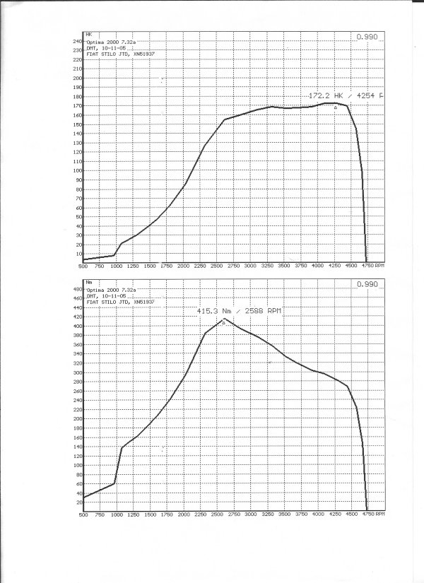

I don't think the tolerance on the clutch is to blame, you have to remember that it has 305 nm as standard (mine had 334 nm standard so that's well above what it's supposed to have) and after the remap it has 415 nm. That's an increase of over 33% and i don't think they build in that nig a tolerance. The tolerance is more likely around 20% (which is around 370 nm).

It's not the bhp that's the problem, it's the torque.
When a car has 305 nm as standard, the clutch is perhaps designed to handle +20% torque (in this case ca. 360 nm), above that and it can't handle the torque and it starts to slip.
When you reach 170 bhp in the multijet,it's around 3500 rpm but the torque at 3500 rpm is close to 340 nm which is just 10% more than the highest standard torque. 155 bhp at 2600 rpm is on the other hand equal to 415 nm at 2600 rpm, and this is simply too much torque for the clutch (a plus of 33%).
So you can have lots of horsepower in the higher rev-range, but you need to be careful at the low and mid range.
So i don't think you can use the clutch from the Abarth, since it only has around 230 nm as standard.
I hope it makes sense.....(y)

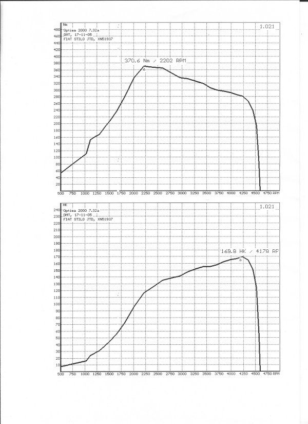

The Stilo has has now been tweaked down to a more humane level for the clutch.
The figures are as follows:
169,8 bhp at 4178 rpm
370,6 nm at 2202 rpm
and i have to say, it actually feels better with this new remap than with the other one.
And my clutch isn't slipping anymore (y)
The graphs as promised.
There is one showing the car as standard, one with the first remap (with too much torque) and one with the second remap (the one i'm driving with).
