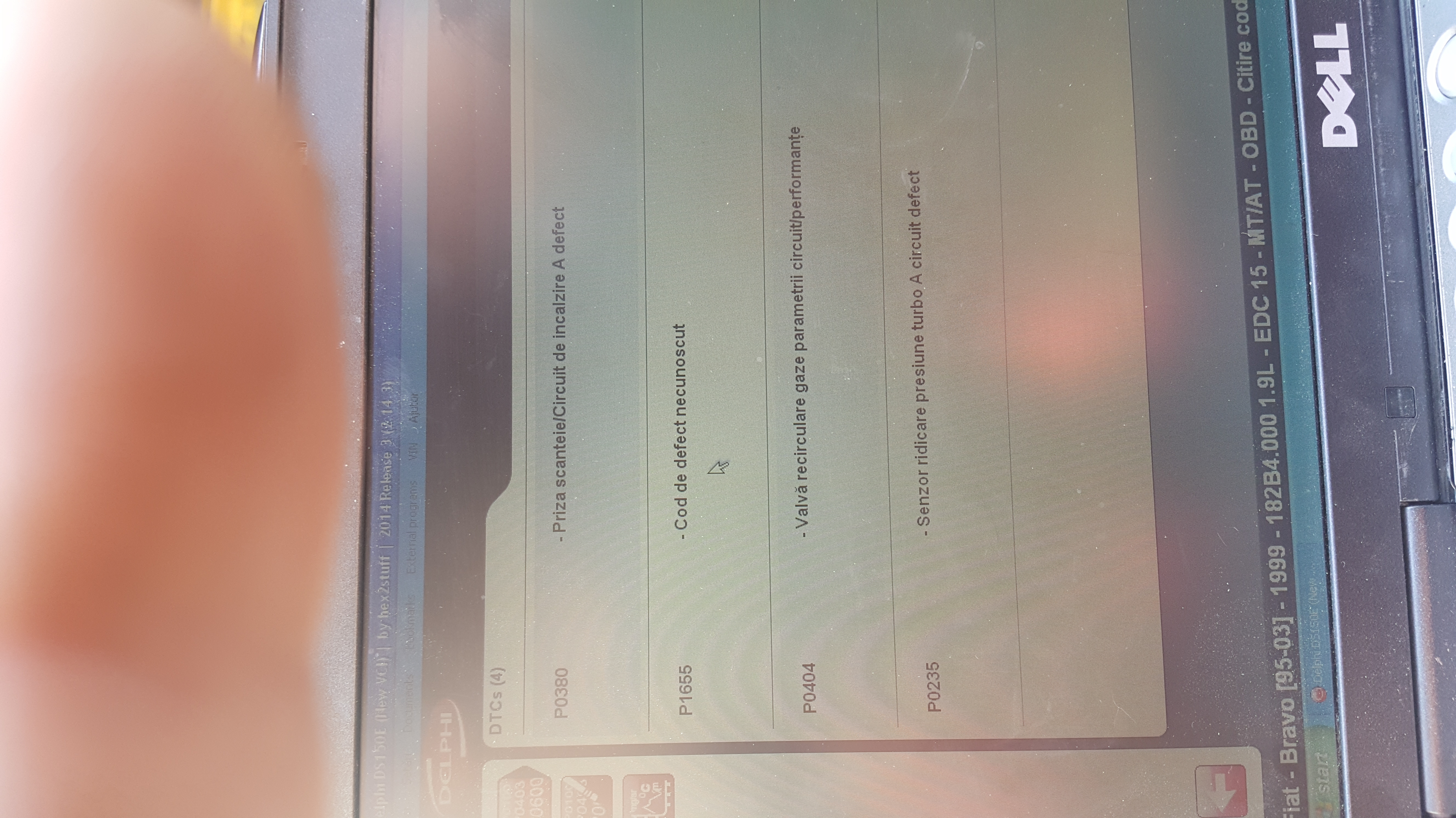

So yesterday i change the map senzor because it was an error and today the car still not working and i have this errors.maybe someone knows whats the problem.i think maybe a turbo pipe is broken or the intercooler its cracked i dont know.

Look up the meaning of the fault codes shown on your scan.
Use Google

You must look at ECU scan you have already done look up codes so you understand what they mean.
Show scan to your mechanic friend.
Then erase codes.
Then drive car for a few days.
Then scan for codes again and take action to fix codes.
You can ignore the code relating to glow plugs that is only for starting.

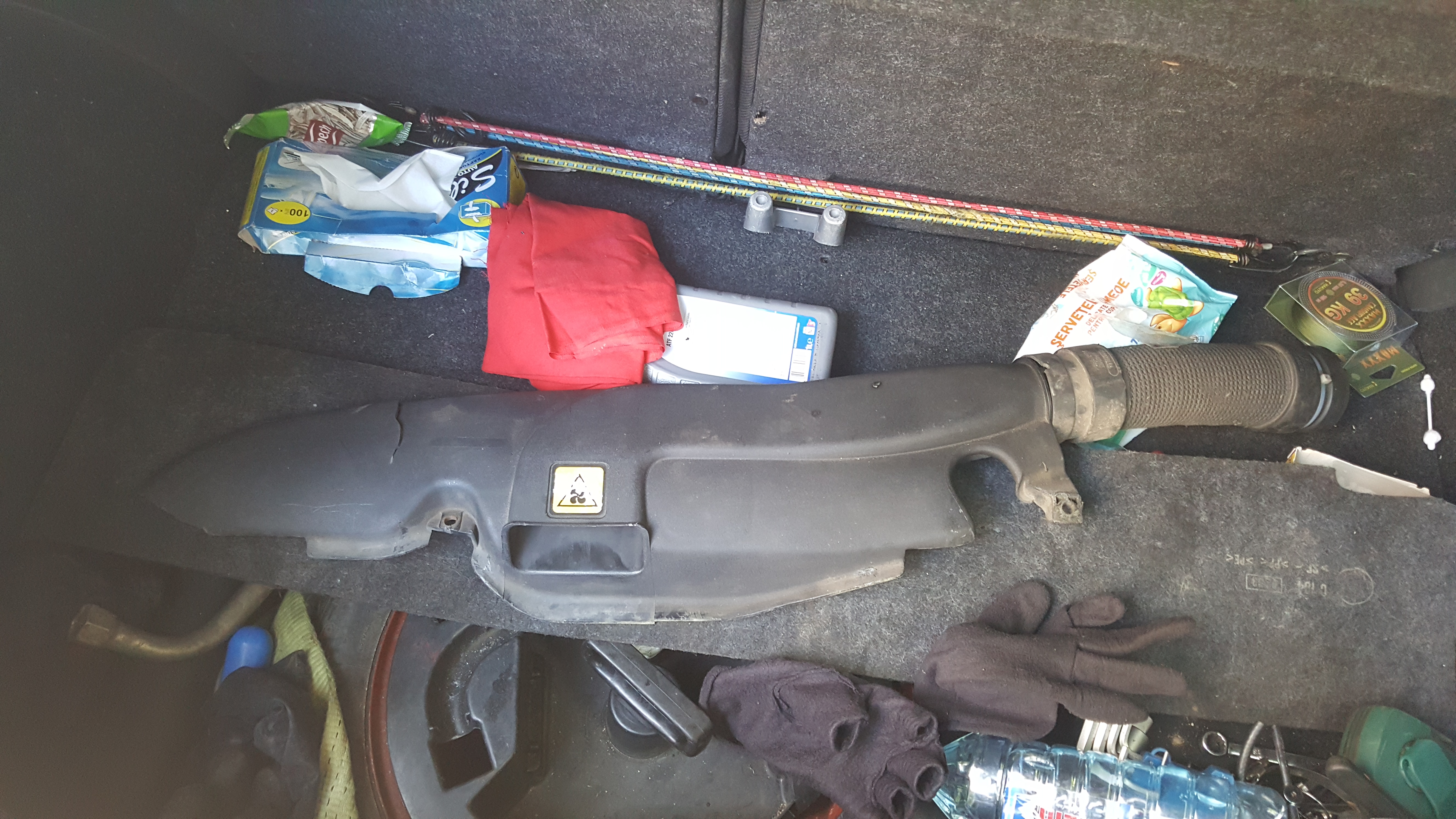

So i think i have find the problem.last night the car wa working great.today in morning in my way to work the light again apears and the was slow.i started to think what i did yesterday.i ask a friend to help me to push the acceleration and i go under the car to check the pipes.after a few pedals my friend told me the check light is gone i was like whattt???i take tge car for a spin and work great.but whithout the pipes that the turbo takes air from outside i have put a picture.and the pipe that i uploaded early is broken.so i think the turbo takes air from outside before the maf senzor and agai from that broken pipe.i started to think logic if the pipe is broken before the maf senzor is not working good the values are low.
This is the part that goes in to the filter

None of the codes you posted are mad sensor.
Removing the pipe going from outside air to air filter will only make difference if it's blocked.
Pipe from air filter to turbo must be good or you will have problems

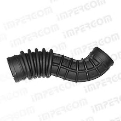

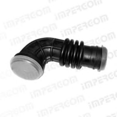

Can someone help me to find the oe code for this pipe i try eper but it doesnt work.
I have found the oe code for this pipe and i order it.i will keep you guys updated.this is the oe code for that pipe 46536465.
