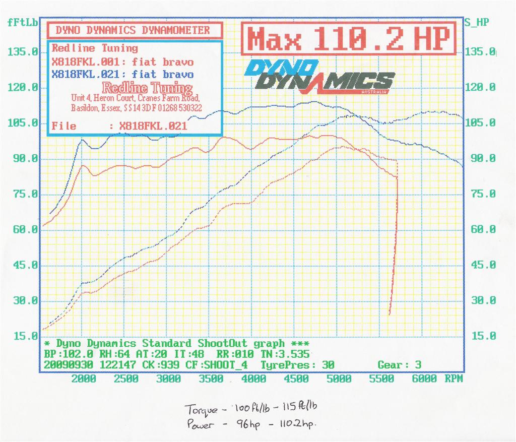

Well, finally the car is back to going well.
The Dastek Unichip has been fitted and mapped.
After the origional tune of cams and head work, the car had lost 4bhp and the torque was down right through the revrange. The unichip has sorted that now, and has got plenty back everywhere.
Note - two different dynos, so the graphs dont tally up on power outputs.
Apparently the ignition needed plenty of advance to get this result.

i wouldve thought u had a lot more extra power with everything u had done. what exhaust system and airflow u running?
iv just swapped my full straight through system for a powerflow kit and the car seems to drive alot better

Still running theorigional exhaust system, air comes in through the standard airbox with a K&N filter.

I don't have photo's of what was done. They guy who did the motor work is a friend of mine, who owns a car race tuning company called SMD racing. I guess I could do with a better exhaust system and better airbox to make the most of everything alse now. Moneys tight at the moment though.
