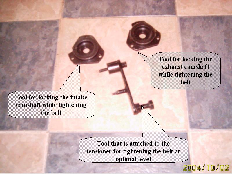

1.6 16-valve requires special tools to tighten the belt at optimal level. So insist on those tools if you go to any mechanic!
