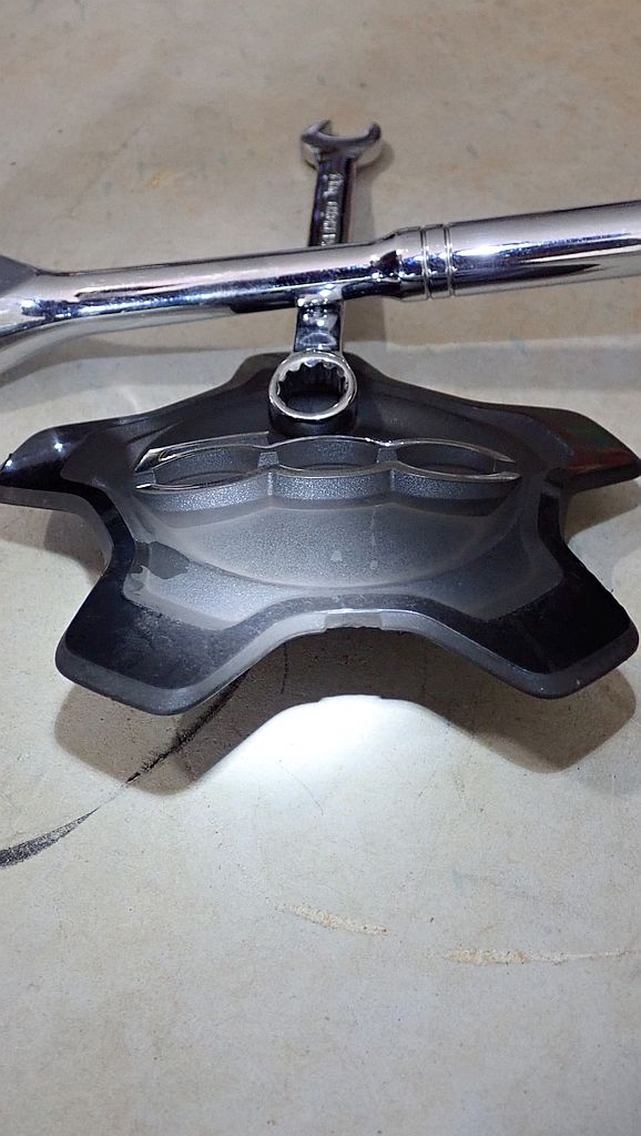

1. pull off the hub cap, there is a notch under the "500" for flat head screwdriver

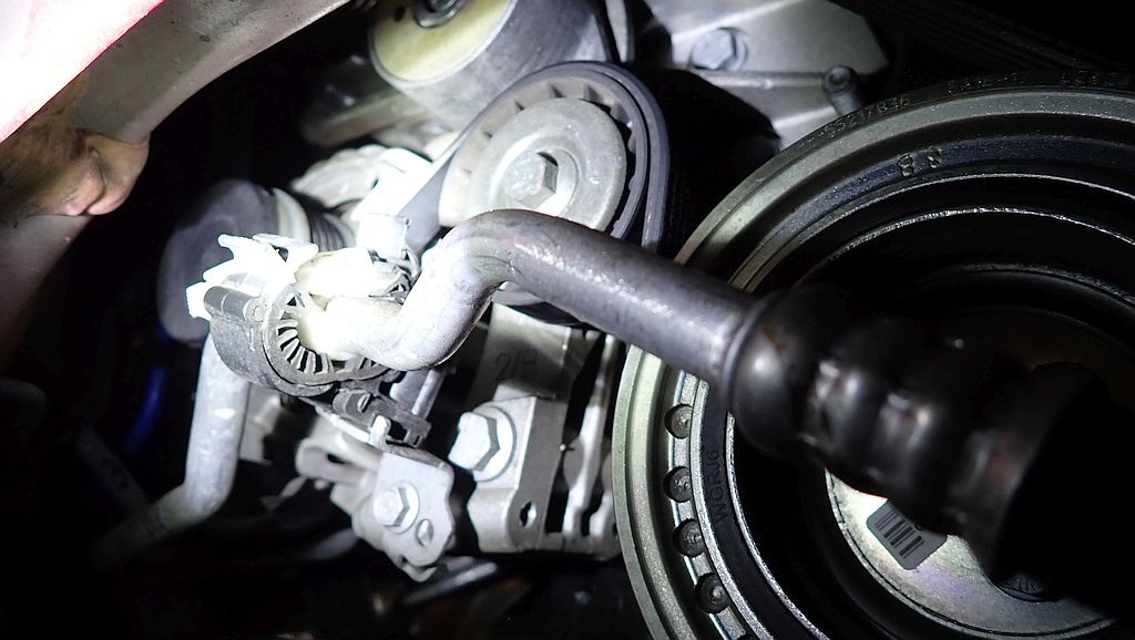

8. use 400mm long breaker bar with 13mm socket to turn the tensioner pulley bolt ANTICLOCKWISE to take tension off the belt
9. slip belt off the tensioner pulley first, then main drive pulley and then pull out completely; any other sequence will not work
10. put new belt in from the engine bay, make sure it is correctly sitting within the alternator pulley, leave it off the tensioner pulley only
11. get the breaker bar again, turn it anticlockwise and should be able to slip the belt on; if it doesn't want to go on, check the fitting on the alternator pulley (ask me how I know).
