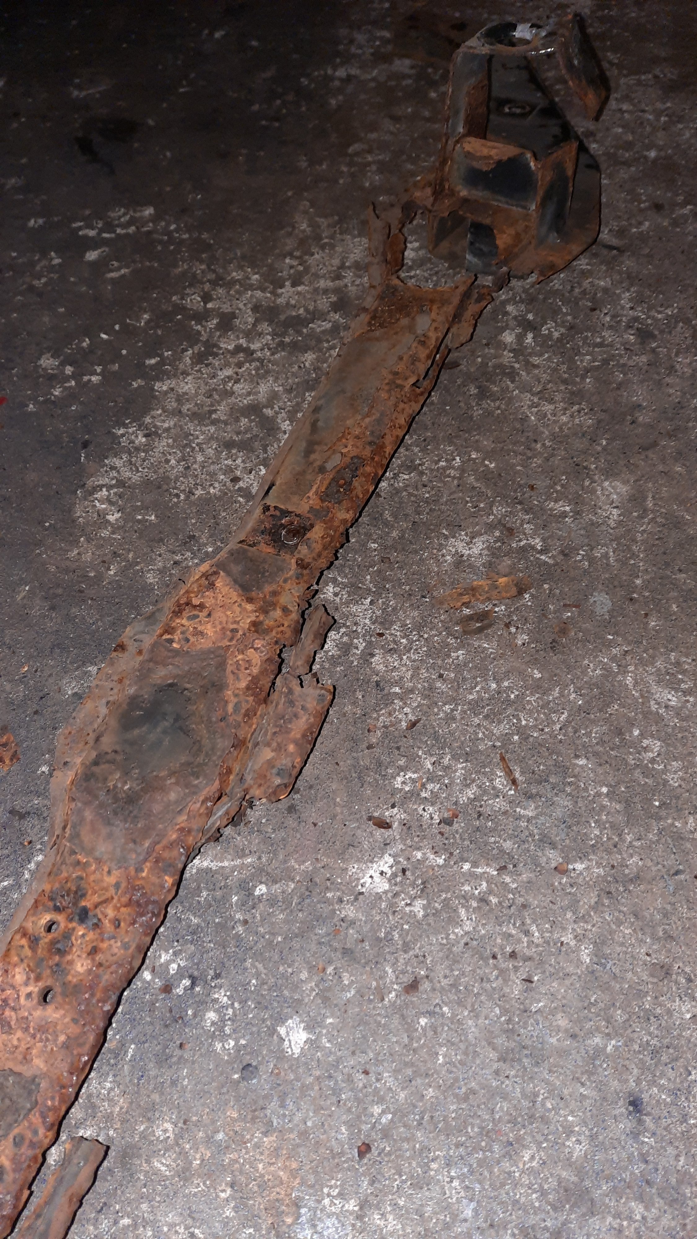

When i first saw my radiator support panel ,I couldn't believe how rusted it was, especially since the rest of the underneath looked so good.
So replacing it was inevitable, especially since i didn't see myself parting with my Doblo any time soon. i thought to take a few pictures and share some information about how i did the job,apolagies for the waffle,it's my first guide.
