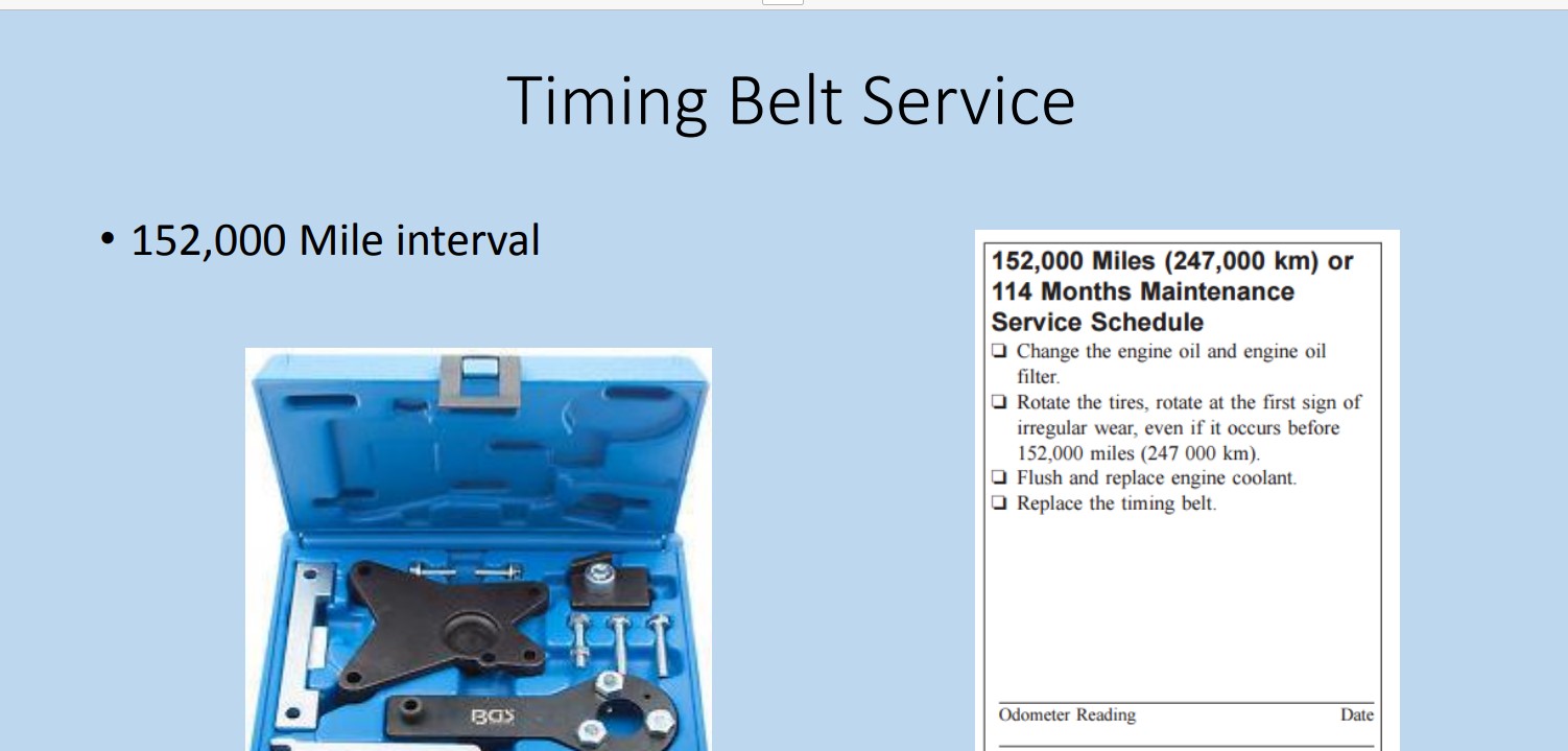

However, we are interested in whether some, or at least one, of the valves could remain open if the belt breaks while the engine is running. Well, if any particular valve was in the part of it's cycle where the solenoid was closed and the cam plunger had pressurized the oil so opening the valve then if the cam stops rotating at that moment the valve must stay open? I presume there will be a certain amount of leak back in the system so the valve, if left like this for long enough, will slowly find it's way back onto it's seat but this will be far too slow to avoid the fast moving piston from contacting it. The repercussions of the valve hammering back on the oil in the multiair unit - which seems to be well known to be a bit "fragile"? - would also be most undesirable too I think. So, all things considered, much better to spend a bit of money on timeously renewing the belt than risk a lot of money if the belt breaks?
