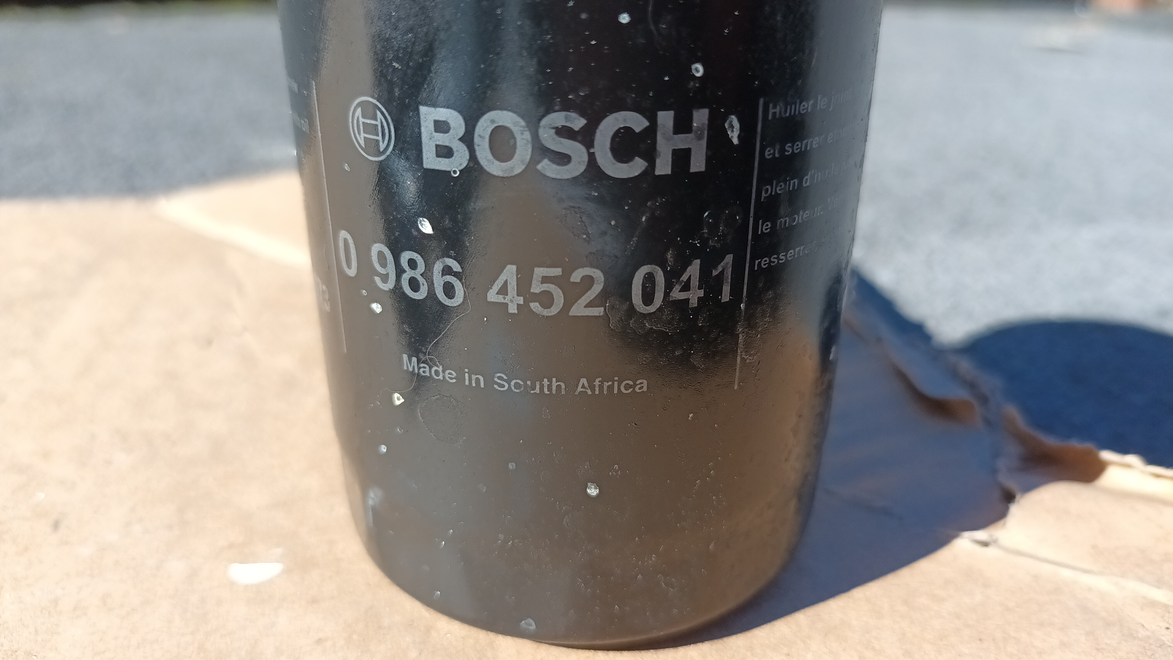

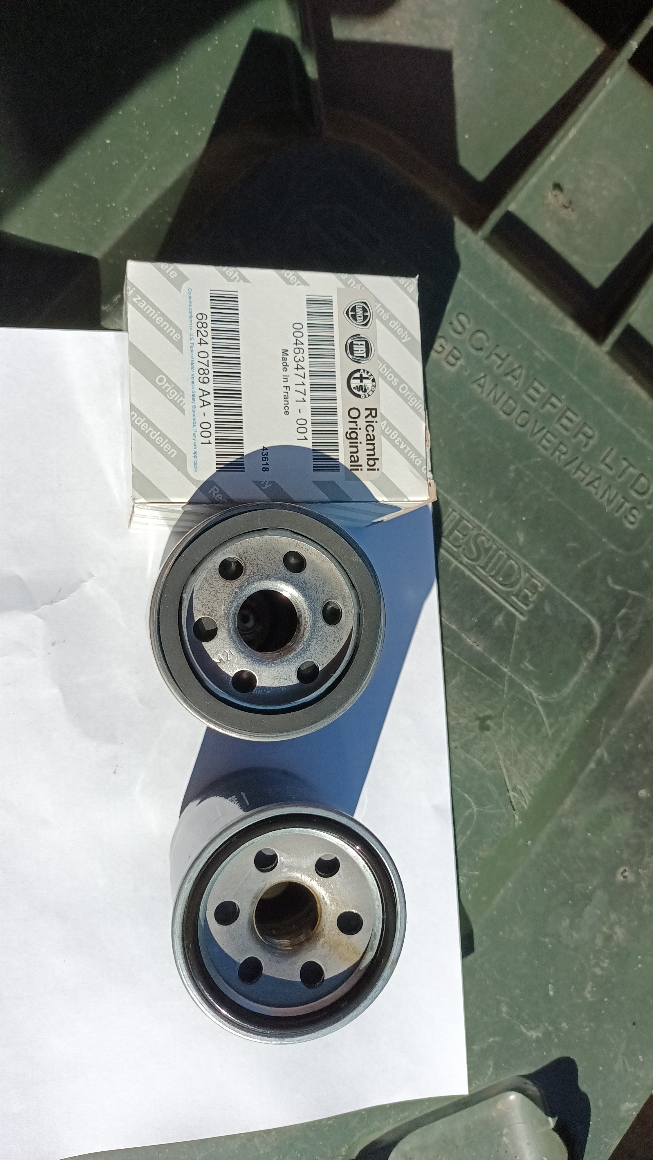

Went to change the oil today in our 2009 1.2, all good except the new oil filter was slightly different in appearance both Bosch, both fit, I couldn't risk it so went to Fiat(only a mile away) for a genuine one, the correct one(on the left in the pic) has the flat wide sealing ring(correct Bosch part number in other pic) the "wrong" one has the round sealing ring and is about 3mm narrower in the body, they may be interchangeable but I don't know?
The Bosch one looks wrong. For a 1.2, I make it you need a 026 407 001?

This is my problem I think(it's in the bin) the one you quote is the one I had with the narrow seal, but the one that came off that's been fine for over a year is the other pic ending 041 and is the same in appearance as the genuine Fiat item so Im still not sure which is correct as they both fit
In practice you can use either; as long as the thread is the same and the seal seats fully against the mating flange on the block (the flange is wide enough to accommodate both types), all will be well. I suppose you could potentially have a problem fitting a larger seal if a smaller one has been fitted and the flange on the block has corroded, but this is unlikely and I've never seen this.
The practical difference is that the total oil capacity is about 100ml greater with the larger filter. The spec changed to the smaller filter over the production run, saving 100ml of oil over the number of cars Fiat produce is what modern day production engineering is about.
Just be aware that the correct functioning of the anti drainback valve is important in protecting the engine during a cold start, so use a decent brand of filter.
