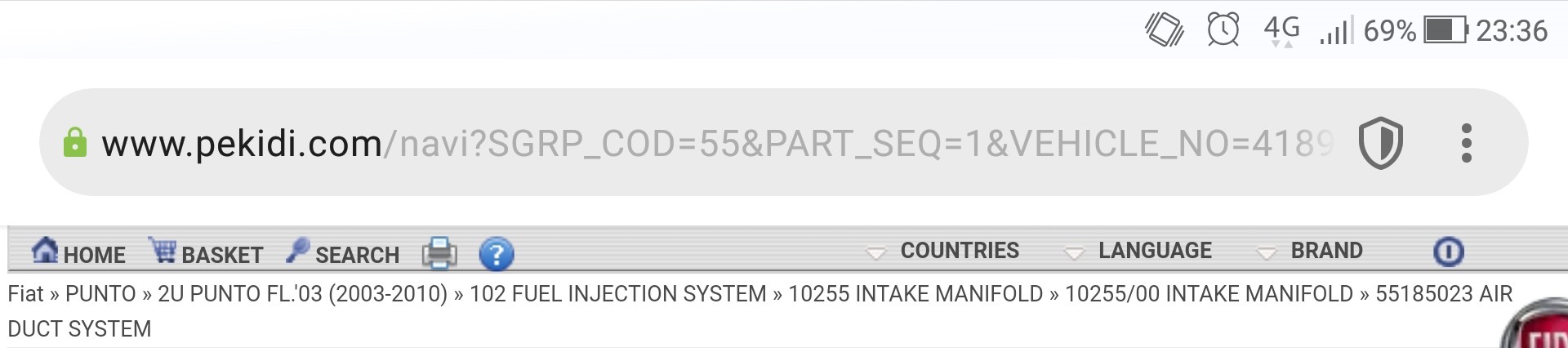

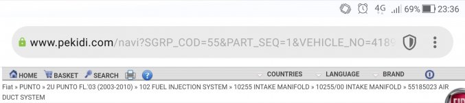

One more question - Where could I find Throttle body and all the sensors within EPER catalogue?? Thanks
hello,
Found the TB according to the tree path from attach (the link is so big..)
