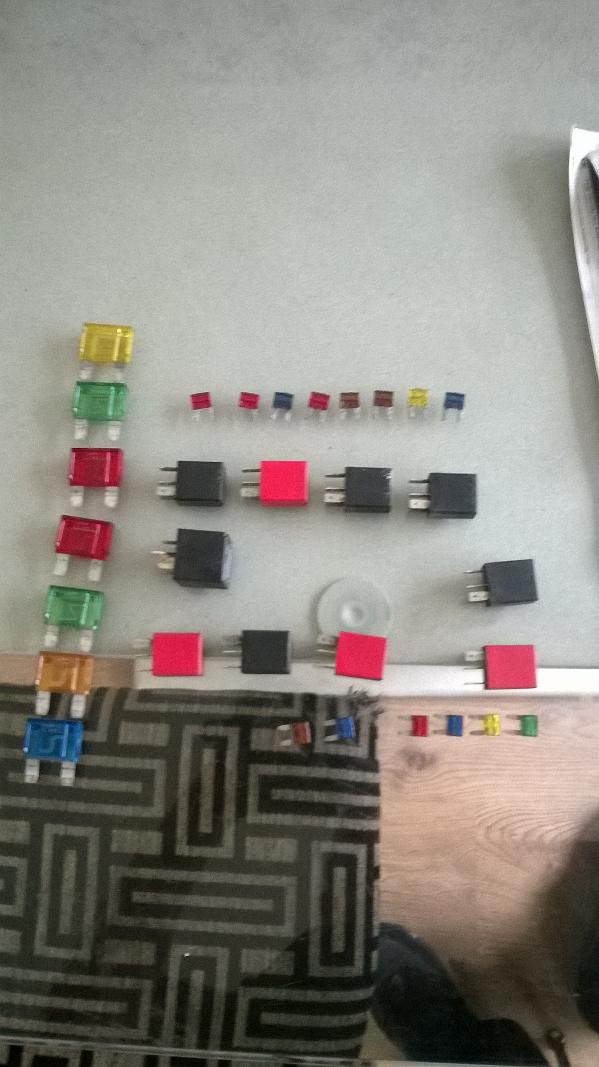

Just make sure you take a pic of the board before removing fuses/relays to help re-fitting and place them in an order on table that makes it easy to remember to re-fit them,,plus as you have had water in the board best to check all fuses as you may have blown one if you had water in the area.
thanks Paul.....I tried cleaning/drying my fuse box out after water got in......using compressed air, hair drier and electronic grade cleaner.....

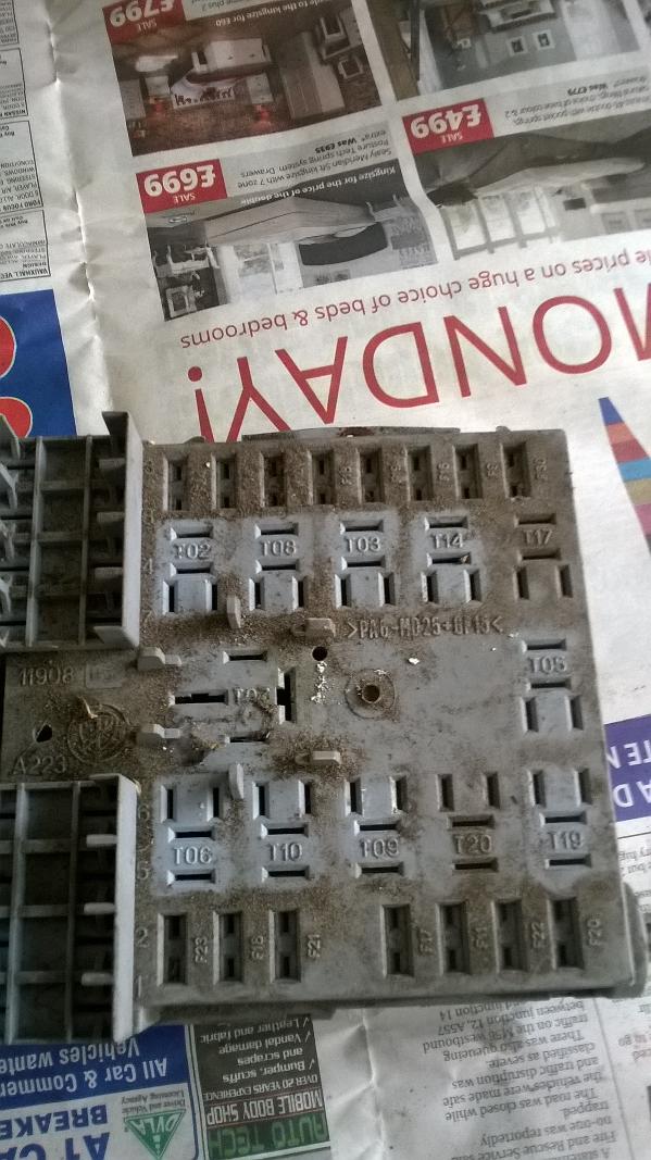

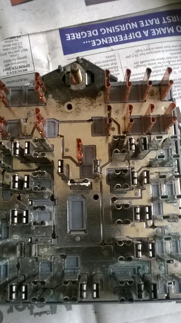

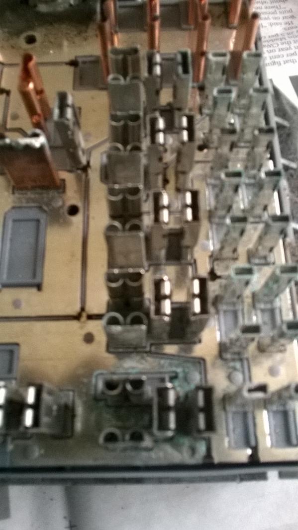

did you take the cards out? theres 4/5 cards/pcb layers.
its all there in the guide a few pics of what swirl done.

Hi just wondering i dont have any electrical cleaner is it ok to use wd40 or wud this do more damage? just finished taking the fuse box apart lots of corrosion as there was no battery/fuse box cover on when i bought the car ggrrrr,
Any advice wud b apreciated guys
Thanks
Joanne

Hi paul no i meant the original wd40 lol i didnt use it tho i just got my dremmel out with a light sanding tool, however my car still wont start so i went to change the spark plugs but low n behold the blinkin 14mm socket aint deep enough so after raiding a few friends tools im no further forward:bang: tool shopping on the cards now 2mw. I will get this car running again lol already unseized my calliper and replaced my radiator so half way there. (y)
