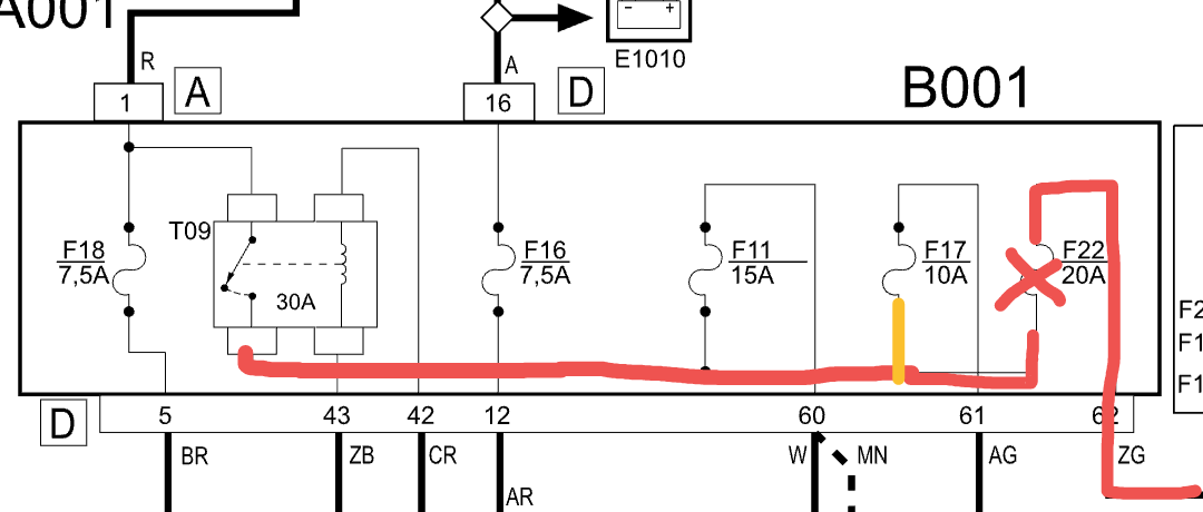

Oook and is there a relay that sends the power to the fuse? Or is it powered directly?
I tried understanding your diagram but i didn't understand the wire coming from the right what does it bring/send power to/from
Right
We have power along this wire I have coloured red
But high resistance along this bit I have coloured yellow
As long as the diagrams are close enough
And we are measuring it right
And I haven't made a mistake

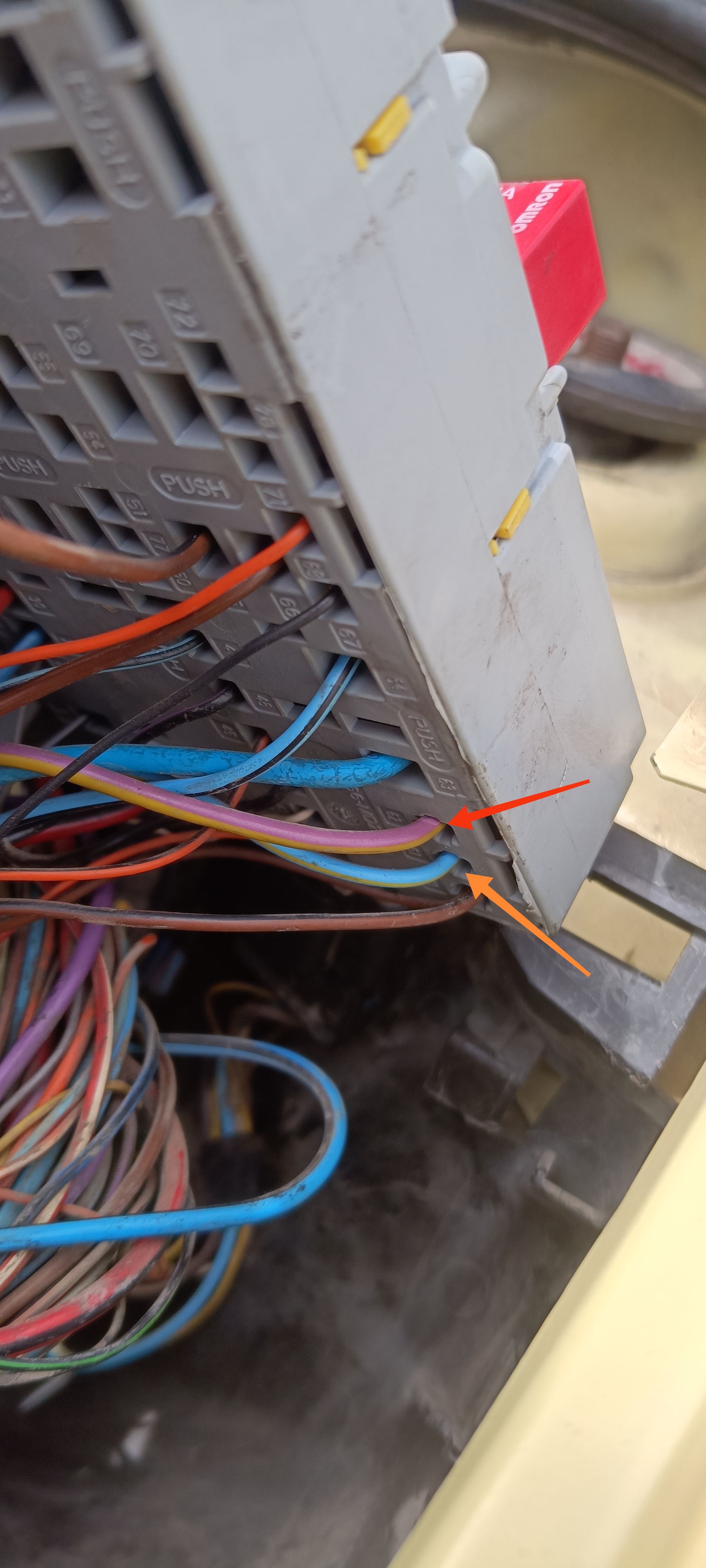

Red is for the fuel pump and the orange is the middle one for what I'm guessing is the coils
