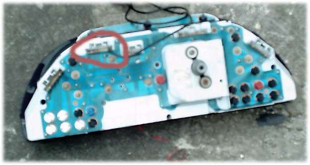

Hi TS86,
In the MK2 its 2 Alan key bolts to remove the pod.
Pull clocks forward and unplug the 4 electrical plugs and the Speedo cable – noting plug positions.
You will need to add only 1 wire to the coil’s Green wire. I used the N/S one.
I soldered the wire onto the pod’s circuit board. Then ran the wire the same rote as the Speedo cable to the engine bay, and clipped on to the coil's wire with a blue squash clip thingy.
Refit the 4 plugs and the Speedo cable, replace the 2 Bolts and your done.
The thing I took longest over was cleaning the newer dials and matching the mileage to the car.
Good Luck and just ask if you need more help.

Sorry fellow – I didn’t check the voltage – I presume it will be an AC of fast changing DC signal, which will be too fast for a standard voltmeter. TBH after Chas checked his non IE 999 Uno at 1 AM for us and told me it was the green wire (Carb coil with spade connectors) I guessed it was the same for plug conector coil. – Lucky this was correct :eek:

BTW the Perspex screen on the SX clock was scratched, so I drilled a hole for the Odometer reset in the Base screen.
Check all the bulbs work before you screw in – nick spares from the base clocks ;)

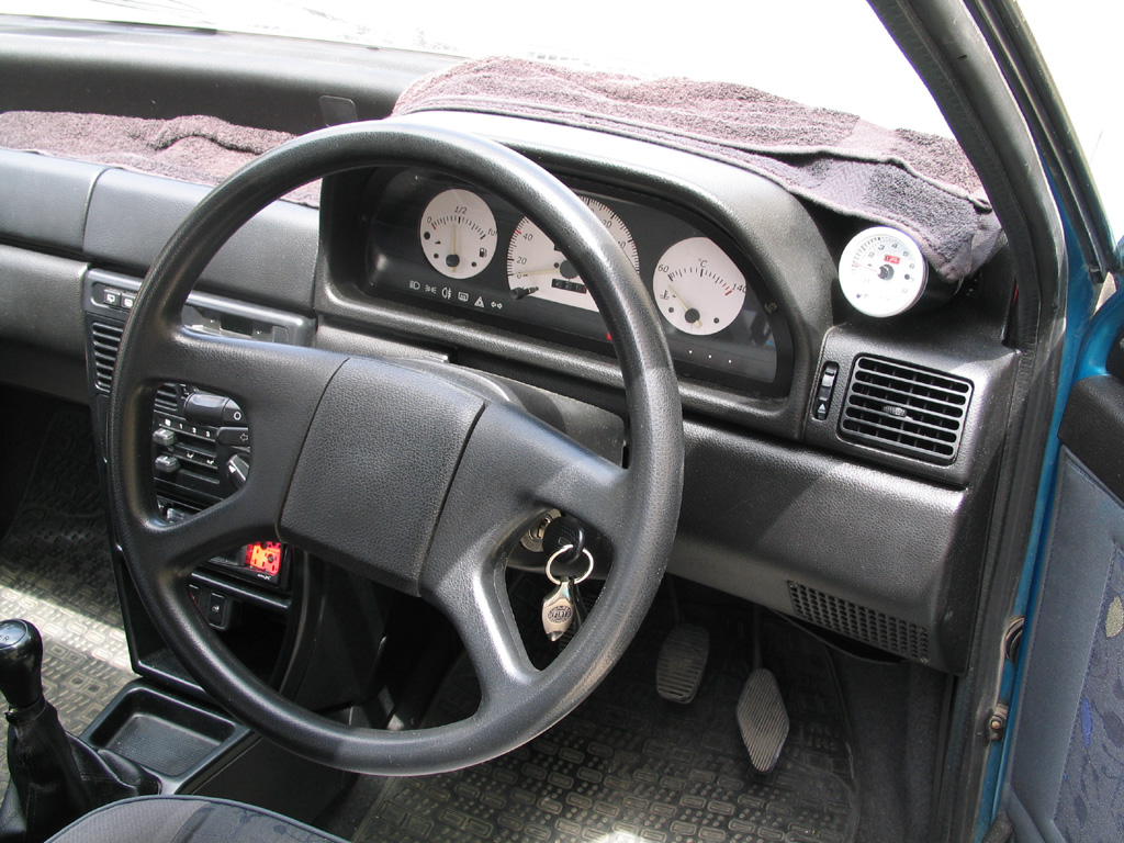

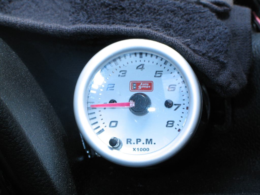

Well I finally got round to fixing my rev-counter! I bought an autoguage rev-counter!! It works just fine with just the right amount of damping!! With my typical driving style I rarely go over 3000rpm and max I have got it to is 5500rpm. Compared to my dad's Pug 206 the car does not seem to be free revving. At 3000rpm it sounds harsh whereas my dad's 206 can hardly be heard. I know what ur thinking...that the 206 is more modern....(mine is 97 model) but I think it sounds too harsh for 3000rpm! I'll take a vid one time and if someone is interested in hosting it for me I will send it to him!!
Please tell me what you think of what I have done. Thanks

It's cool looking dude (y) i Have the same dials prepared to put them in. well .. i modified them a little :)
Well I am from malta and I got it from my local auto shop. It costs me a total of 50Euro. That includes the rev counter and the holder/cup! Glad u like it...I still have yet to sort the colour changing switch!! Will take some pics at night to show u how it lights
What engine do you have..?? Because i fitted mine with a SX dashboard (revcounter/km/etc..) for 10 euro on the junkyard here..
I can rev up to my redline: 6600RPM +/-.. couple a times touched the 7.000RPM.. So i think you rev meter isn't correct..??
