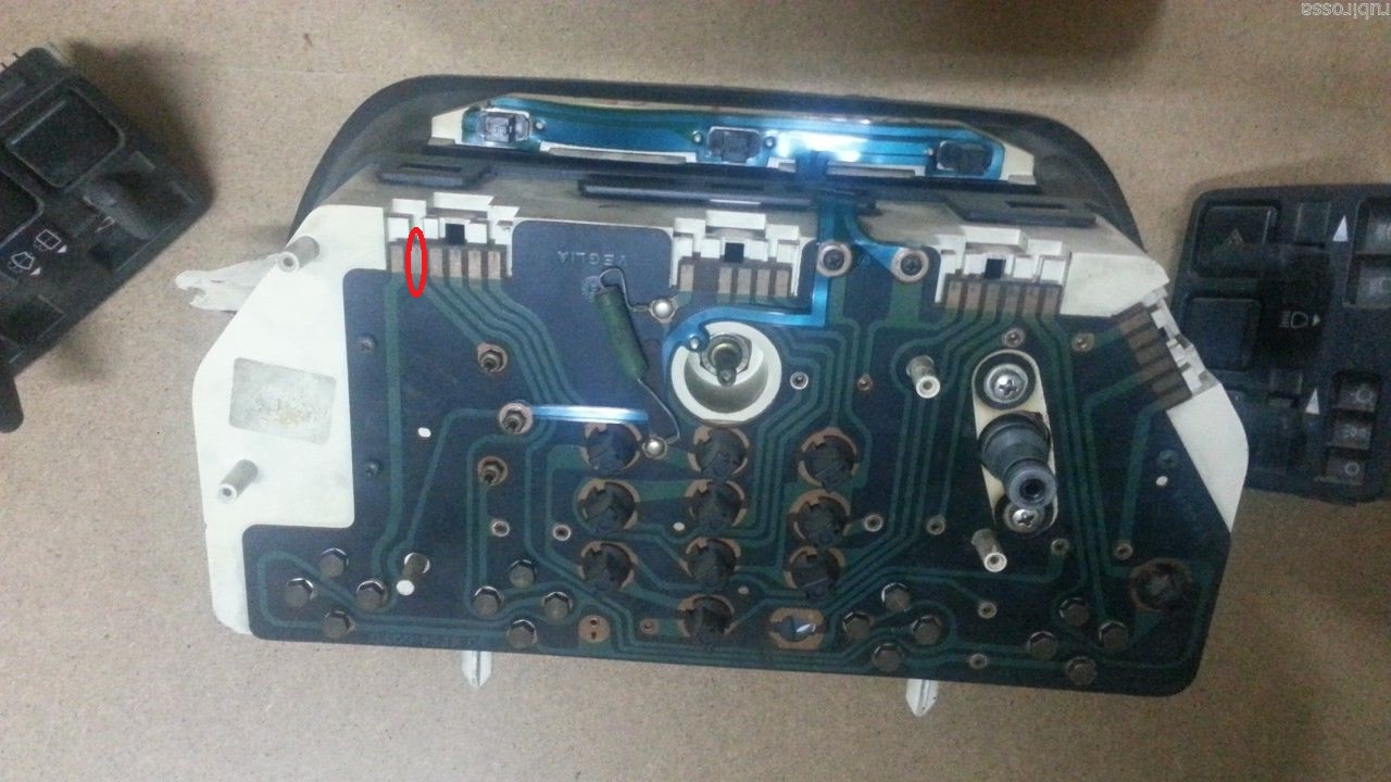

Ok I got the rev working by connecting it to this pin.
I still can't find a reason why it won't light up :confused:

Sure you've checked the obvious... the little (T5?) bulbs themselves.
Check the resistance between the strip where the bulbs are and the main circuit board.
I've seen these go open circuit as they are a bit flimzey :)
Think I could see the break without having to test resistance. Quite simple to jumper the gap.
