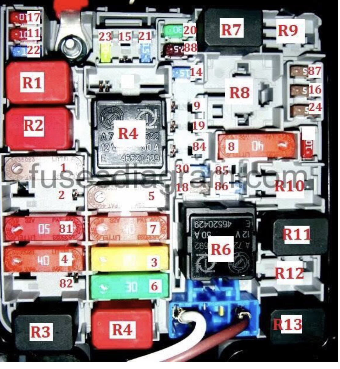

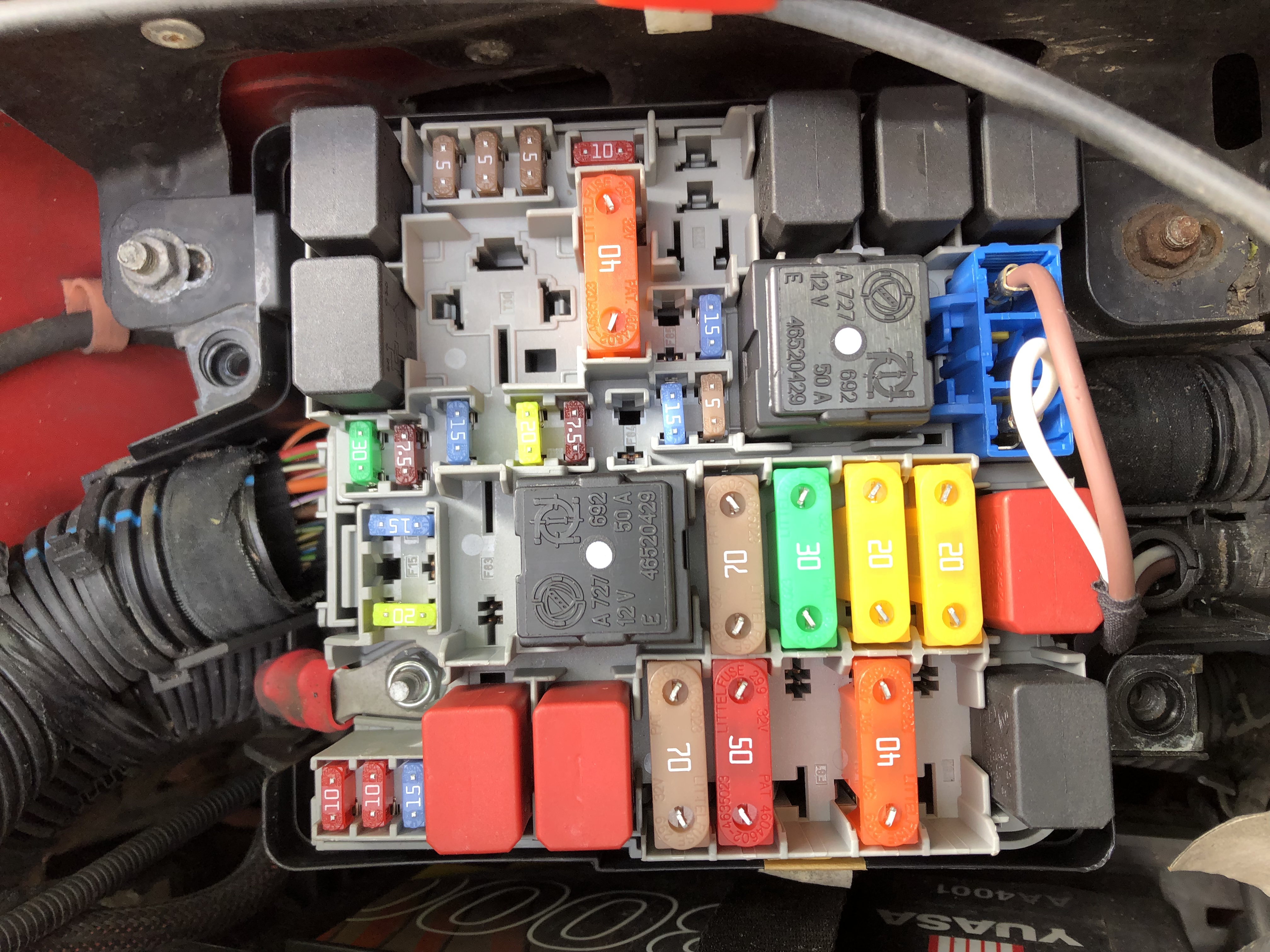

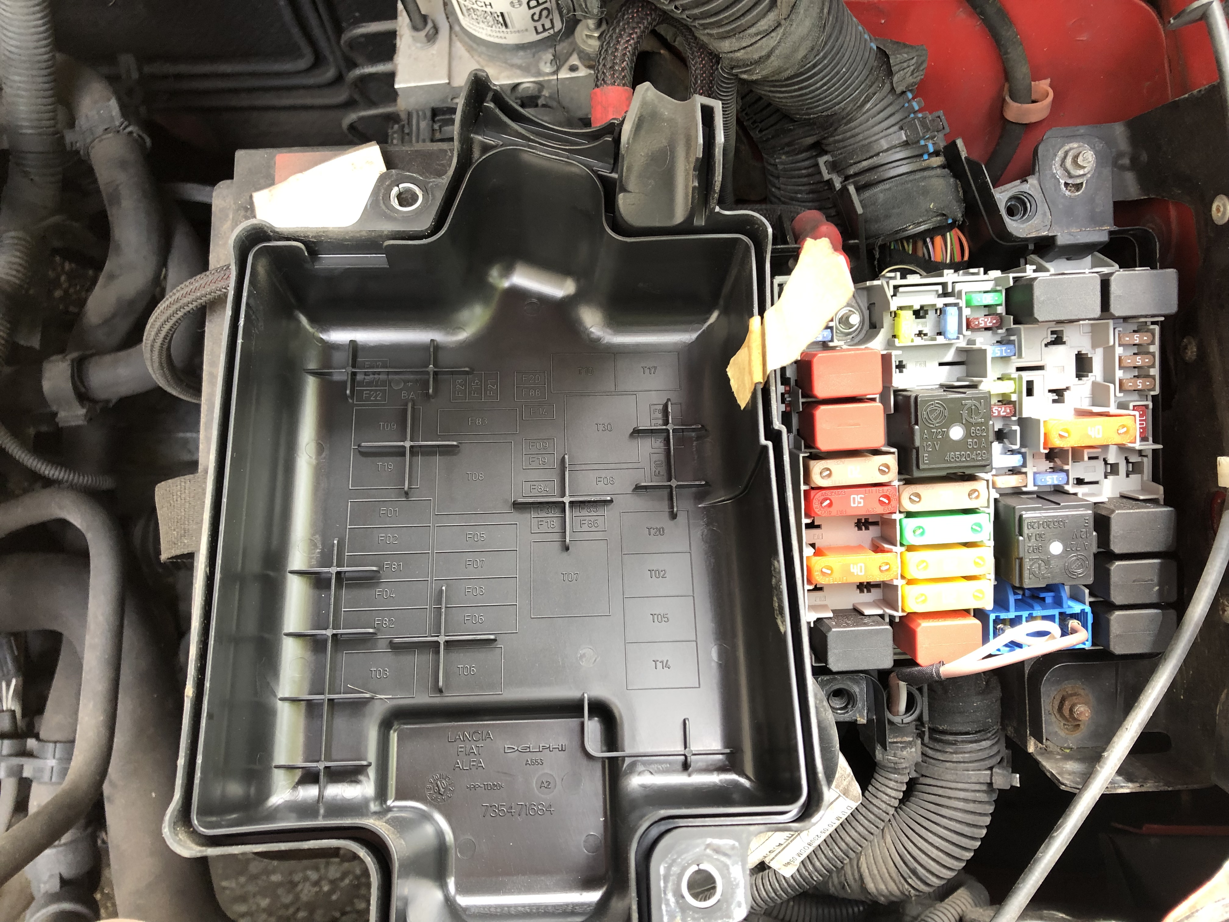

Hi I have just bought a grande 1.4 16v eleganza 2009 and the lights stay on and the stork doesn’t do anything I have been told by the previous owner that he had it diagnosed as a relay, he spent 2k on it in 2018 and didn’t bother to fix and the dodgy dealer didn’t mention it. I suspect it is the stork (ouch) by is there any chance it could be a relay if so which one? I have taken some pictures and found a diagram online, any help or thoughts appreciated

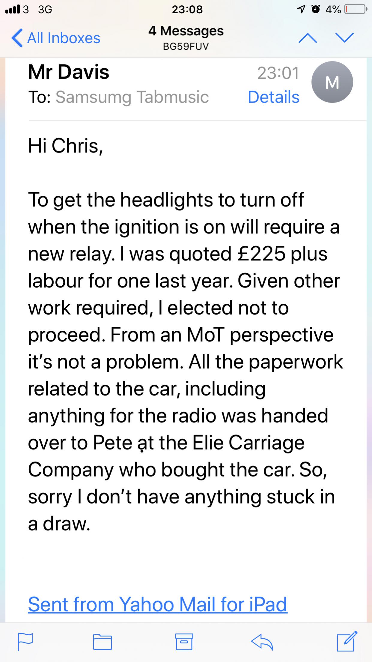

Here’s the previous owners exact words

I've looked at the schematics and this problem, as described, cannot be a simple relay issue. The fault is one of these, in order of probability
1/ Faulty stalk switch
2/ Faulty Body computer
3/ Wiring fault or bodged wiring to bypass faulty body computer.
Multiecuscan will tell quickly which it is. Sounds like your repair capability is pretty basic, do you have a multimeter?
