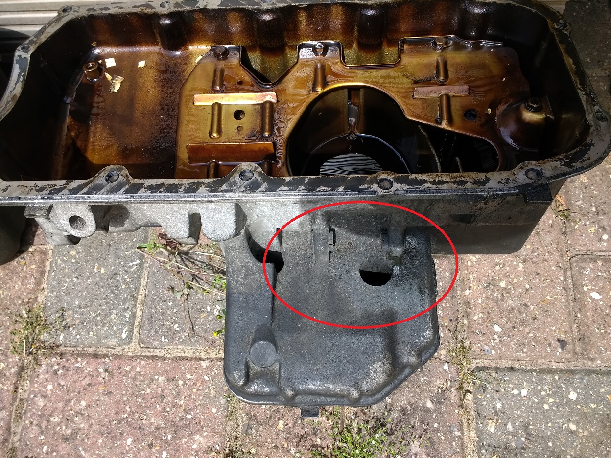

I've now replaced my sump, all in all not a particularly difficult job, but there are a couple of points that are worth checking before you start work...
With many thanks to Dave-M for the supply of a replacement sump and helpful advice.
I'll put together a guide in due course, but here's a rough idea of what's involved, its pretty obvious when you are under the car.
  • The sump is held on with a mix of Torx T50 and T40 screws (the 4 T40s are at the gearbox end and the crank pulley end), some are easy to reach with a standard tool, but some are deep though holes. It is worth checking you can positively reach all the heads before starting work, the tool doesn't just need to be long, but slender also. A couple of 200mm drivers from ebay are invaluable.
  • There's also a couple of 13mm bolts attaching the sump to the gearbox housing
  • The only part that needs removing first is the exhaust downpipe, and the sump bracket that passes under the exhaust. There's enough flex in the down pipe to move it out of the way, and support it on something

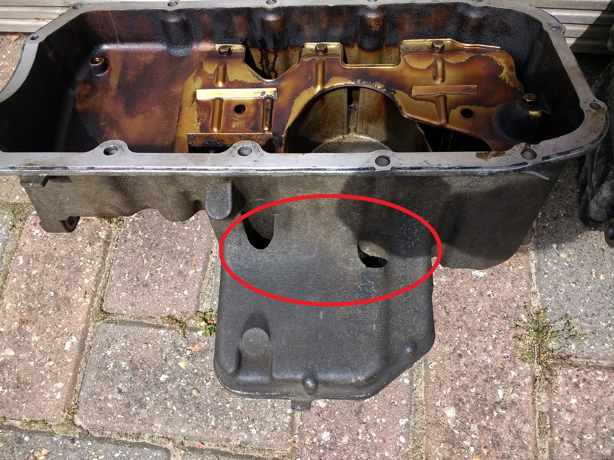

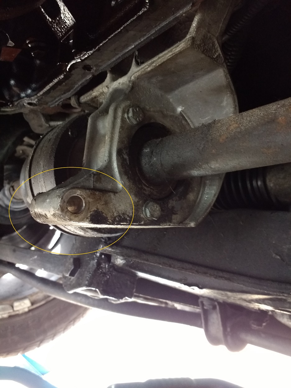

  • Depending on your car there may be a support bracket between the drive shaft bearing housing and the sump. Ideally, you need the sump that matches your car. The sump on my car and the one Dave supplied me were different in this respect. Mine (1999) has the Bracket holes, the replacement (older) didn't. This isn't immediately obvious when you look under the car, you need to put your hands around the extension at the rear of the sump and feel for the 13mm bolt head and nut running inline with the drive shaft. (it took me ages to realise why my sump wouldn't come off ).
  • There seems to be a few part numbers for sumps, the one with the bracket on my car was 60604406, and without the bracket 60604851. I think the sump which is configured for the bracket will fit on either car type, but the non-bracket sump will not fit on the bracket car type as is. I had to cut off the bracket from the bearing housing to stop it interfering. So ideally make sure you've got the right sump, but there are work arounds.

Oh, and in case you were wondering, my old sump had a small damage crack which had been patched.
