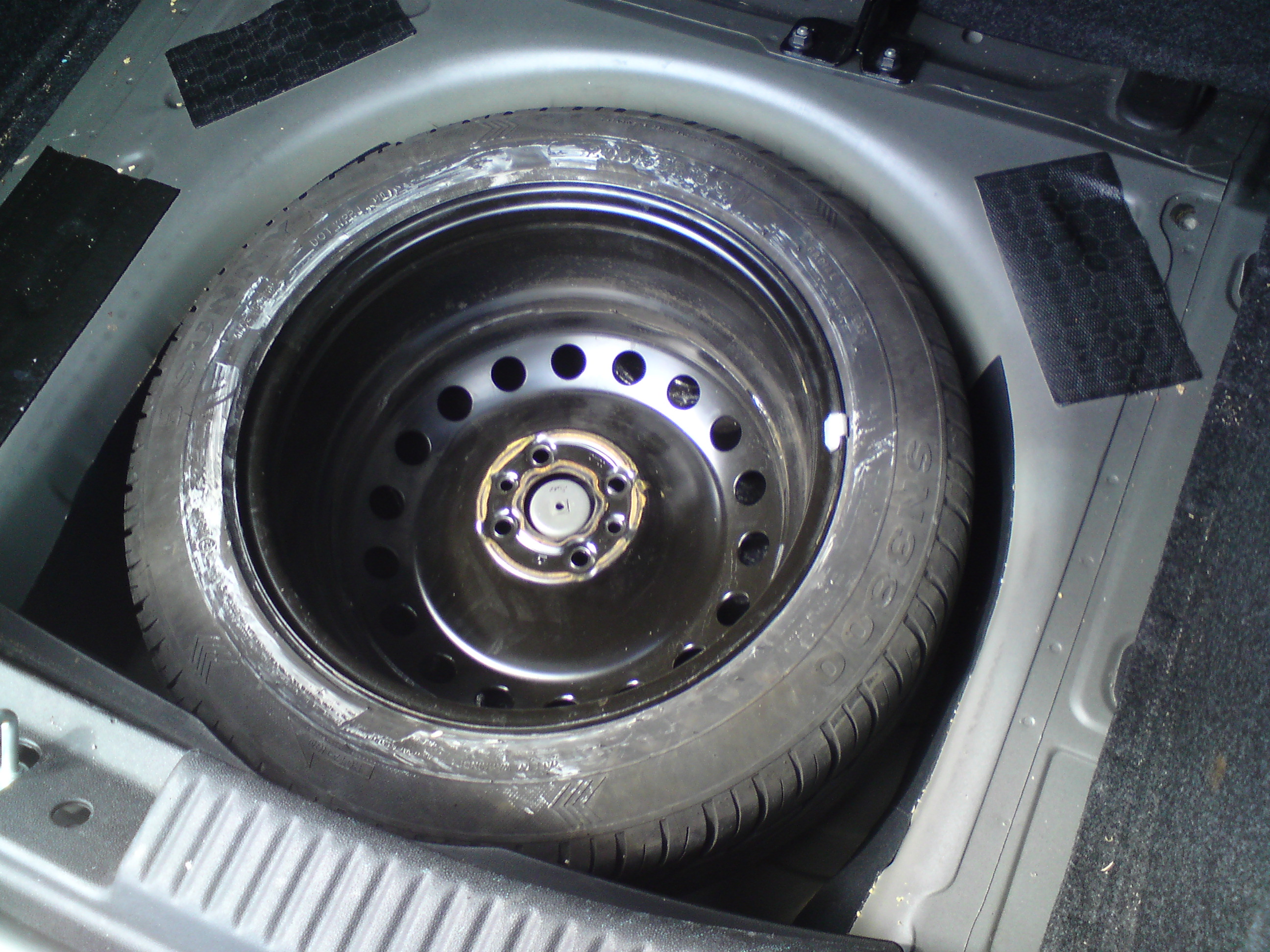

With a little careful movement you should now be able to remove the foam insert from the wheel well. Once it's out you'll be left with this!
Re-fitting
Now drop your spare wheel into the well. It fits outside down leaving a cavernous space to fit all the tools into.
Push the boot lid protection back over the luggage hooks and ensure the rubber seals are all in the correct places. Put the three screws back in - they don't need to be super tight.
The top of the tool tray forms the support for the boot floor so make sure you have one to fit. Place the boot floor back in and tighten the two luggage strap hooks back down using the hex key.
I managed to fit in all the bits and bobs I had under the floor around and inside the wheel, the only part which now needs a new home is the fix n go kit
