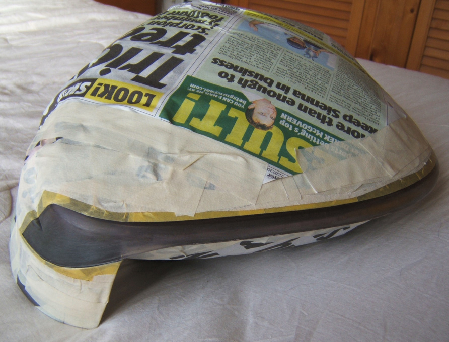

You can see how I masked the line around the cluster. Under the clear you can see a defined edge I just followed the outside of that edge. Rough up the area to be painted.
![mask-01.jpg mask-01.jpg](https://cdn.fiatforum.com/data/attachments/55/55310-628d3a0c522c7cd1cc7c4e5efbce44f2.jpg)
![mask-02.jpg mask-02.jpg](https://cdn.fiatforum.com/data/attachments/55/55319-ef7e0cb61ebffb6d7336e062a7cec1c1.jpg)
I used an direct to acrylic satin black followed by lacquer.
