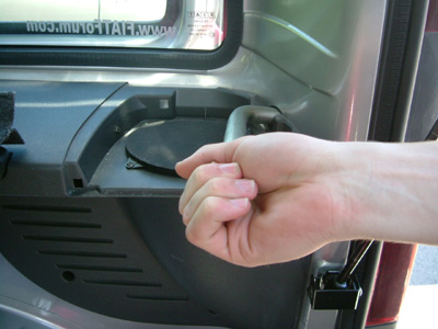

Slide the speaker cover out - DO NOT try to pull it up or pull the edges you will break the clip - the whole unit should clip out together.
