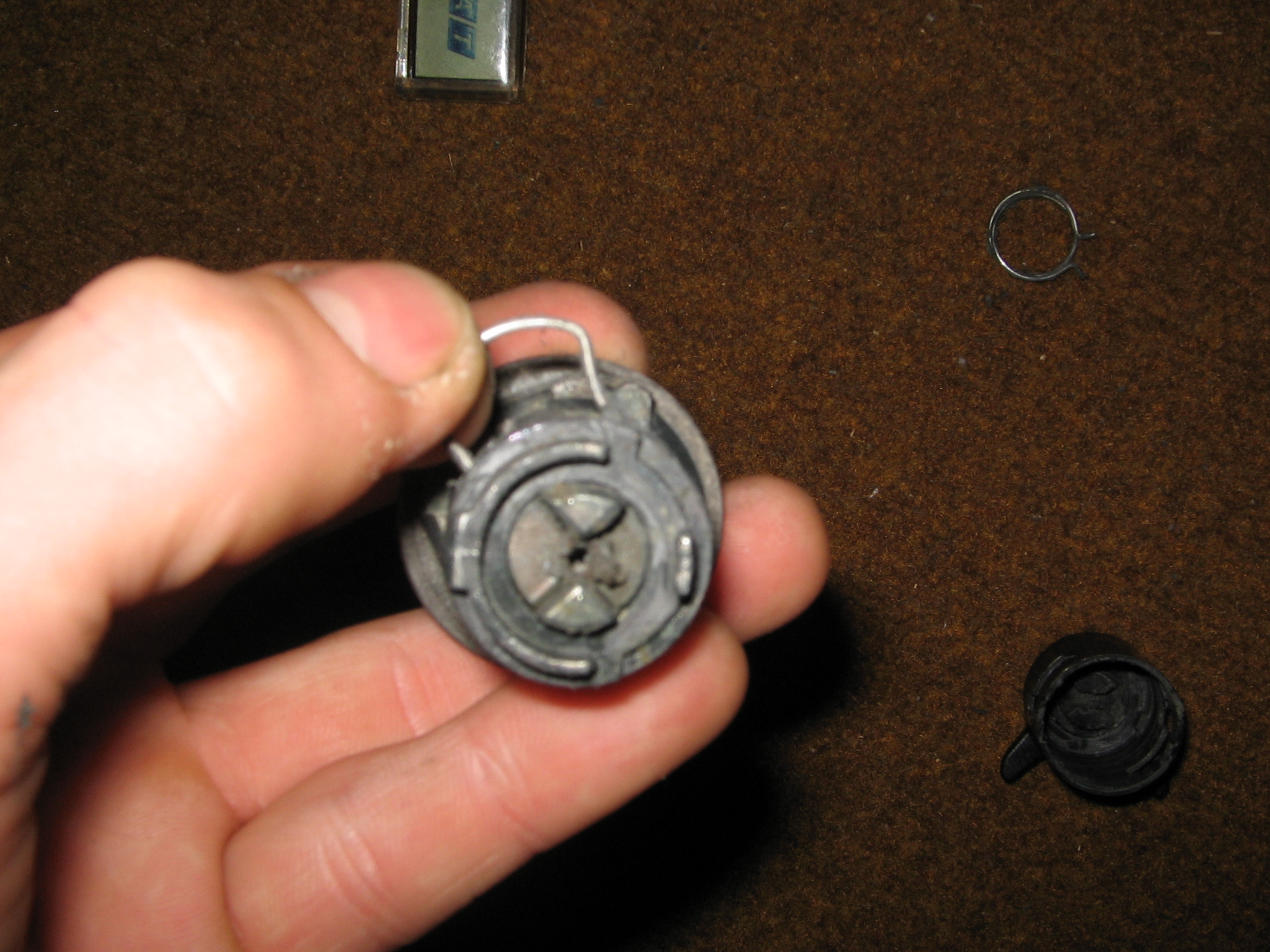

you then need to remove the centring spring this brings the lock to centre when the key is released
take note of the way both legs of the spring are crossed then hooked either side of the metal peg so you can put it back right

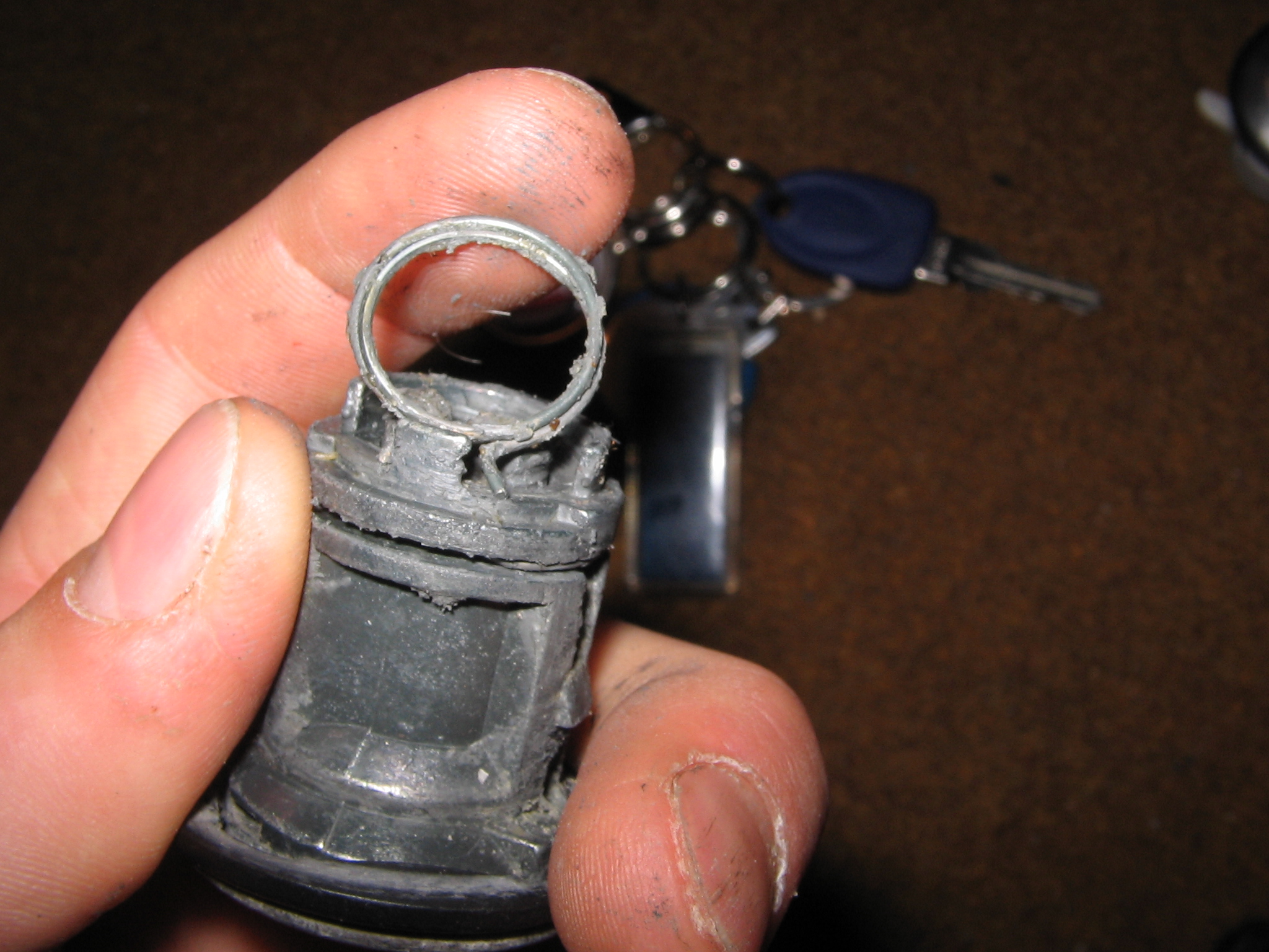

then flick out the c clip holding in the lock barrel

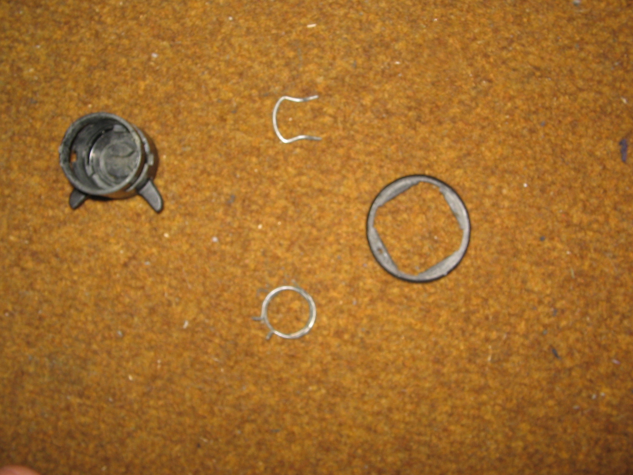

you should have a load of bits like this now
the large plastic ring is the outer trim of the lock I just took it well actually it kind of fell off
you should now be able to push the lock barrel out of your damaged lock
