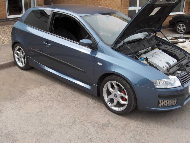

Please note the side skirts on Mikes car come from the Brio catalogue & are the same type as the Schumacher edition. The fixings on genuine abarth skirts are 10mm self tapping bolts.

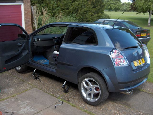

Jacking the car up
First steps

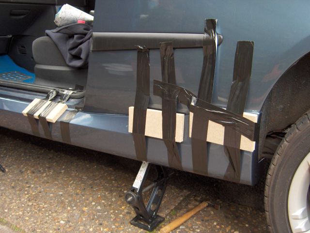

Offer the skirt up once more & tap the clips onto the sill to hold the skirt fast.
Press the top of the skirt to the car body whilst checking the gap below the door.
Once you have made sure that the door will clear the skirt easily affix the small blocks of wood using heavyduty duct tape in a position where the tape pulls the skirt in to the car body. Wipe off excess bonding sealant with a panel wipe or thinners(if using thinners have a spare cloth to hand as you'll need to wipe off the thinners immediately) & leave to set. Depending on which sealant you use this can take between 3-12 hours.
