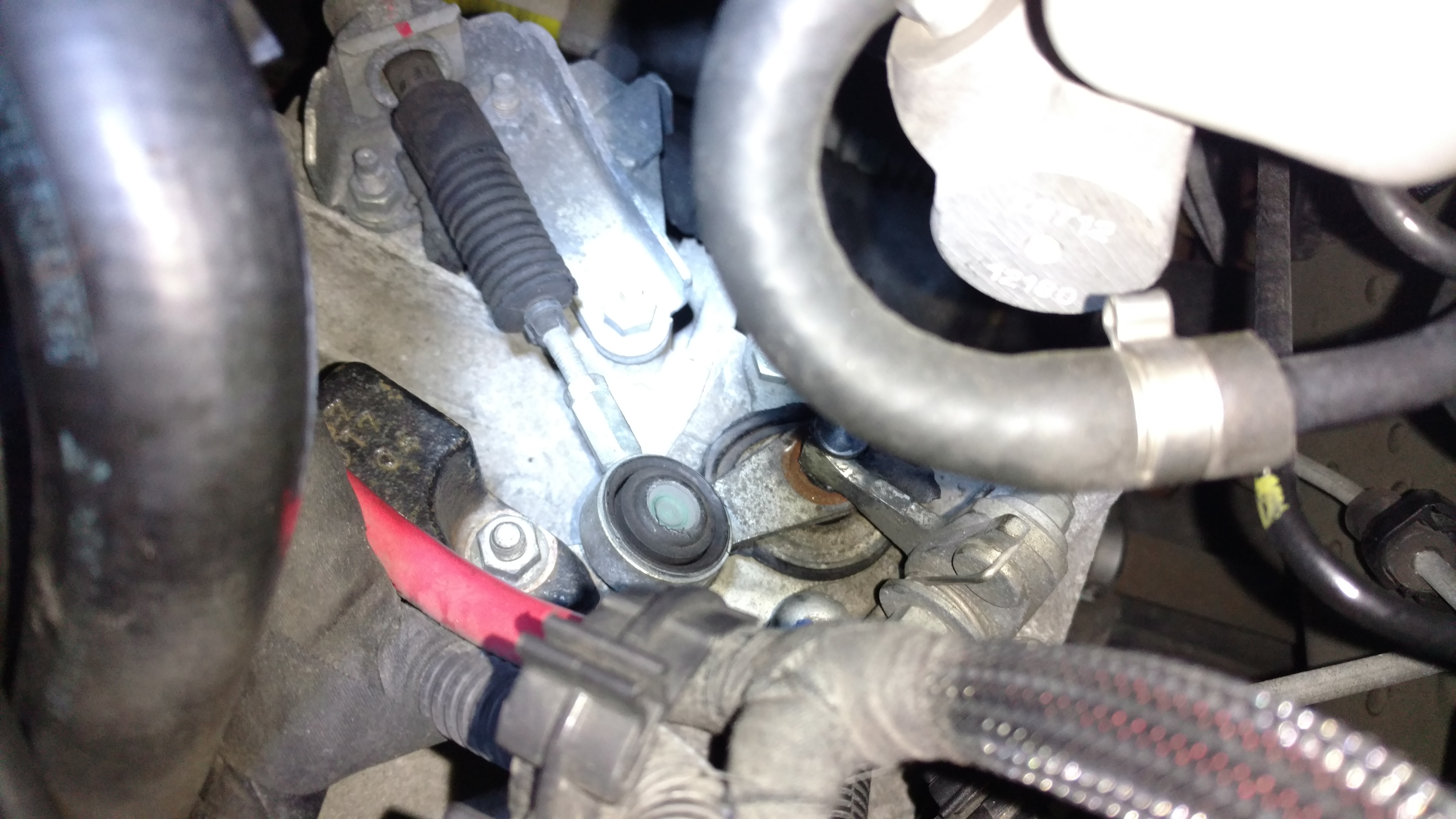

So, firstly you will need to find the current shifter linkage which will be somewhere on top of the gearbox. On my car, it is pretty much directly below the brake fluid reservoir. There is a handy gap to reach down there to change what you need to.
![IMG_20151216_181342222[1].jpg IMG_20151216_181342222[1].jpg](https://cdn.fiatforum.com/data/attachments/131/131735-32247b2f4d44f185713ecc47f7bc1df2.jpg)

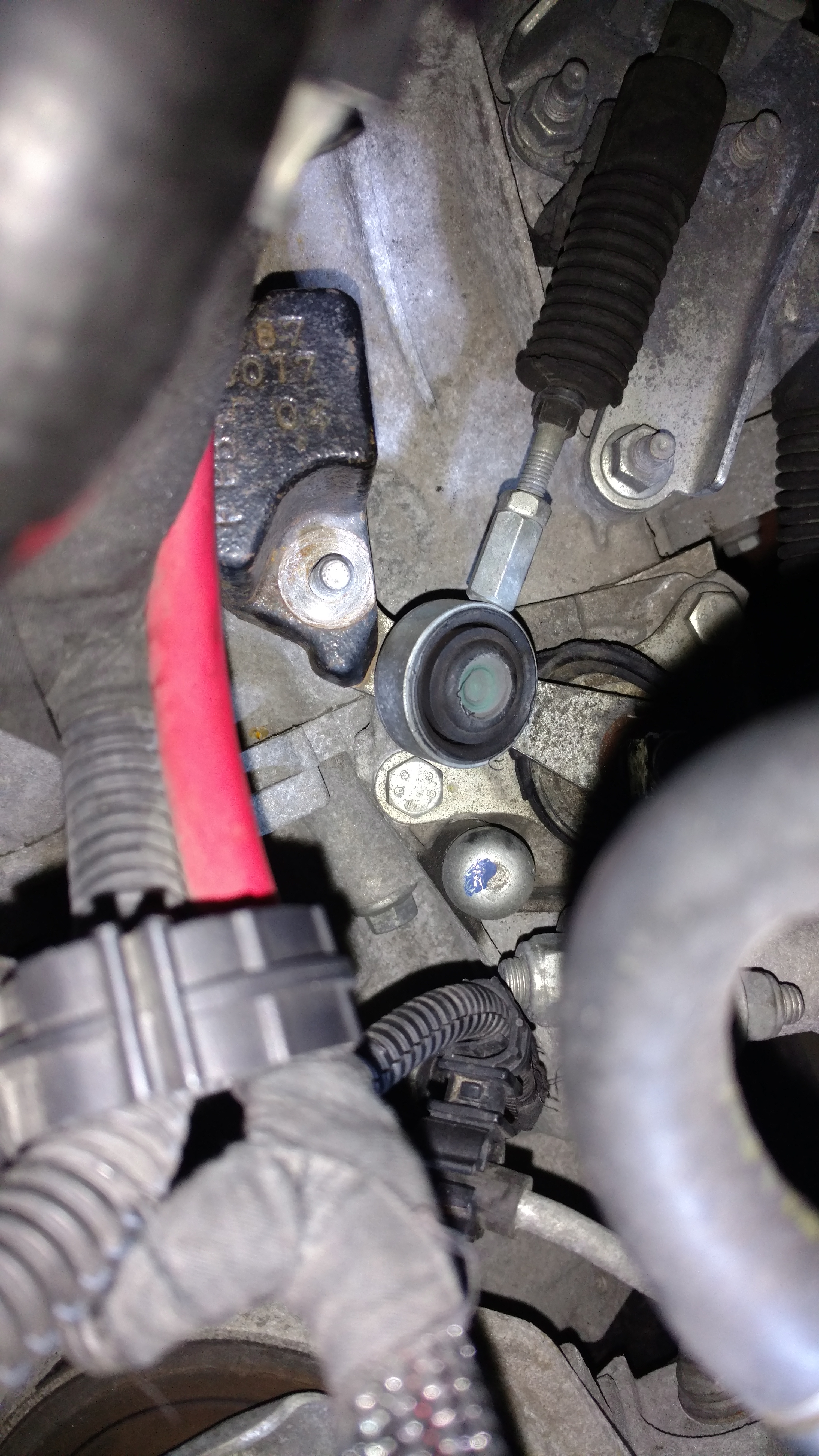

Use your 13mm socket to undo the nut you should see by the black weight off to the left of the linkages. Once undone you should be able to lift the weight off the "bolt" that it is slotted over. Doing this first will allow you more access for the next step.
![IMG_20151216_181949763[1].jpg IMG_20151216_181949763[1].jpg](https://cdn.fiatforum.com/data/attachments/131/131812-3629fb5868f939e147f47b5f22226e91.jpg)
Next, you need to use something to pry the linkage which comes from the firewall/bulkhead upwards. In my picture above the linkage is the object with the green centre, yours may not be exactly the same. In my case, I ended up using a set of locking pliers to grip onto it and pulled up and toward the firewall. The link didn't pop off and didn't move a lot when it came off, so be careful not to pull on the linkage to much in case you cause damage to it.
