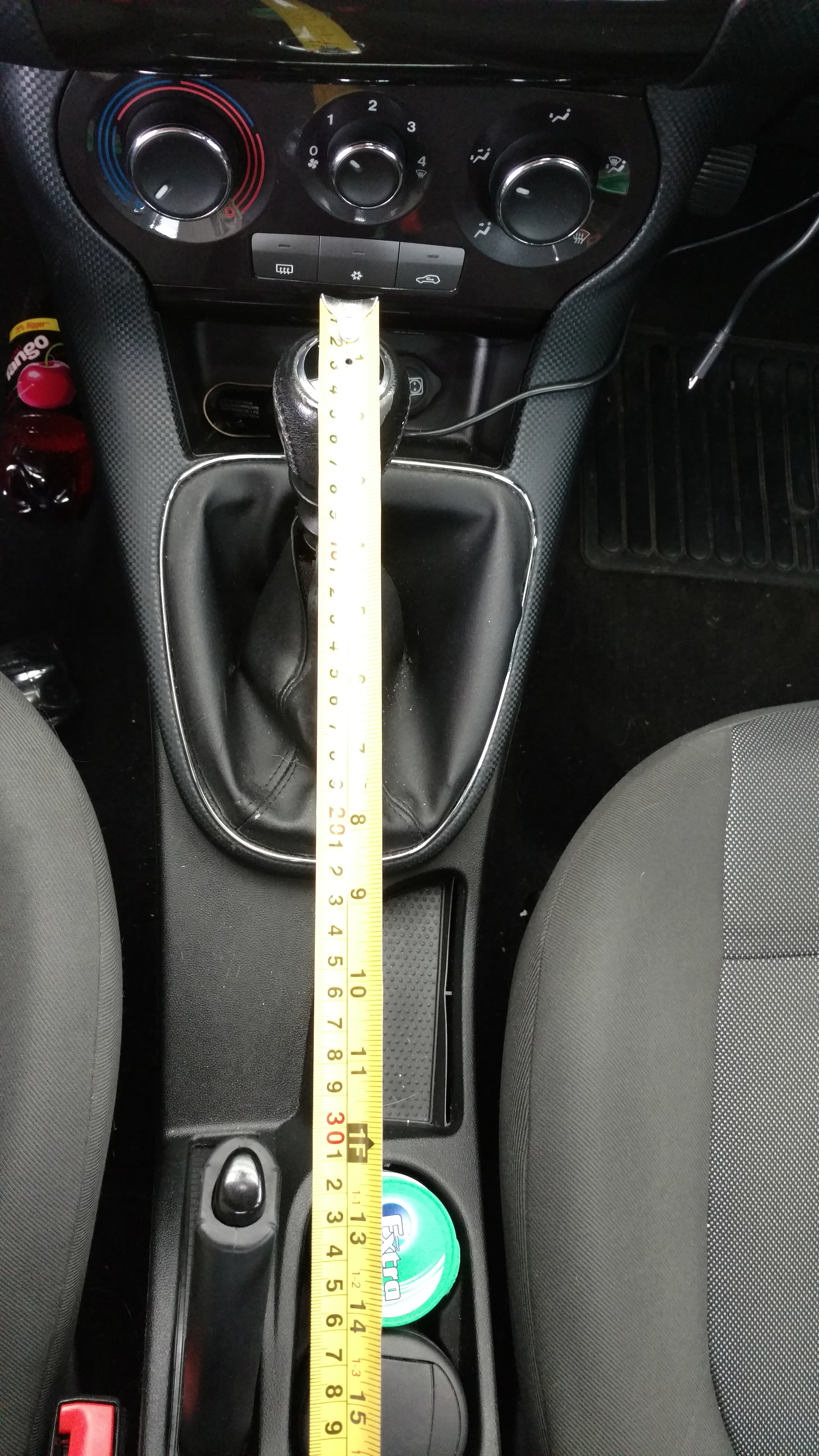

Just to show you the reduction I lined up the furthest point of my gearknob with the 0cm mark on a tape measure whilst in first gear. Then went into 2nd. I did this before and after fitting. Hopefully the images will show the difference!
Before
The throw is ~14.5cm.
After
The throw is now ~9.5cm - 10cm.
