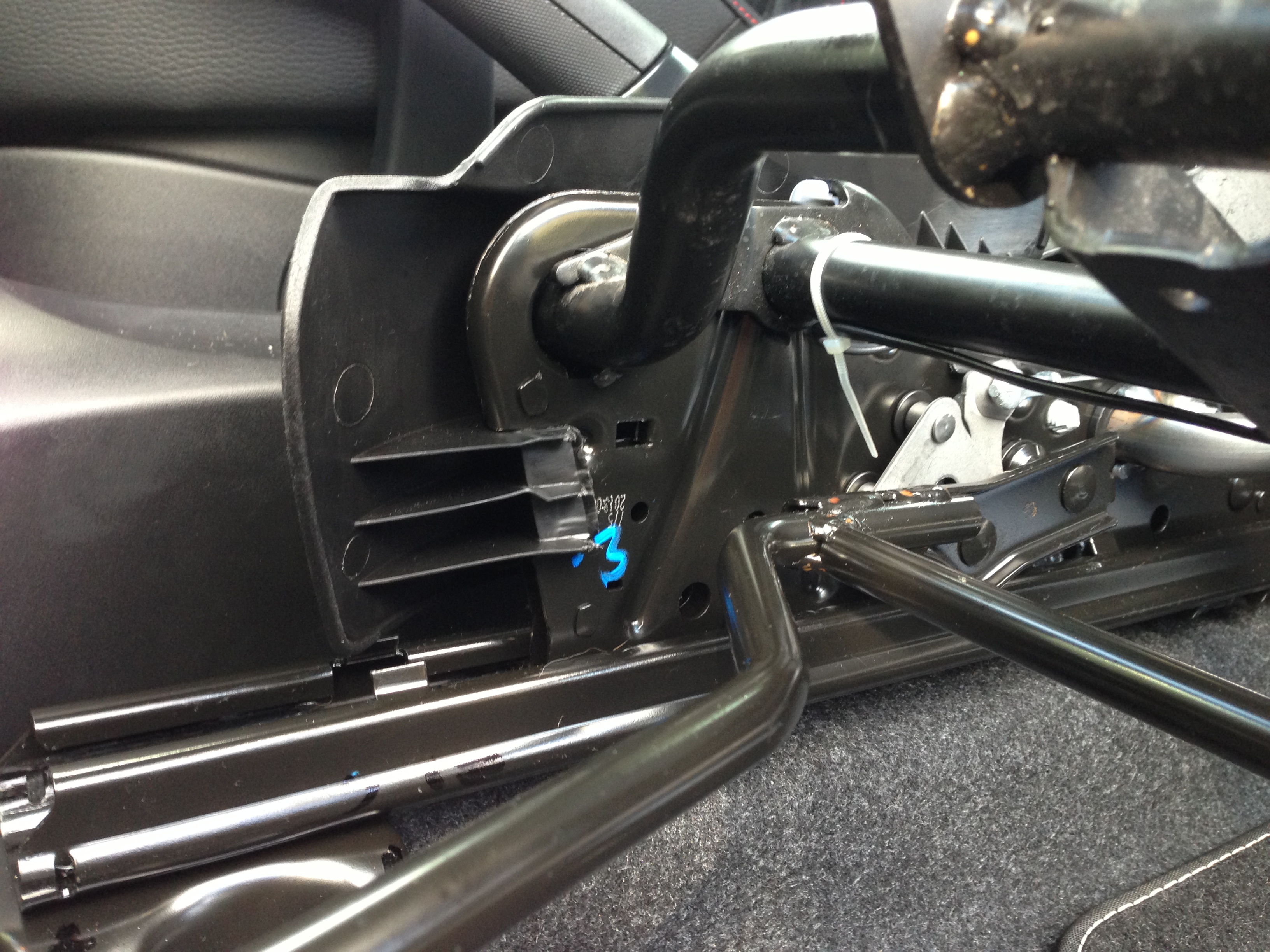

6: Now you need to unclip side trims. You need to use a bit of force and manipulation to unclip them. (you do not need to remove the full trim from seat)
This is what you need to unclip
And this bit make sure it moves once front bit free.

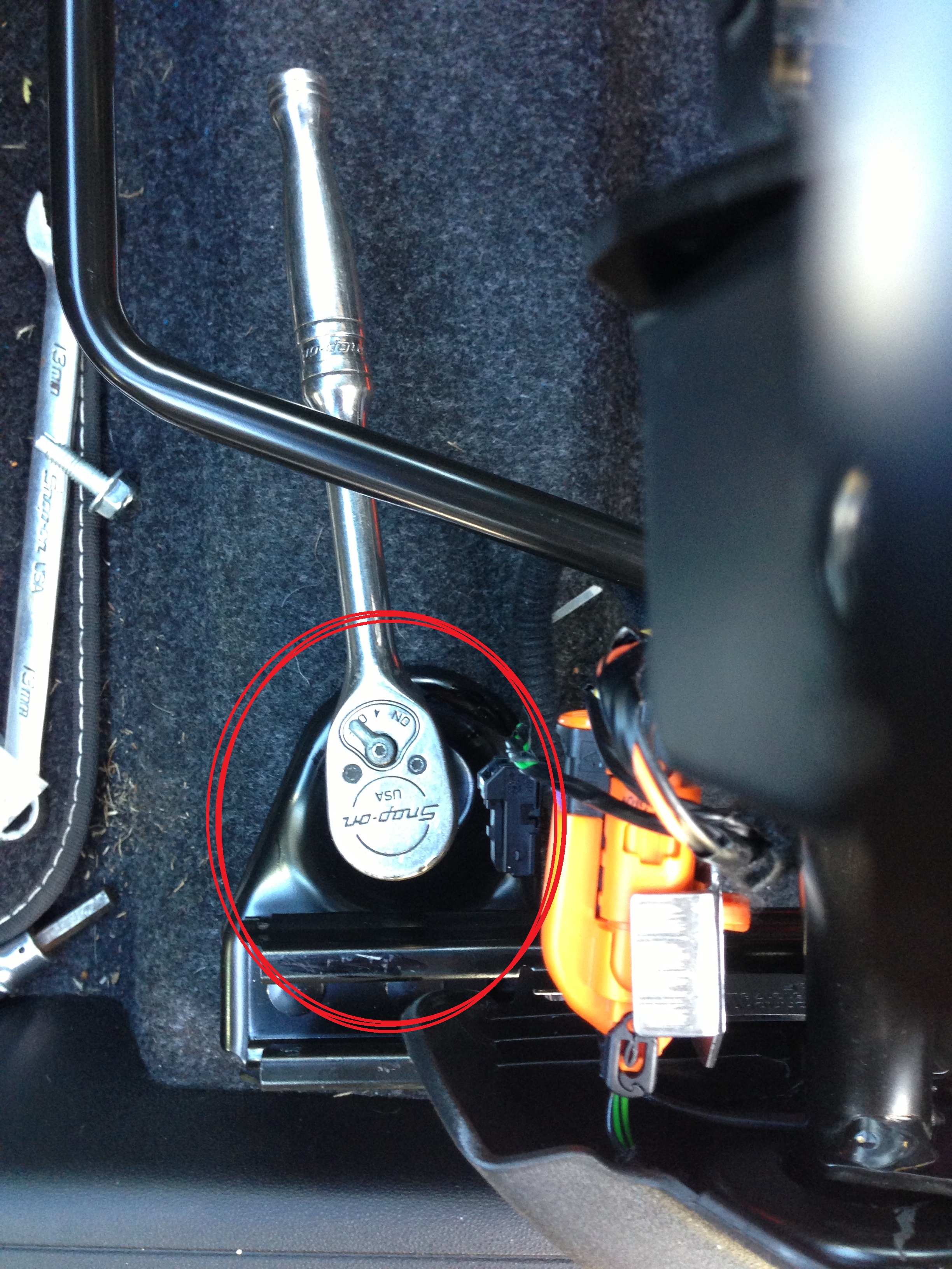

7: Now you need to remove four 13mm bots. push the seat trims away to make it easy to get on the bolts.
Located here.

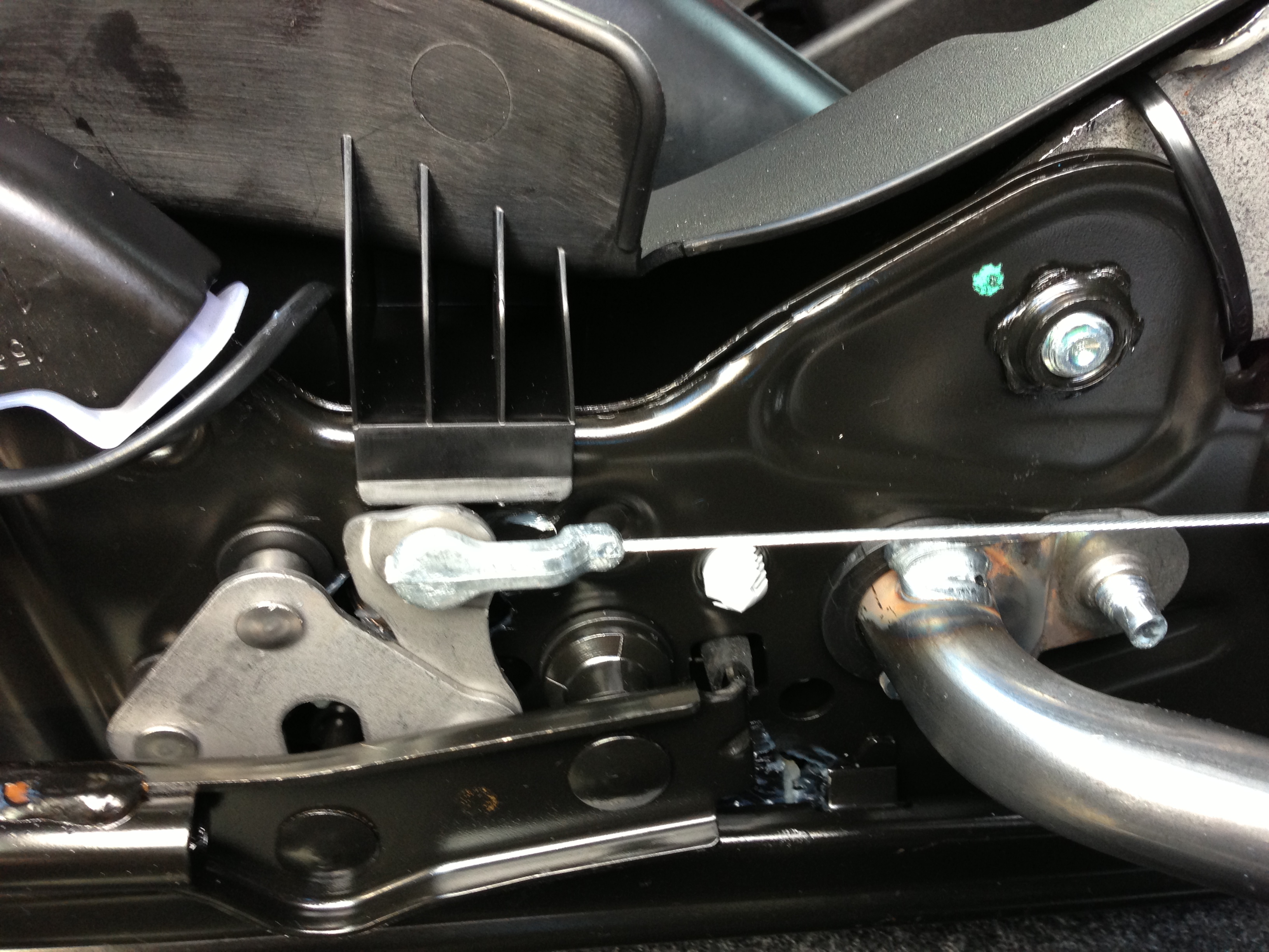

9: Now remove the O/S seat hex screw.
Here.
10: Now we fit the part that turns the seat into under storage type.
11: The bits in red need to fit into your old seat base. See the holes in seat base. push the part into place. This is why you remoced the hex screw. the seat has a bit of give in it now.
12: Now fit the bolts. As below. and refit the plastic seat trims.
