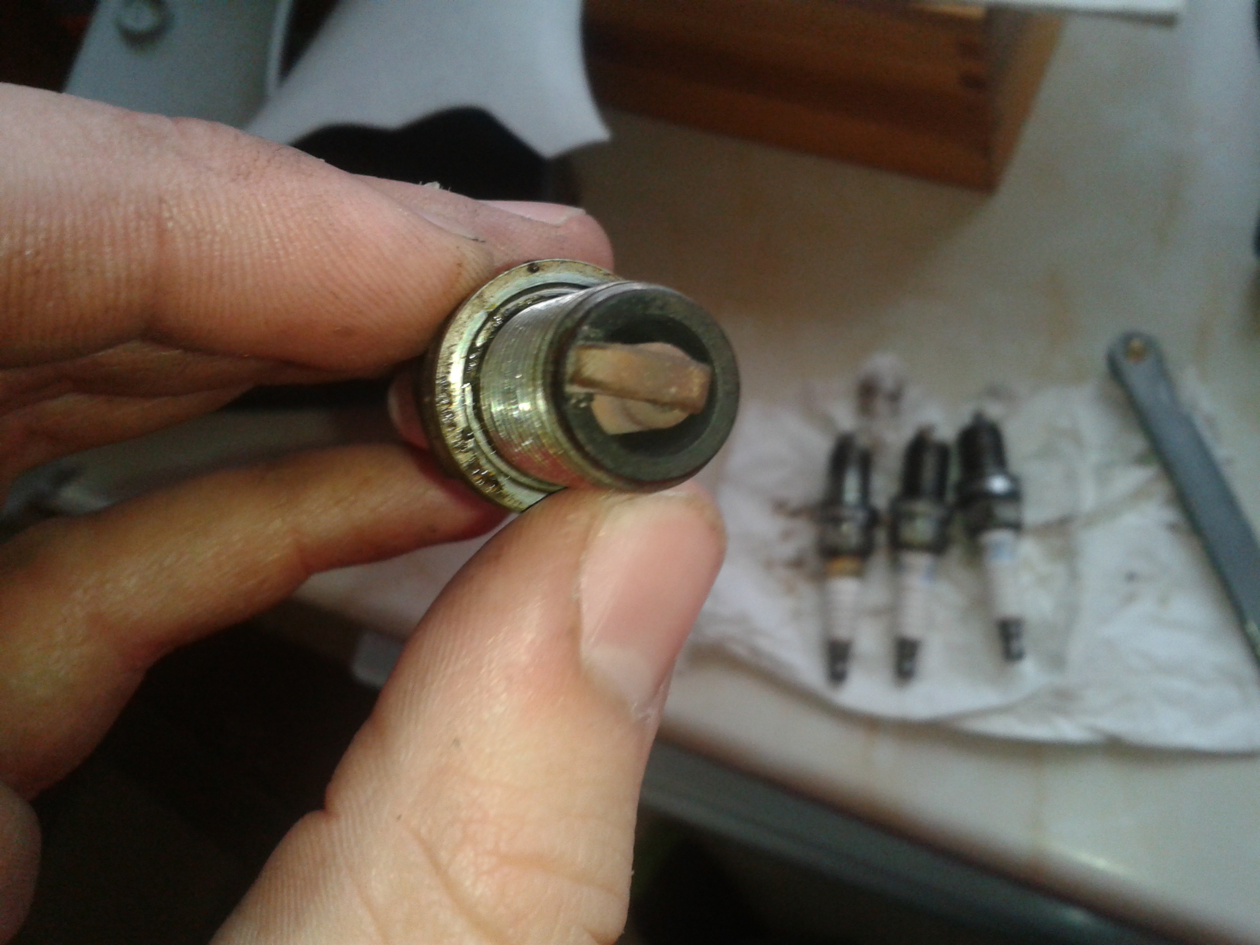

Look at the Hook on each plug and note the colour
The camera doesn't show it here - but my example here is a chocolate brown colour, which is a good sign

All 4 of mine were a nice brown colour - so i checked the gap
Even if you are replacing the spark plugs - you still need to check the gap, they say they come pre-set
but dont hold your breathe, it can come a little out still
