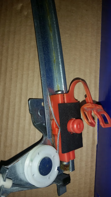

- Window Regulator for the left or right side. They're both different so get the right one. FIAT PART NO. 51723323 (right side).

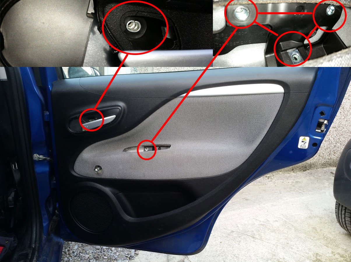

- Unscrew the screws circled below.
- Use a plastic trim prying tool around the perimeter of the door card which will begin to release from the door chassis.
- The door card will now be hanging from the very top where it hooks onto the door chassis, just lift upwards to remove.

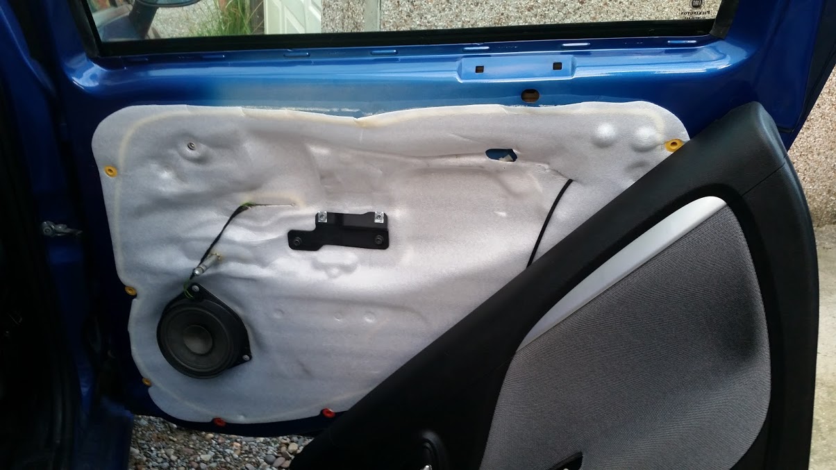

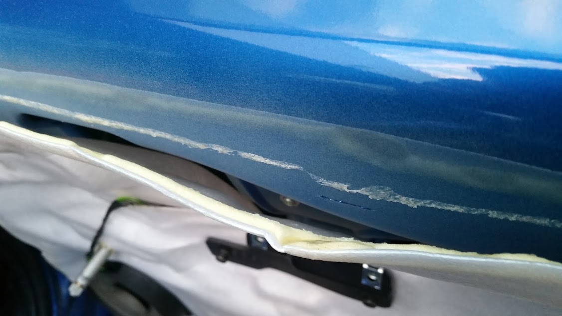

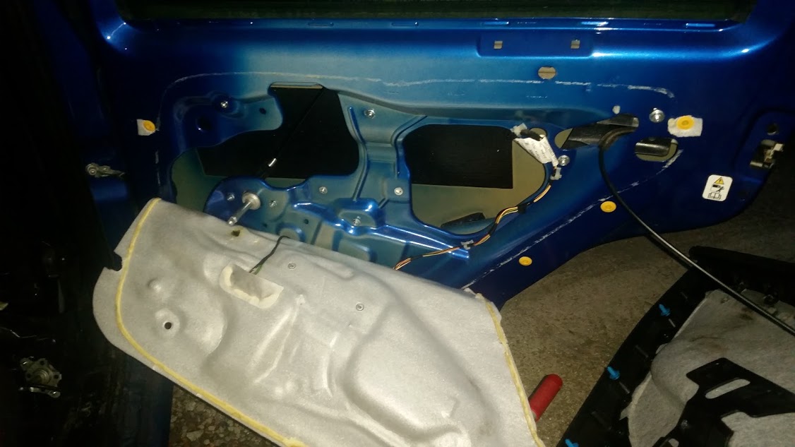

- You'll see that the inner workings of the door are hidden away by a white sheet which is attached to the door using some really strong glue. I used the same plastic trim prying tool to just go around the edge to separate it from the door. Unfortunately, you will tear it.
Oh, remove the black bracket shown in the picture below too. - Cool, with that out of the way we can now see the interior of the door.
- Remove the 4 screws holding the window regulator in place. 2x for the winder and 2x for the regulator. Use the new regulator for reference.

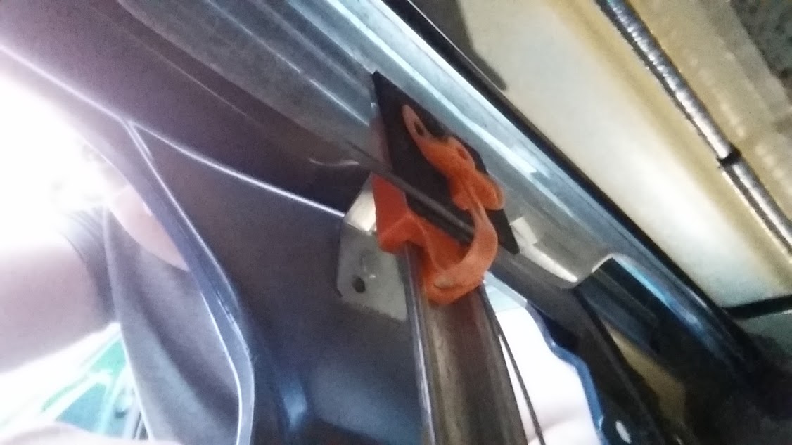

- At the bottom of the glass there's a special hole about the size of a penny for the regulator to go through. Unclip the orange clip to release the glass. You should then be able to detach the glass from the orange clip by sliding it slightly forward (don't bend the glass otherwise you'll be visiting A&E and Autoglass).
- With the glass free from the regulator you should then be able to swap it out with the new one.
