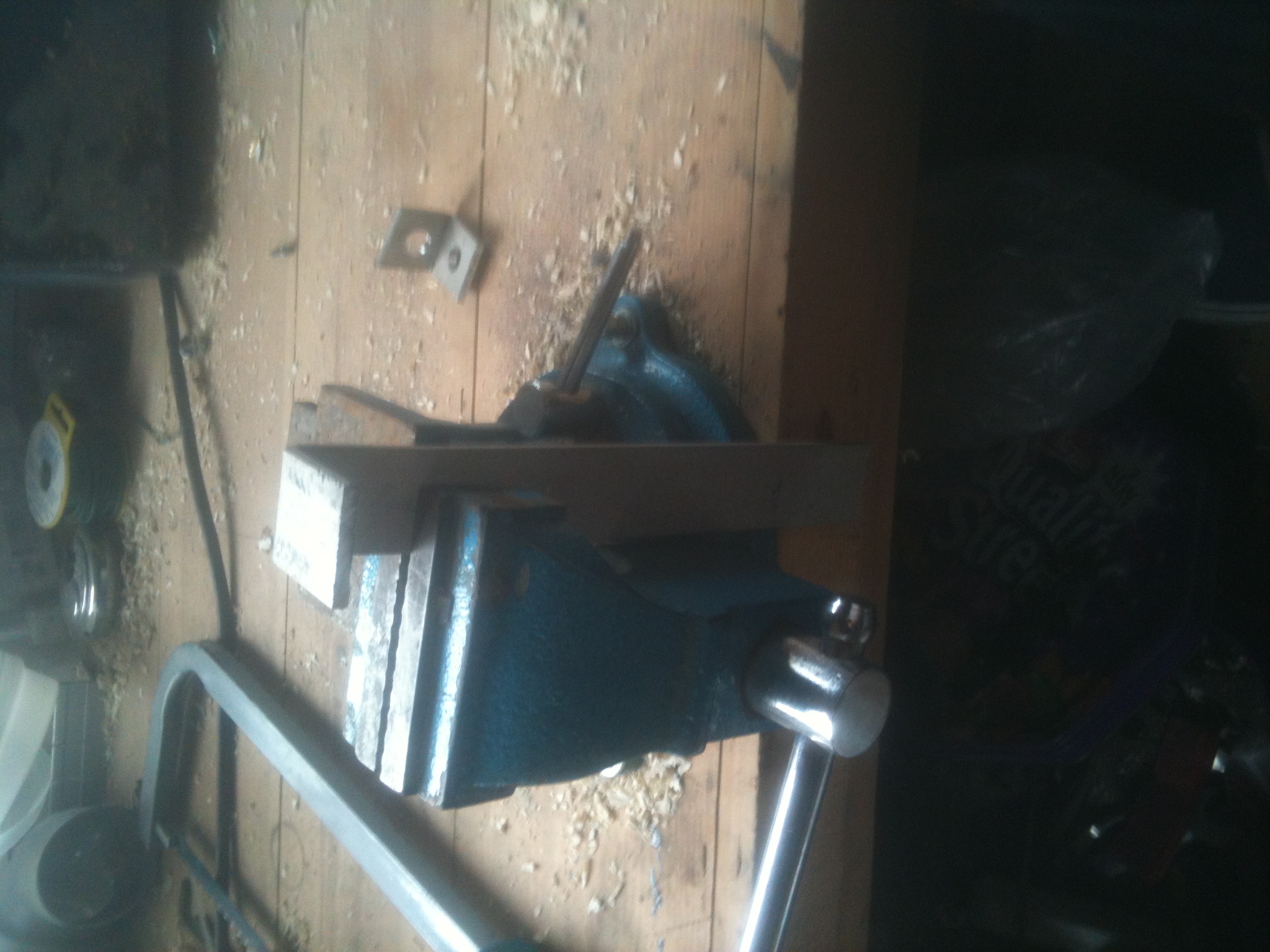

First off you will need thin strip of metal i used 4mm thickness. Cut piece 8cm long and bend in half to a L shape and drill holes big enough to fit gas strut nipple and star bolt that holds light in place.

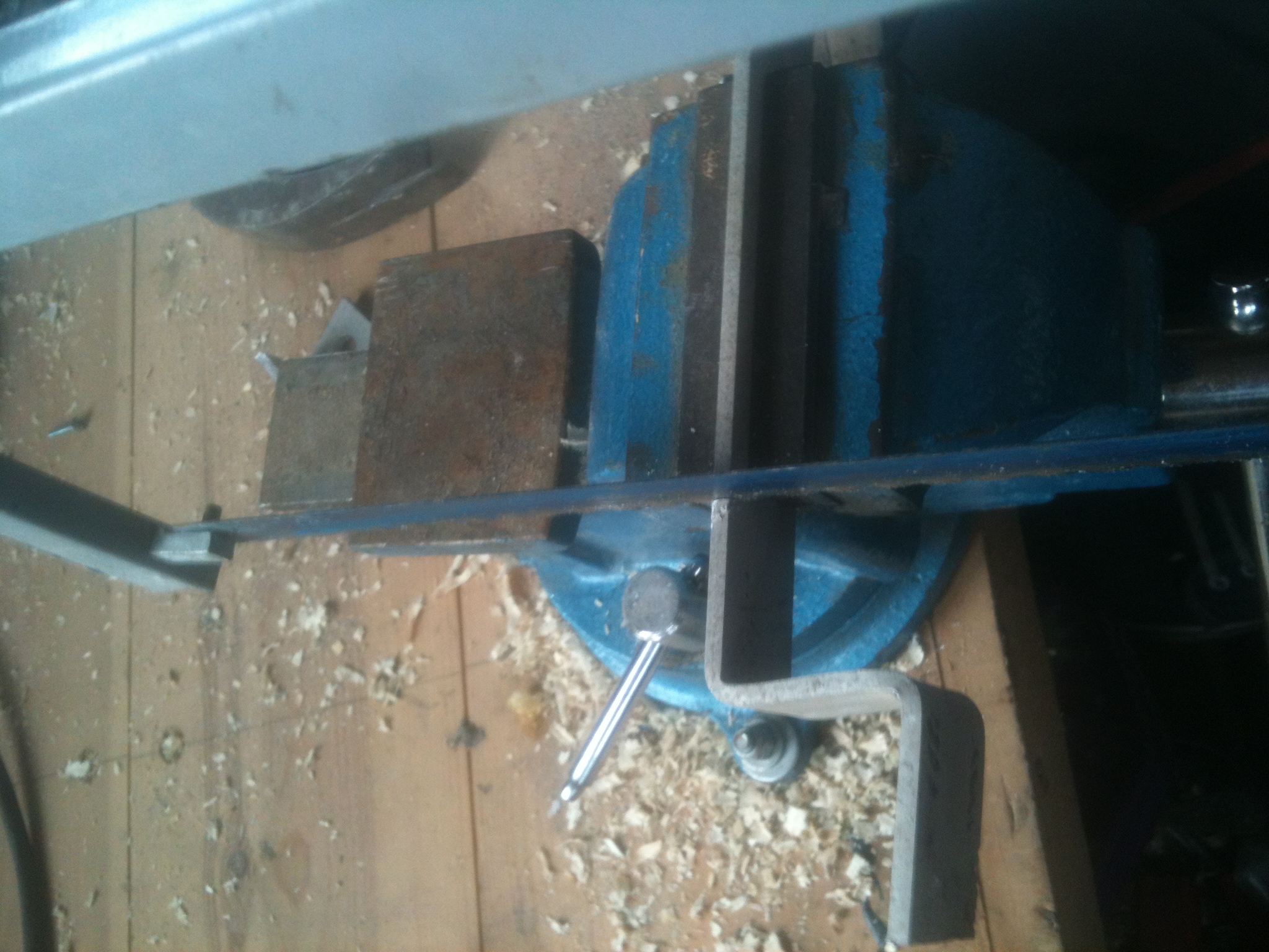

Next bracket
Next you will need to create the Z bracket for the bonnet. Cut to roughly 12cm. MUST FOLLOW LINES OF BONNET WHEN BENDING (you will see what i mean later on in guide)
