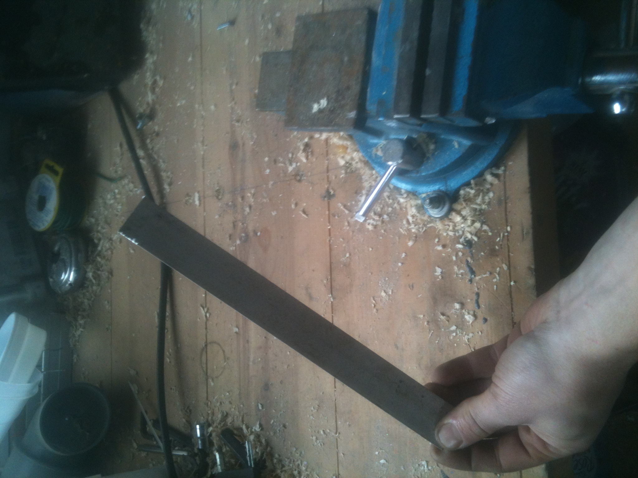

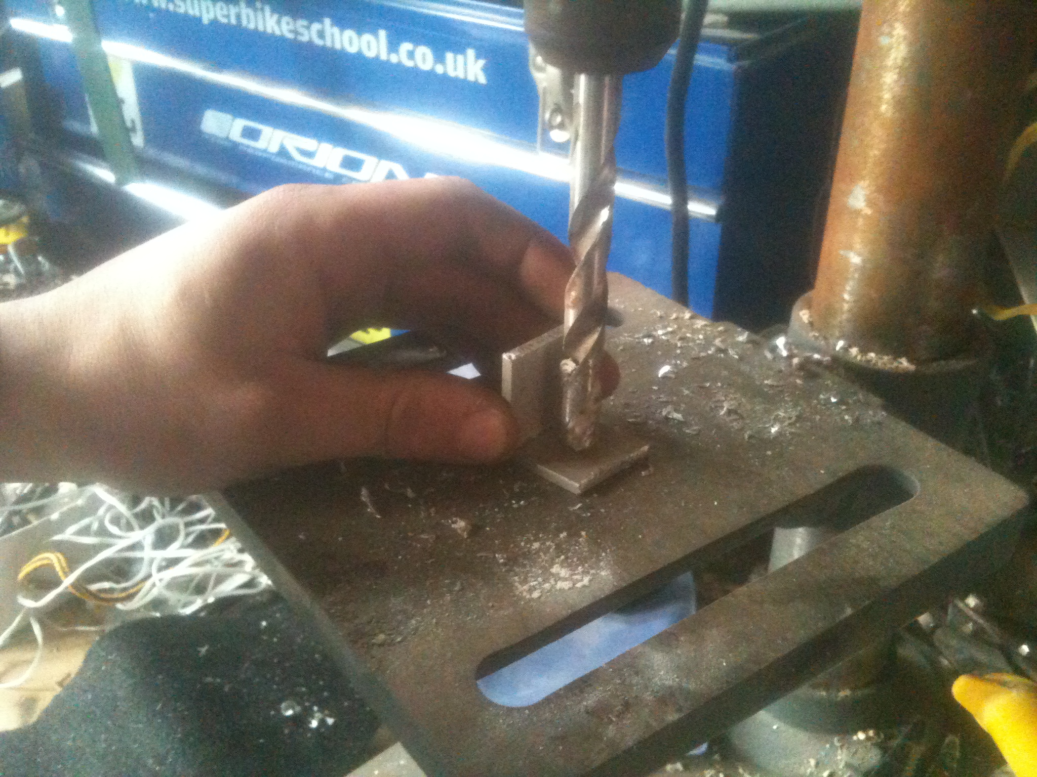

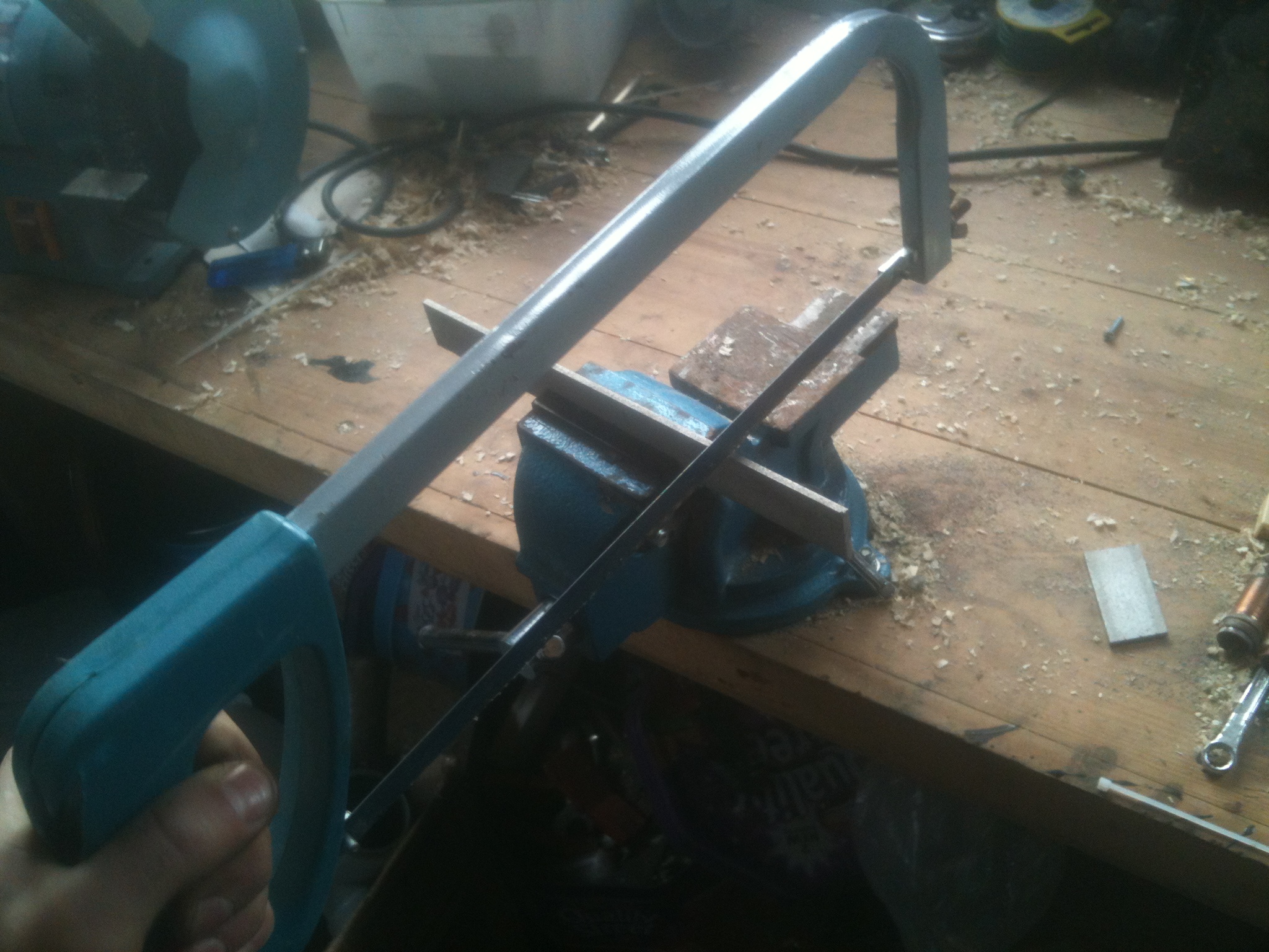

First off you will need thin strip of metal i used 4mm thickness. Cut piece 8cm long and bend in half to a L shape and drill holes big enough to fit gas strut nipple and star bolt that holds light in place.
