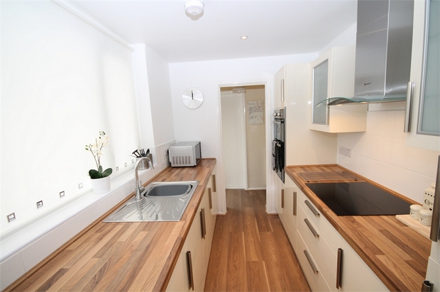

The house took up a massive part of the year, as it needed fully renovating to bring it up to scratch, including rewiring, plastering new kitchen and so fourth... Due to me being self employed as an electrician/plumber, I ended up taking 3 months off work and doing the lot myself....
3 months later it went from this....
To this....

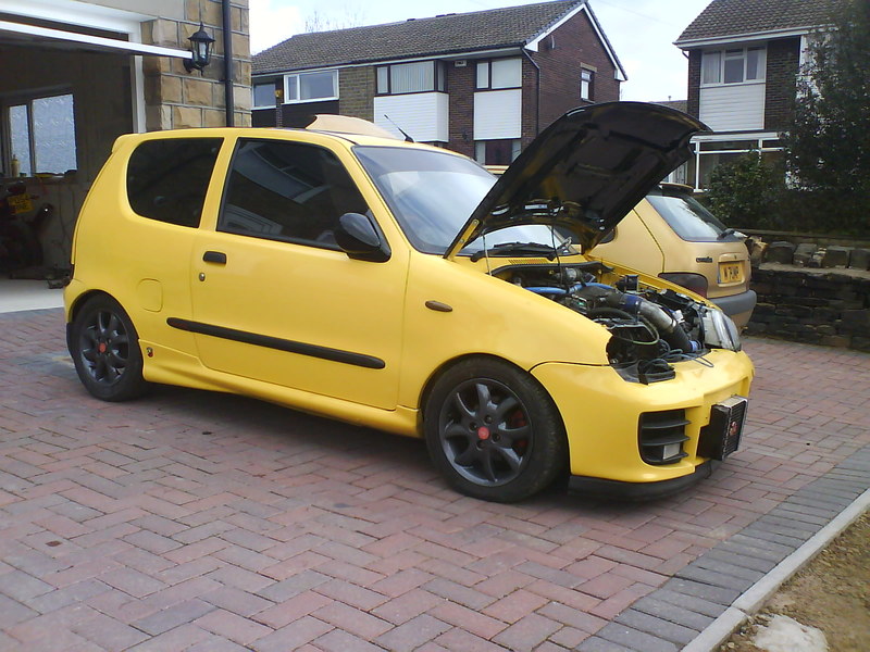

Anyhow, onto the car!! Ive been secretly waiting for my old 1.4 seicento turbo to come back online for sale, always joking that if it did then I would buy it to strip into parts as it had a fortune 'apparently' spent on it (think upwards of 18k)....

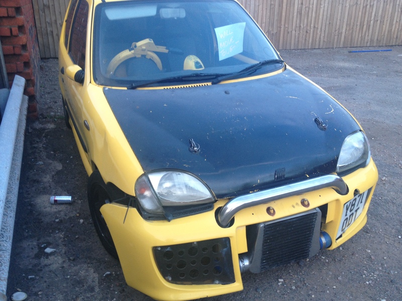

Anyhow, it arrived, and to be fair I had forgot how bad it looked.... what an eyesore..
As much as it looked bad when I owned it the last time, it has got progressively worse!... Its well known on the forum as a bit of a sl*g car due to the amount of owners it has had in its life....
It was apparently built by Wardy25 and his friend, with wardy paying for most of the work. From what I gather, there was a dispute of some sort between the two, and the car was never fully finished.. As you can see it wasn't mint, but it never used to look quite so bad...
No idea how its got into the state that its in now lol, but its time for me to change that!!

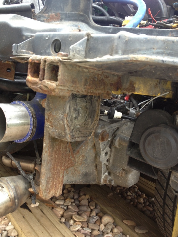

The original car is way too gone to save, and to be fair as I point out later, the engine conversion itself hasn't originally been carried out too great... Such things as the main engine mount being welded to the thin bay metalwork, and not to anything structural resulting in the mount passing through the bodywork... How was this repaired?... with the aid of exhaust rubbers mashed in-between the body and engine supporting it in place lol.

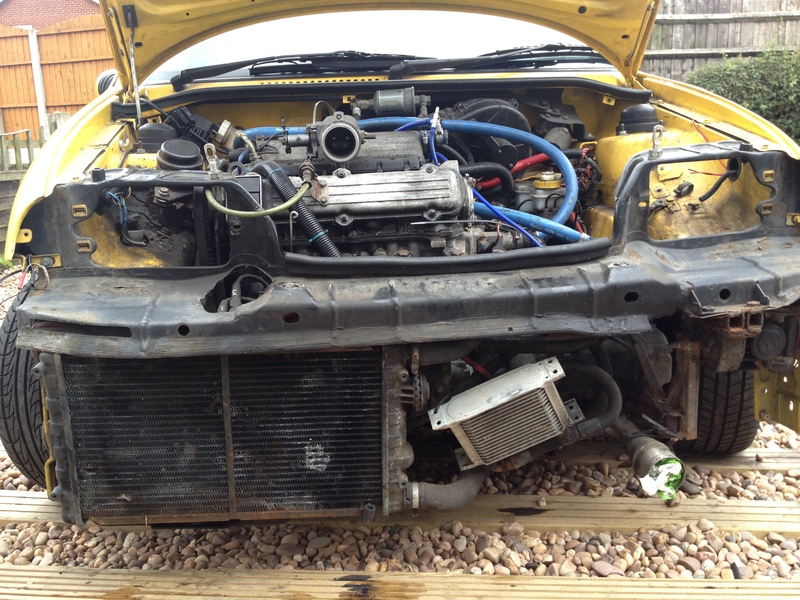

Ive started stripping the car down.... and NOT to my surprise I've found loads of reasons why this car has never actually ran properly lol..

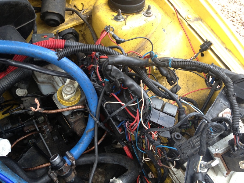

The engine bay... Upon inspection at this point, things just look messy, but nothing screams out at you...
Then its time to uncover the electrics... (ignoring that the badly positioned stainless boost pipe work is arching out on the broken HT leads)..
All this lot was hidden in a plastic box in the engine bay....
There are exposed connections all over the place in the engine loom, for example the coil... Soldiered, practically all pins touching...

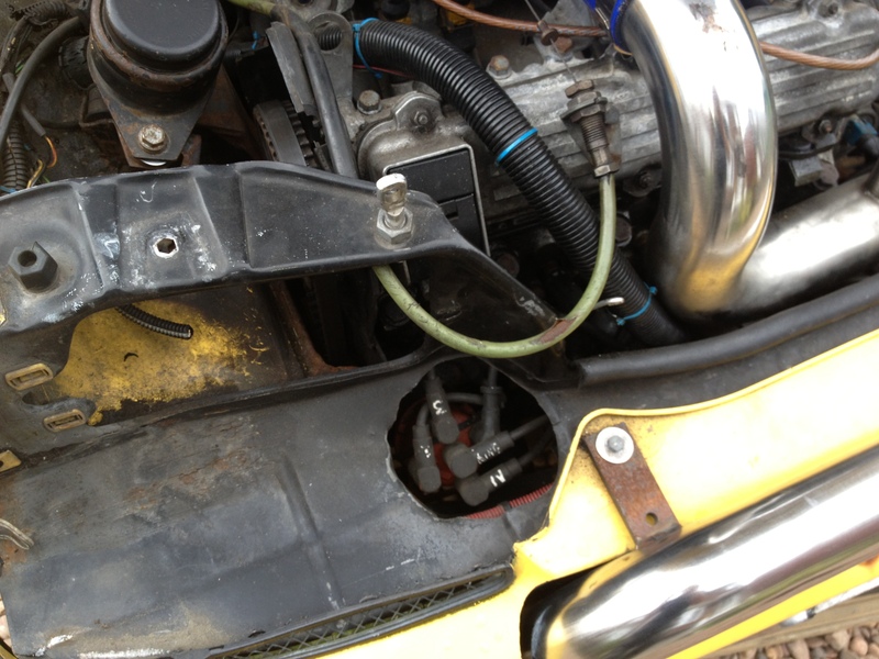

Dizzy slam panel mod... (as you can see the boost pipe runs across the HT leads, and with the friction it has worn through two leads creating obvious problems).

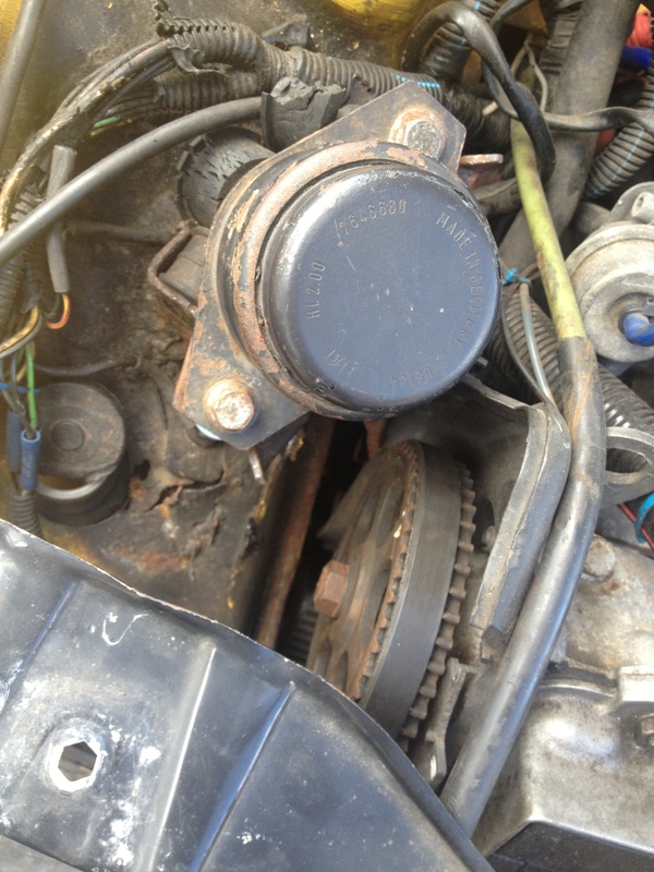

And then onto my favourite... The engine mounts....
With this beauty, it seems to have been welded to a single skin part of the car which has no under support as far as I can tell... The mount looks to have given way (well at least ripped the metal work apart)... and then fixed with perished exhaust rubbers... Im guessing by the look of the half width cambelt, the engine has dropped while running...
