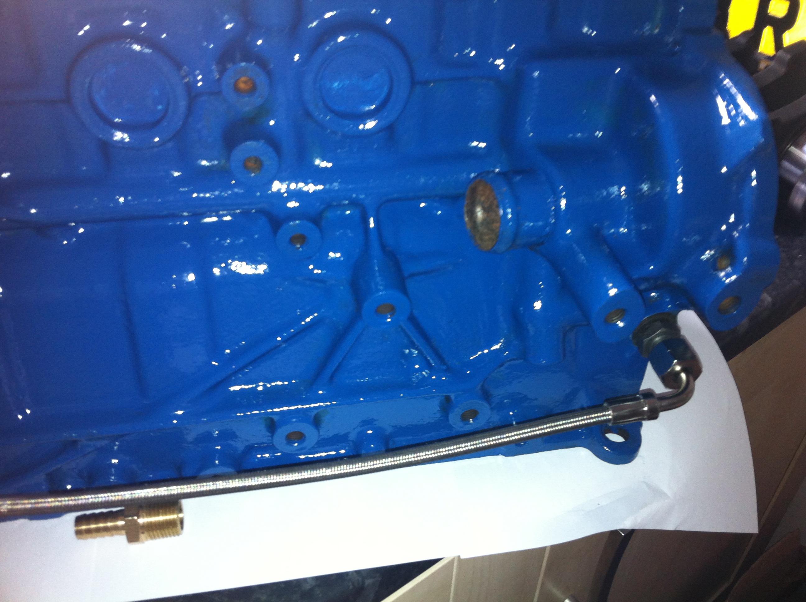

C20XE Engine Block...
This has been rebored & honed by Nuneaton Rebores to 87mm with chamfered tops for easy ring fitment. The block has had brand new coreplugs fitted, front turbo oil return fitted, and a genuine vauxhall let rear oil feed. Can be turned into a NA again with the front blocked off and the rear feed removed. The block is currently painted in blue hammerite, the bores have been coated in Graphogen and the block wrapped in cling film to keep the dust off (stored indoors - heated).

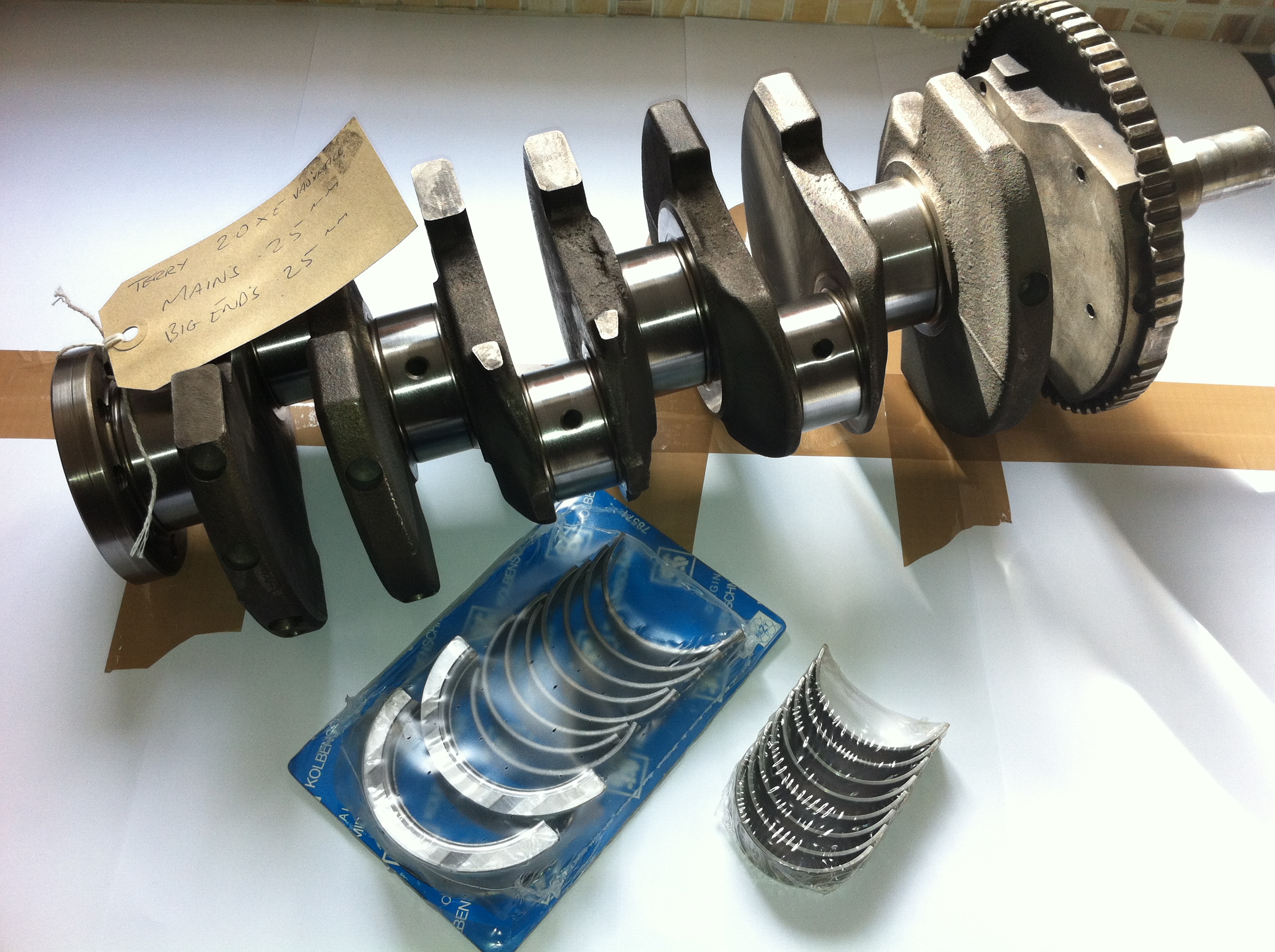

The crank...
This has been tested by nuneaton rebores and is within tolerances balance wise. The crank has been re-ground to a 0.25 oversize on the big ends and mains. I have also got the brand new oversize bearings for this crank. Its a strong XE one. This has also been covered in Graphogen on the bearing face of the crank & wrapped. Stored again indoors....

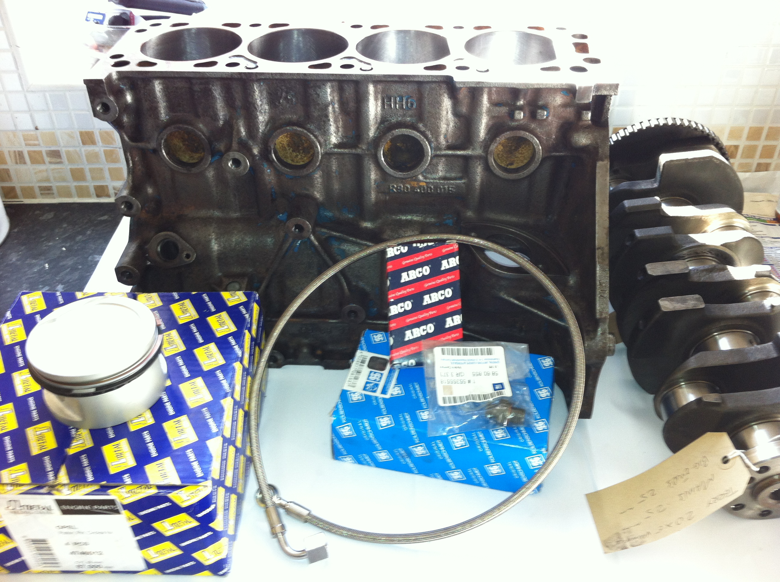

Pistons...
Brand new 87mm pistons (oem early piston quality) with brand new rings, Pins and circlips. These are NA pistons obviously and the rings have been fitted to the pistons as Nuneaton rebores wanted to gap the rings and make sure the bore work was perfect.
The crank...

Pistons...
