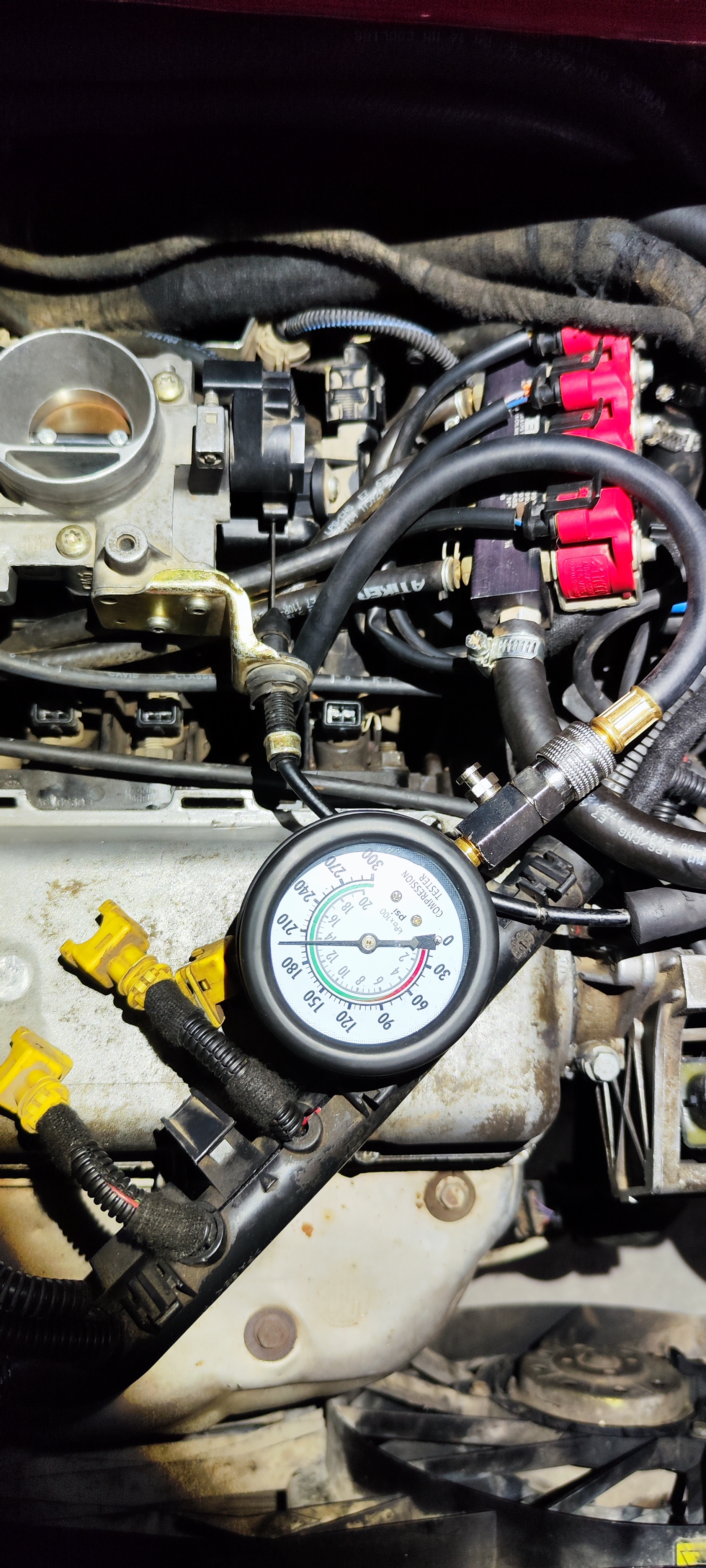

You need a pressure of around 100 psi just for combustion to possible, you are below that
Mine is 215 psi 1.2 2010 I have tested it a few times always over 200

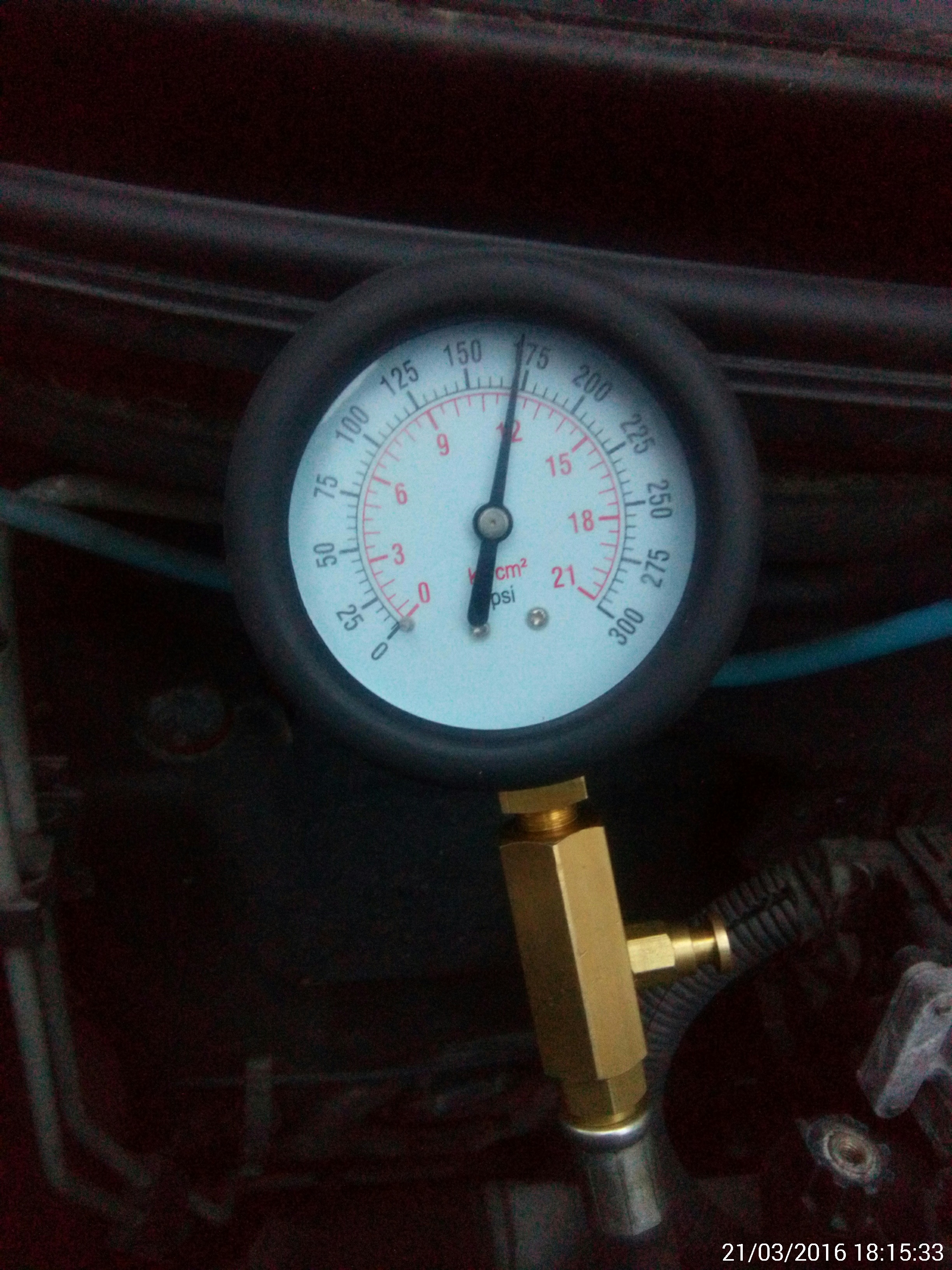

1.2 8v compression 175 psi or 12 bar bought this 8v supposedly with bad hg, changed battery car started in first try, measured compression (dry) and it was around 175 psi or 12 bar on all 4 cylinders car was almost cold, car doesnt lack any power is that normal compression?

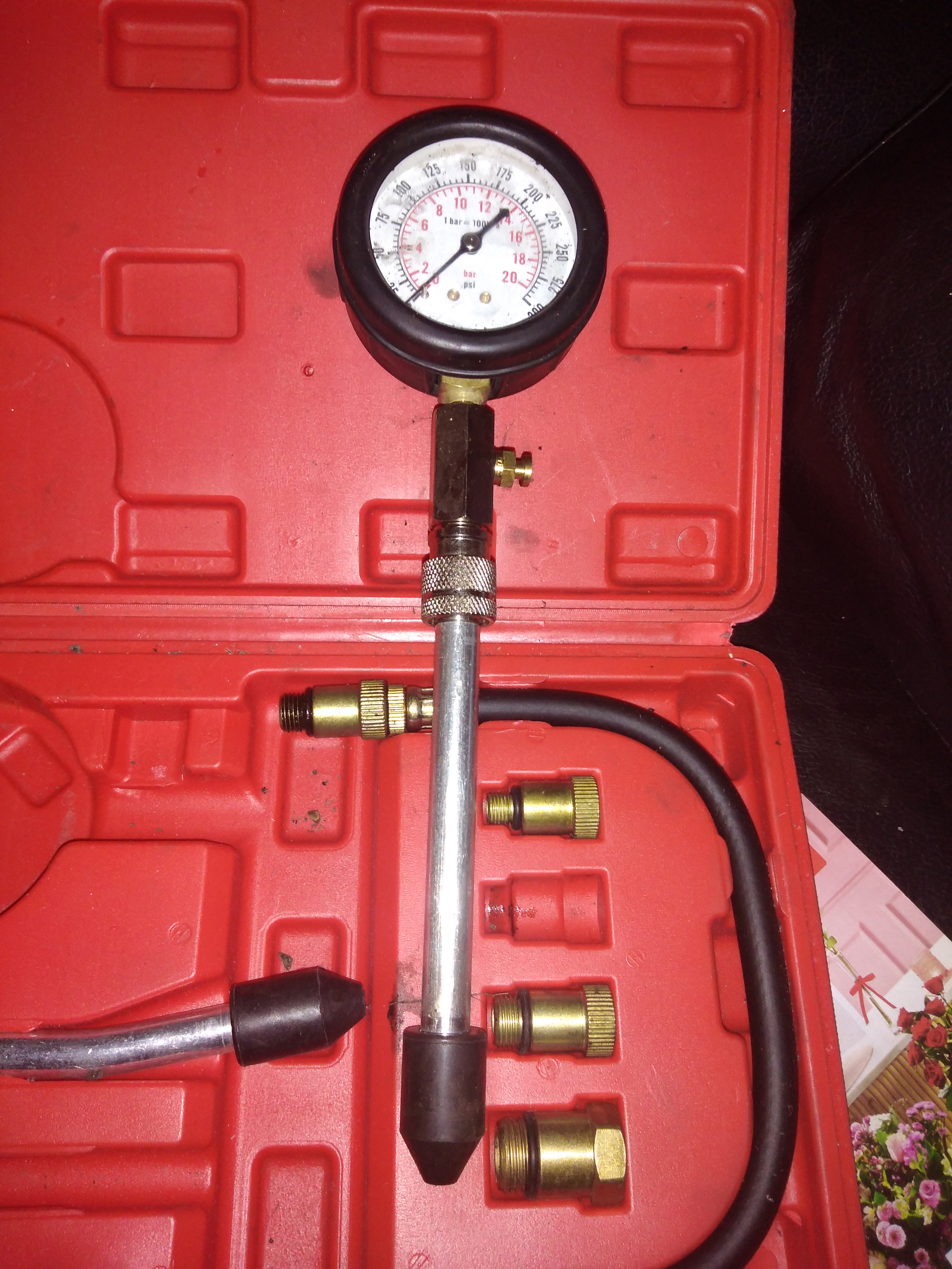

You are either doing the test incorrectly
The gauge is faulty
Or this is your problem
