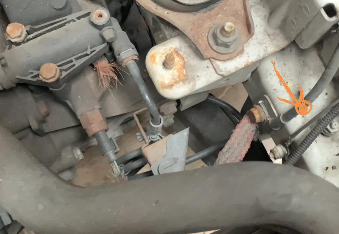

My 2006 FIAT Panda Dynamic currently has a problem where the engine cuts out. It cold starts fine. Drives fine to whatever destination. Starts fine again, but then starts cutting out on the return journey.
It seems to be doing it mostly when applying the brake, but it has also occured when beginning to move like when in traffic of at lights. Most of the time it catches itself again, occasionally with the power steering light remaining on afterwards. But some of the time it doesn't kick straight back in and may need a few turns of the key to get going again.
When it originally happened a couple of weeks ago, after the fifth time of it cutting out, it wouldn't start at all. No lights on the dash and not turning over. Luckily, I was in a supermarket car park at the time, and a good samaritan gave me a jump and I managed to get it back home. I had an auto-electrician come out to have a look at it, but of course it didn't show any of the issues I'd been having, and the only things that flagged up were battery related.
New battery fitted. Other than briefly seeing the power steering warning light on start up, it seemed to be working fine again. This was until yesterday, when it cut out again, on approach to a motorway on-ramp. Sat there, hazards on, with a queue of traffic behind me, trying to start it back up. It took several attempts but it did eventually come back to life. But it happened again, and again. Six more times in total before I made it home. Each time it cut out I was either slowing down, or moving off.
The auto-electrician is coming out again this week.
Any ideas? Anything I should point him in the direction of? There's a good chance none of the issues will happen when he's looking at it.
Thanks in advance.
