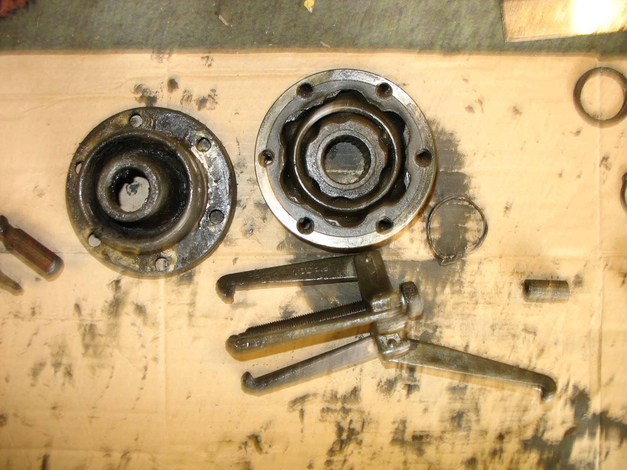

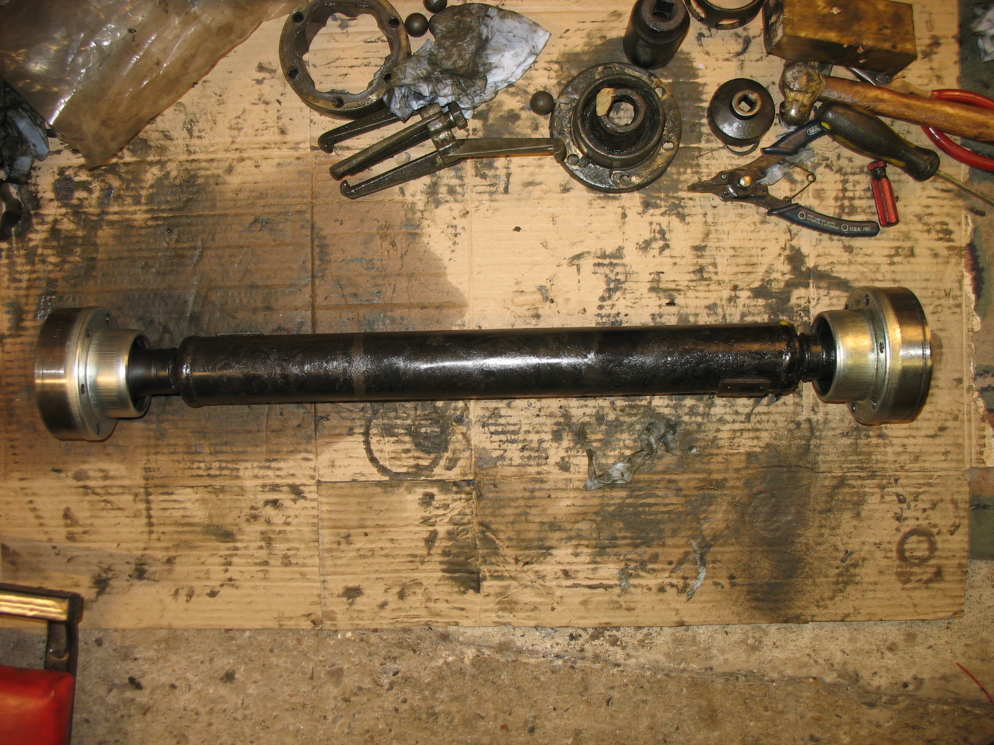

When I get some spare time, I'm still putting new shinney bits, one of the two CV joint on the front propshaft was rattling badly ( yes, it was noticeble from distance),
One cv joint rubber boot was gone on full circumference, the other one was already split. Shaft was actualy loose in horozontal axis and approx. 8-10 degrees play at the support side.

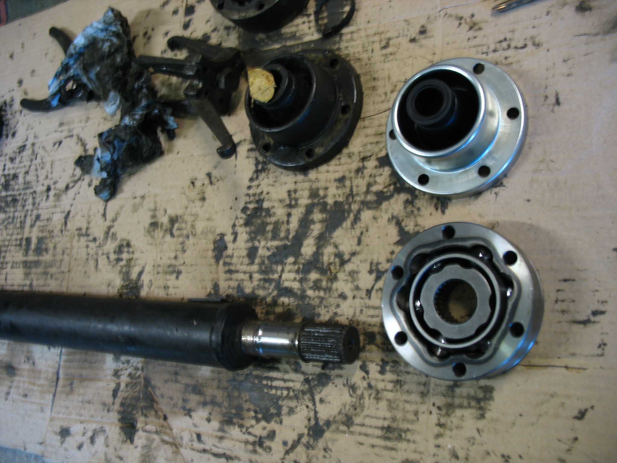

https://www.fiatforum.com/newreply.php?do=newreply&noquote=1&p=3491228
And the final result looks very nice - cv metal bands still not fitted.
As you might seen, i've got one more pair of those boot advetised on here.
I will let you all know my secret, as i've already told it to Vmax at Panda Camp- above CV joint is same as inner cv joint for Alfa 156 - only £14,
http://www.ebay.co.uk/itm/130545315791?ssPageName=STRK:MEWNX:IT&_trksid=p3984.m1439.l2649
Unfortunately alfa cv boot do not fit panda propshaft.
