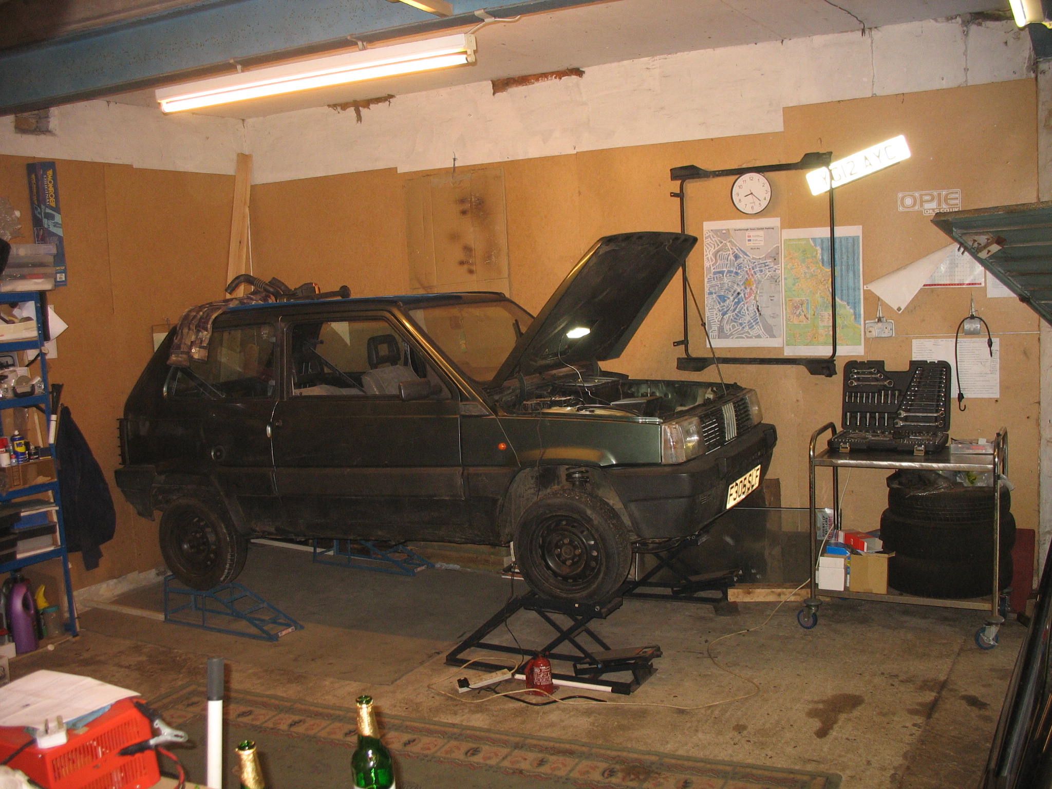

And this is how i've left it yesterday

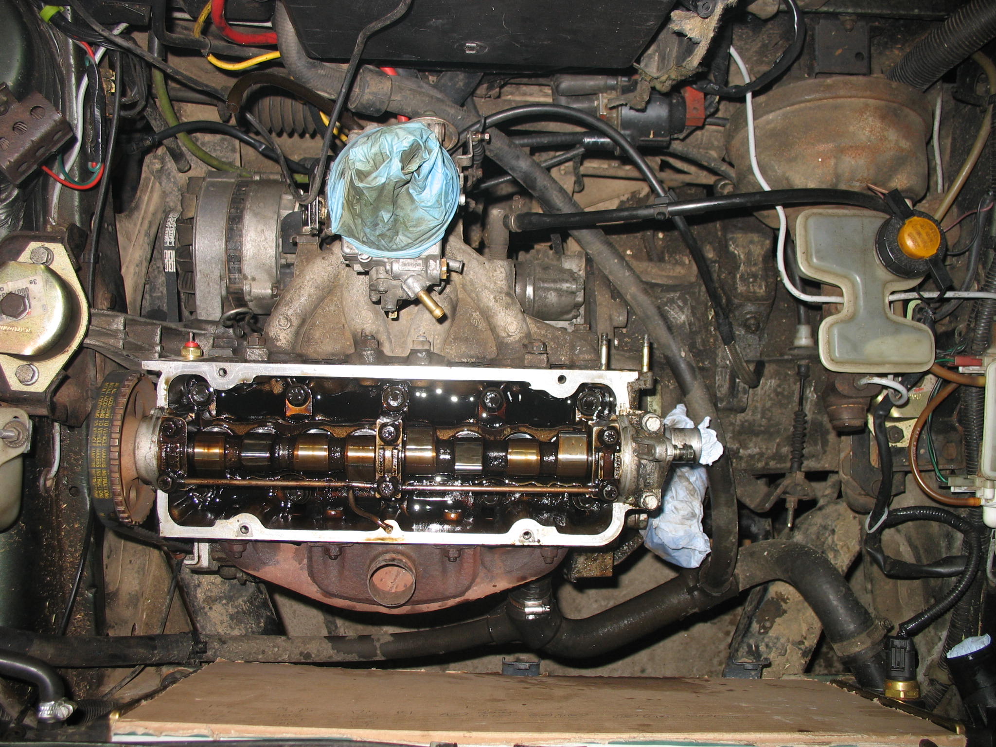

All the intake/exhaust manifold bolts and down pipe ones came off easly, plan for today is separate head from the block toinspect HG and release cam shaft.
As it was told in previous posts, to prevent sudden heart attack in the middle of green lane where nobody would be willing to recover me ( AA, Green flag forget about it - as it is off tarmac, nearest farmer - probably would have a laugh) some action must be taken immediately.
Cam looks good :)

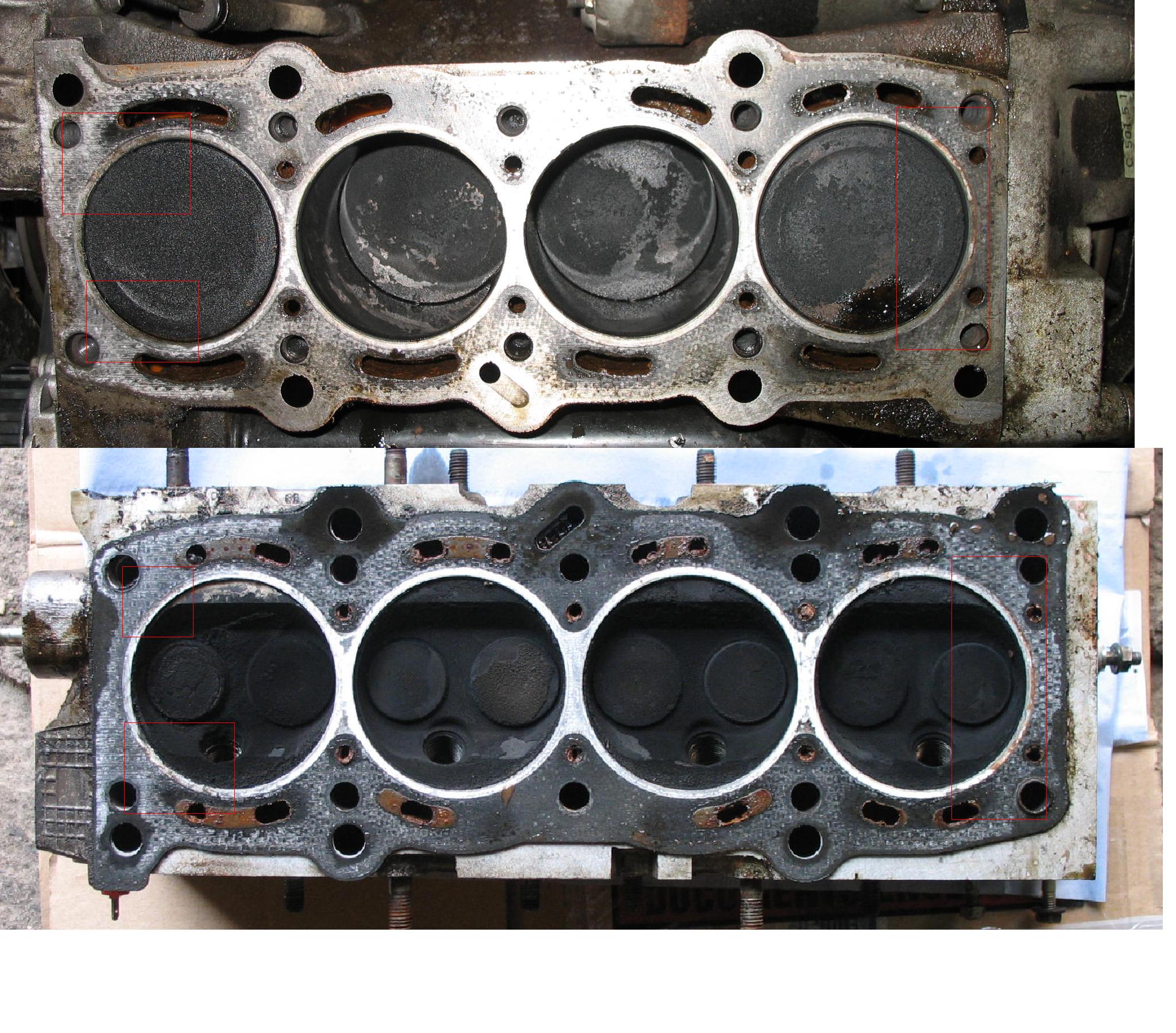

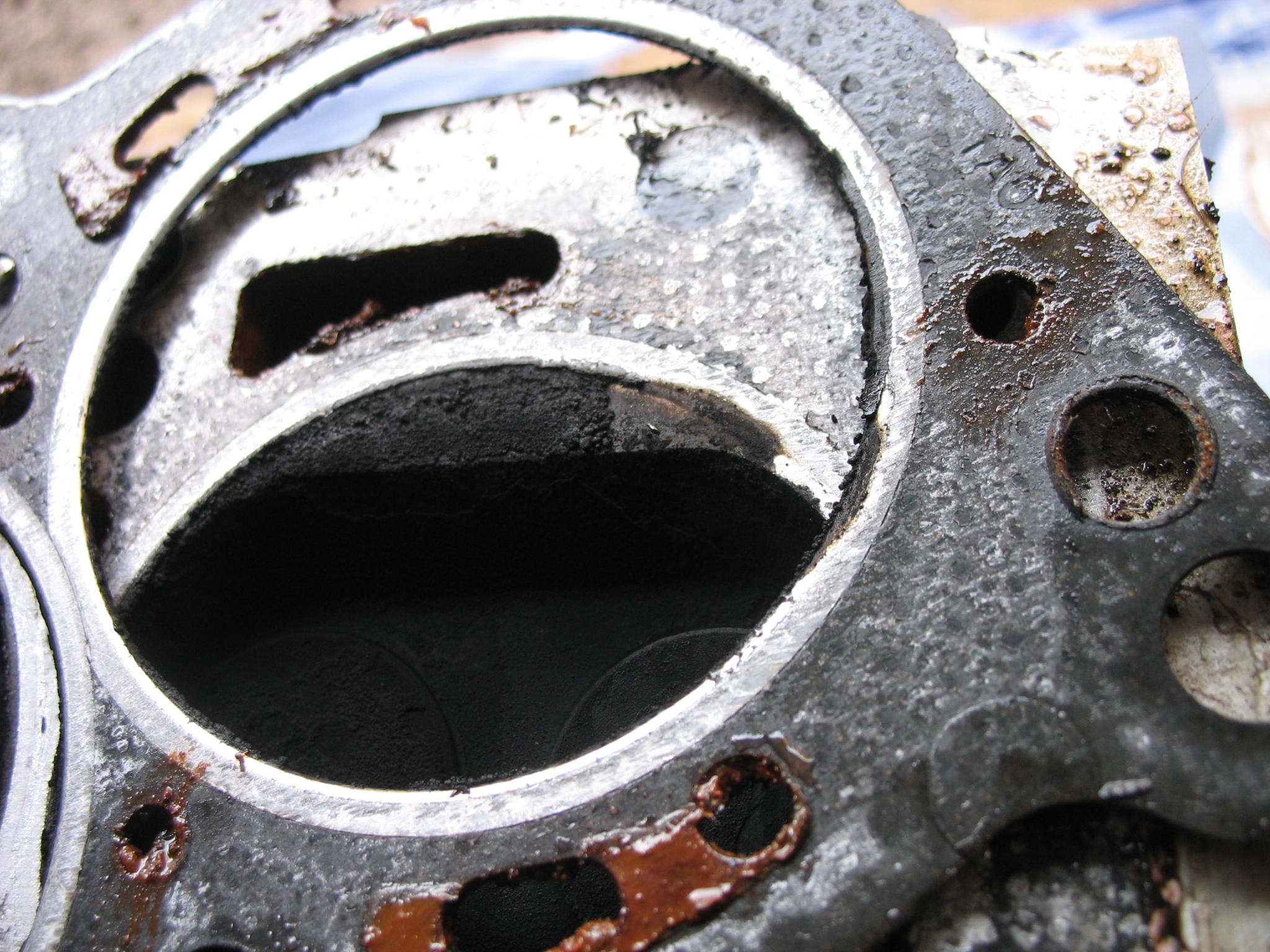

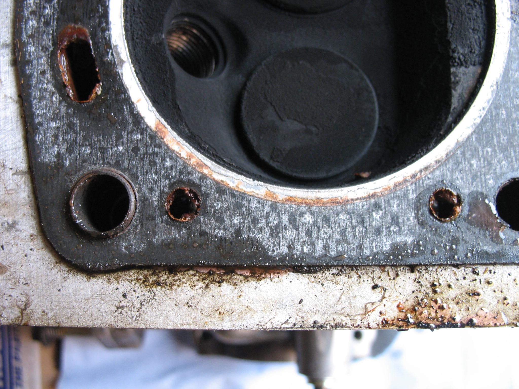

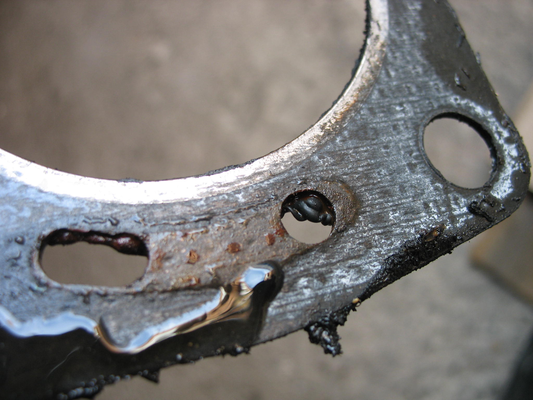

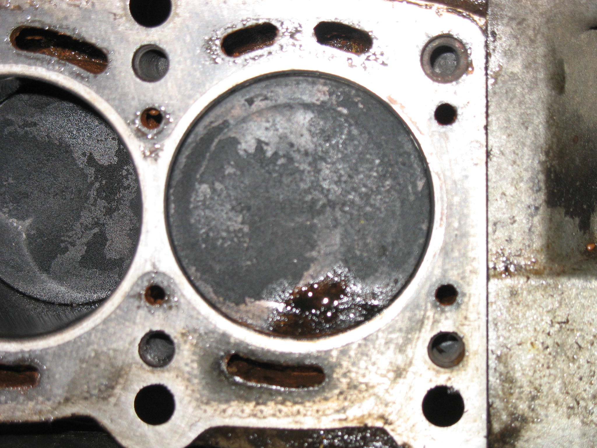

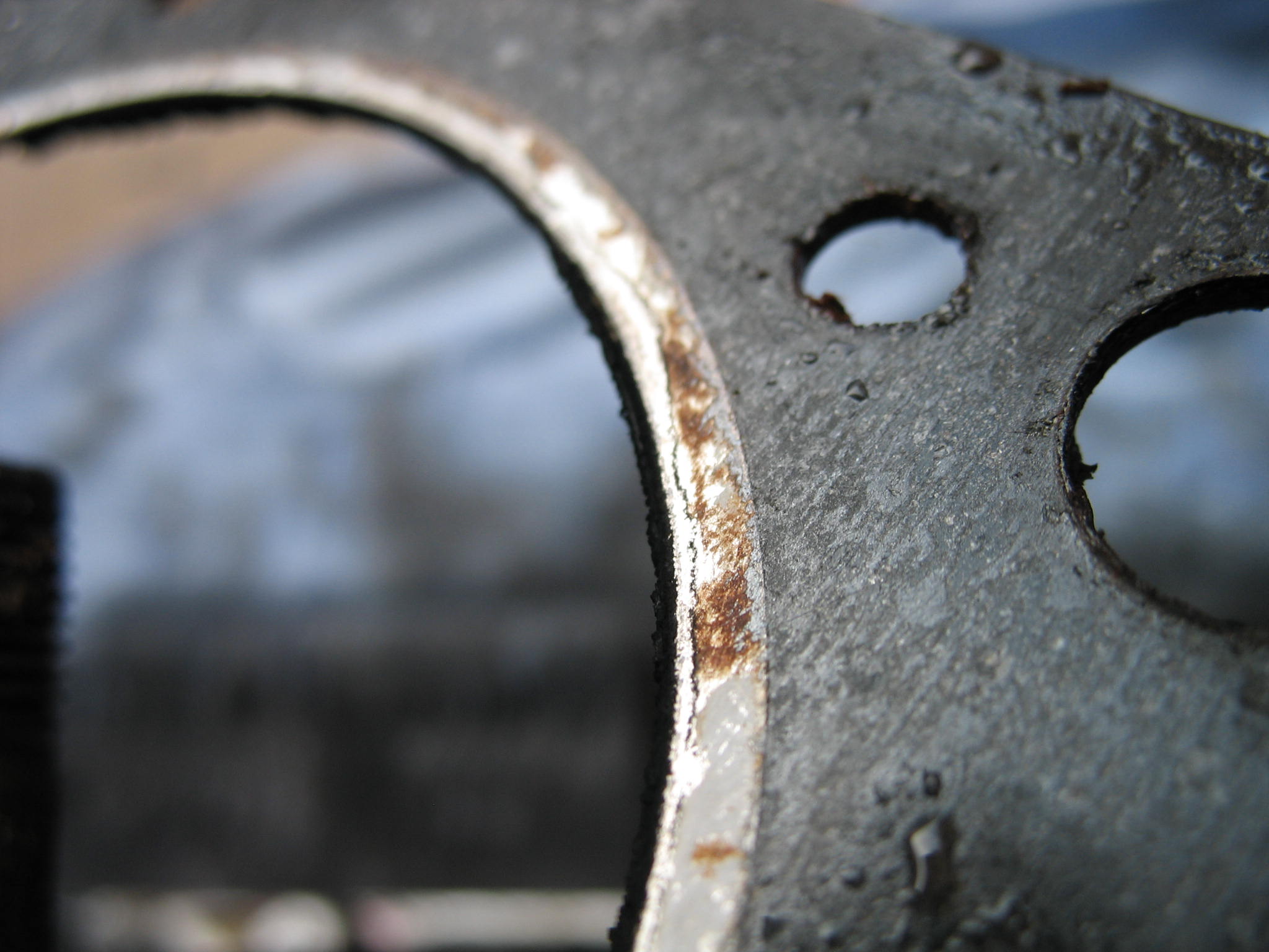

Cylinder head is off now, clearly somebody have been in before me.
There is only one locating dowel left, and use of liquid head gasket fix was confirmed.
I'm not head gasket (not blown through) expert but having sympthomps as described above can I have your opinion?
Suspected areas marked in red.
Click on to enlarge.

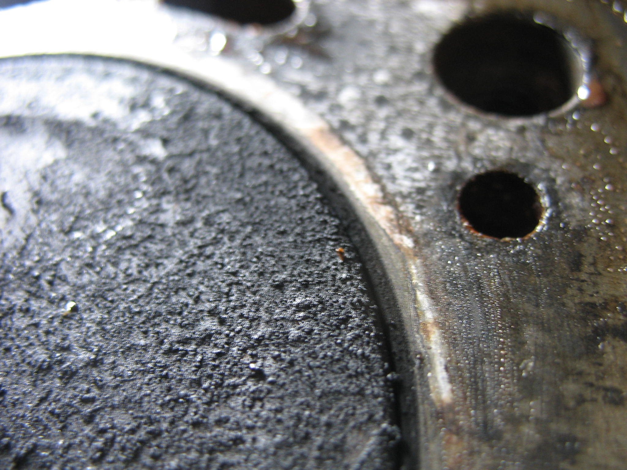

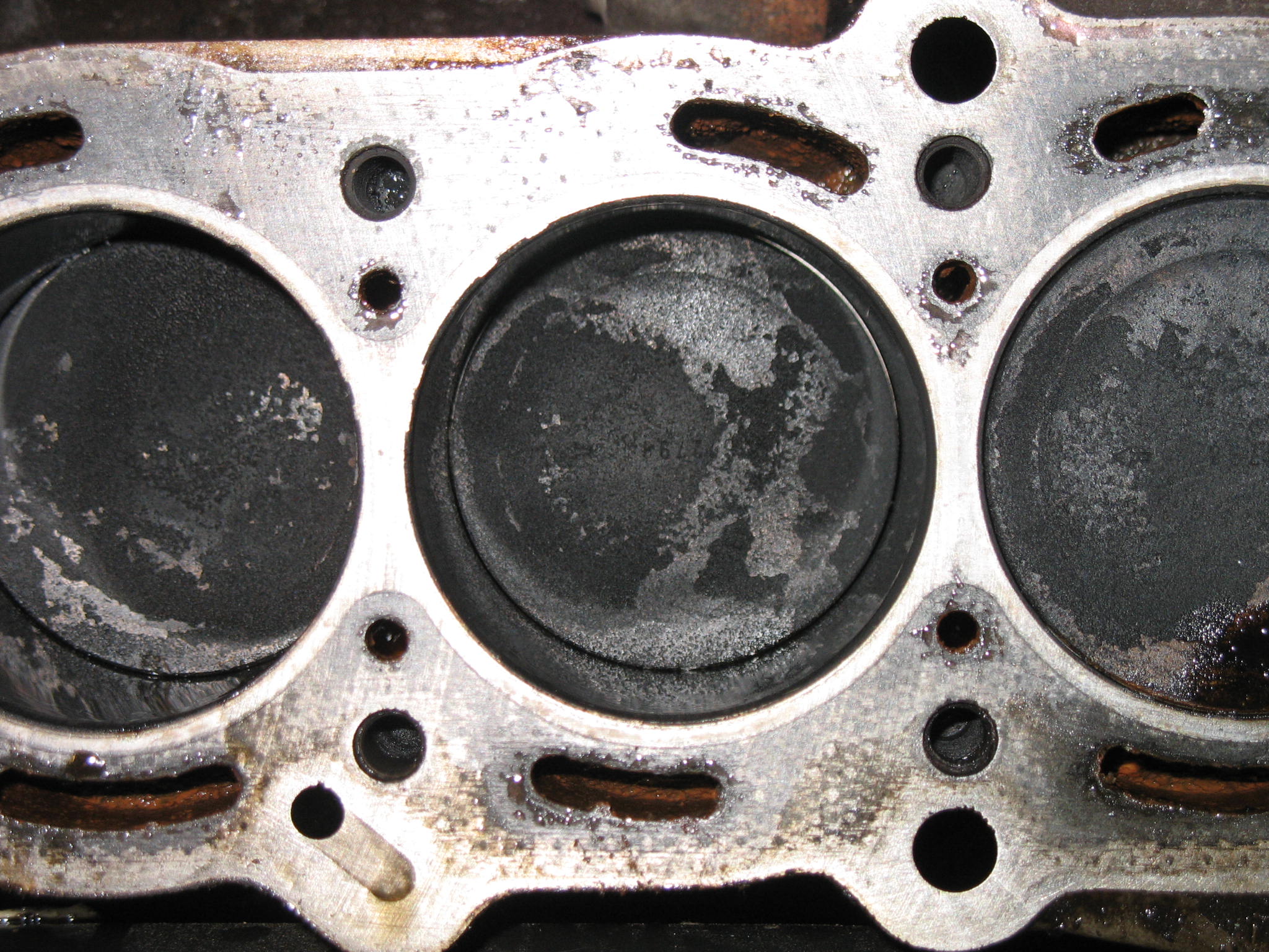

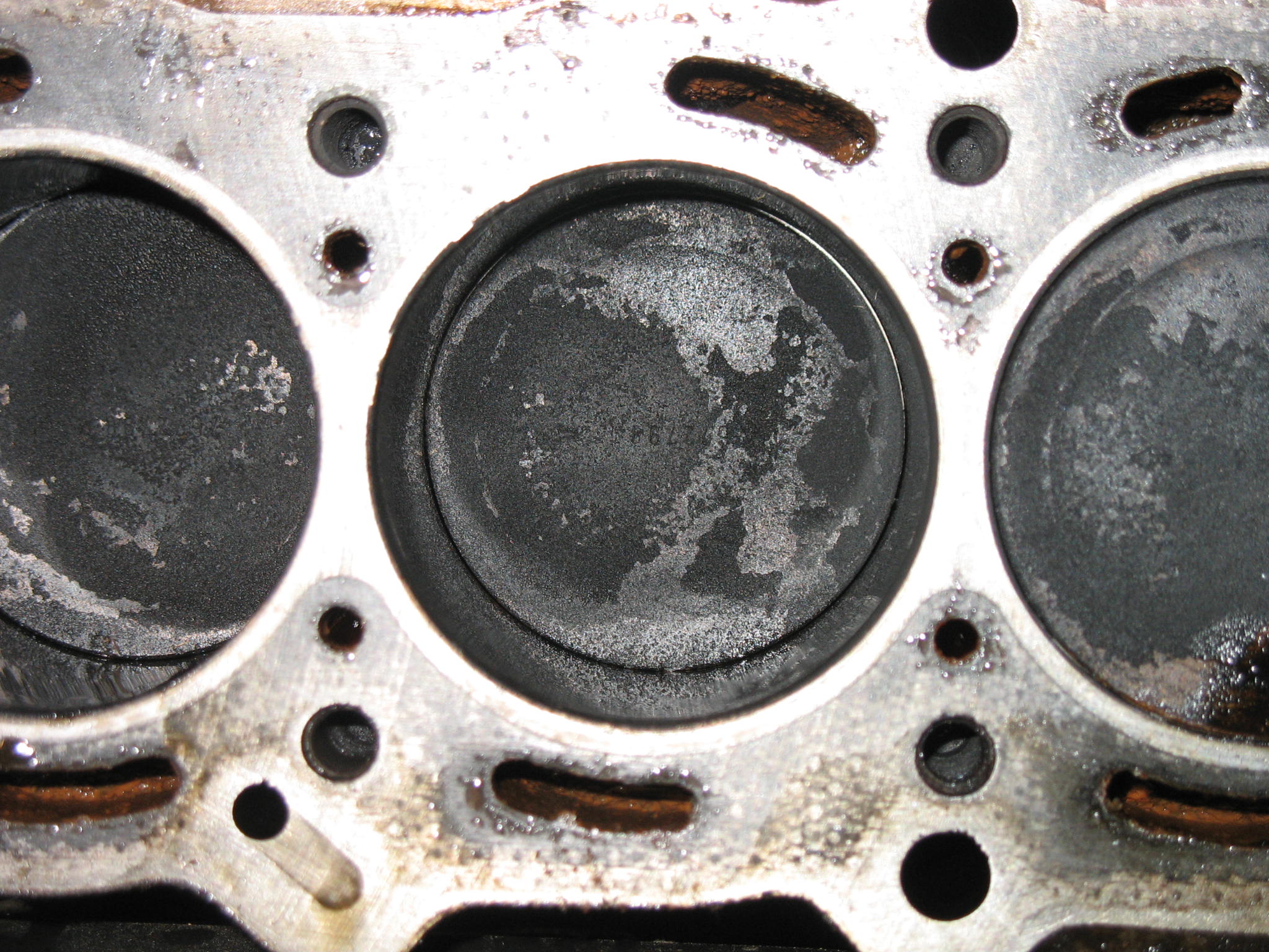

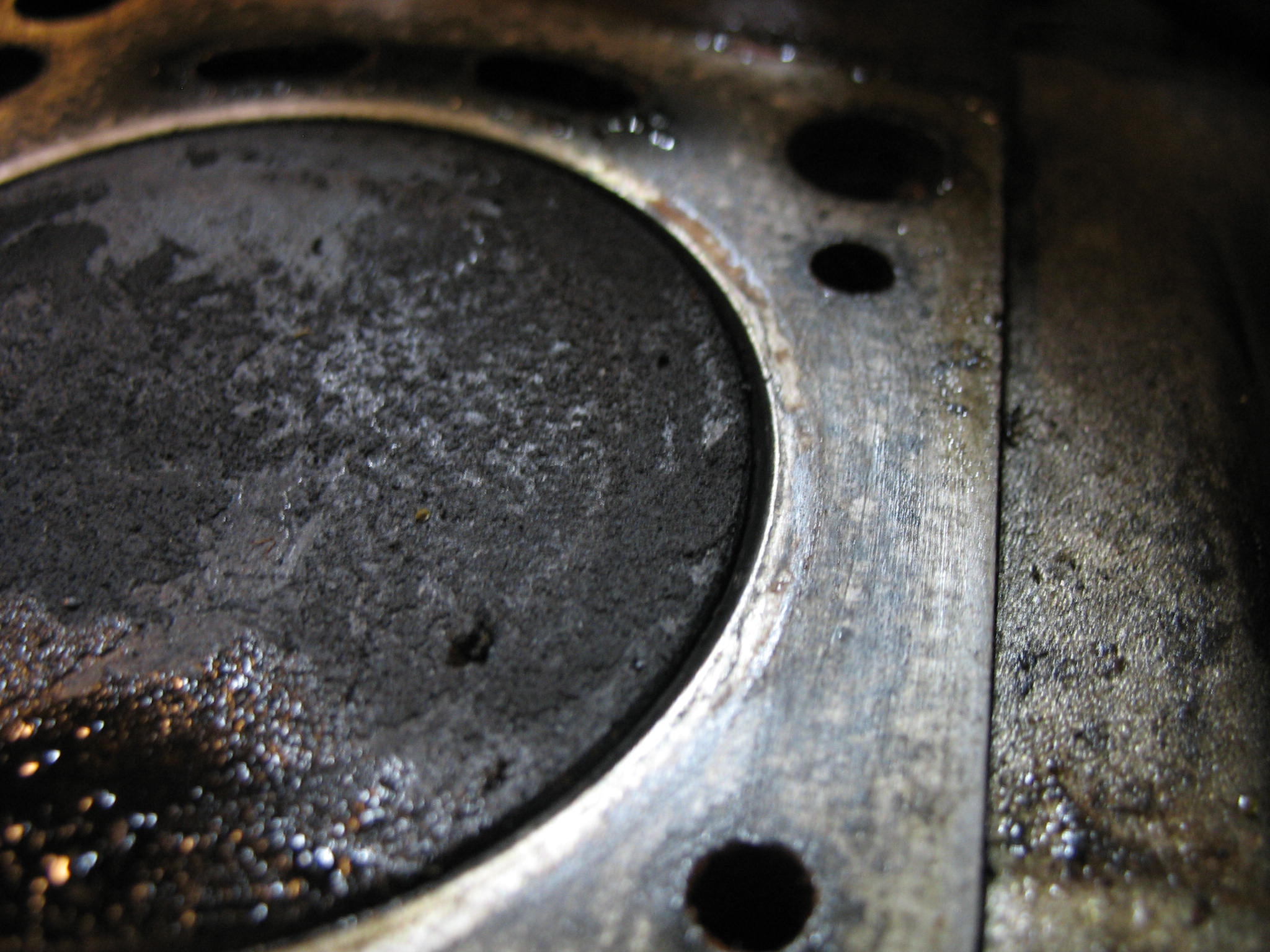

More zoom in photos:
Cyl 1
Cyl 2
Cyl 3
Cyl 4
and more
Next step is to clean the meeting surface and access is the skimming required.
I was expecting to see something more spectacular - is it enough for engine to run on 3 cyl from cold and overheating during normal use?
Can I guess "probably"..?
- It's off now so will be replaced. If no other changes other than to button it up again then the theory will be tested.
If sparks are good and compression is even then water vapour leak in to cylinder is only explanation for 3cylinder start up I can think of.
And if not, then you'll have narrowed the search.
Good luck Jacob.��
