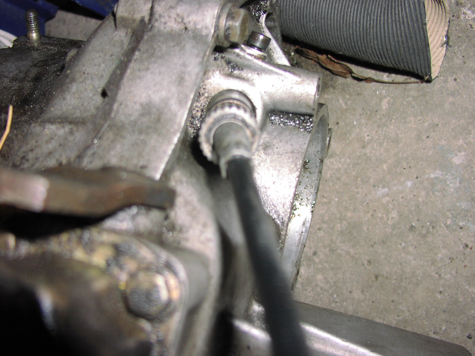

Please could somebody pot a photo of bottom/ gearbox part of the speedo cable when not fitted to gb?
Reason for me asking is that my gb don't seems to accept the new speedo cable, no gap between the gb case and the white plastic drive screw.
Strange thing is that the old one was exact the same.

As far as it goes, i'm a bit concern about driving it to Masham, the engine is still overheating, fan does not kick in - new fan switch required. Gearbox is leaking thru speedo cable pick up point.

I think a little incontinence is fair enough after 25 years service, it proves fluids are still in there. I may bring a funnel and tools to top up our gearbox oil if you wish to borrow.
