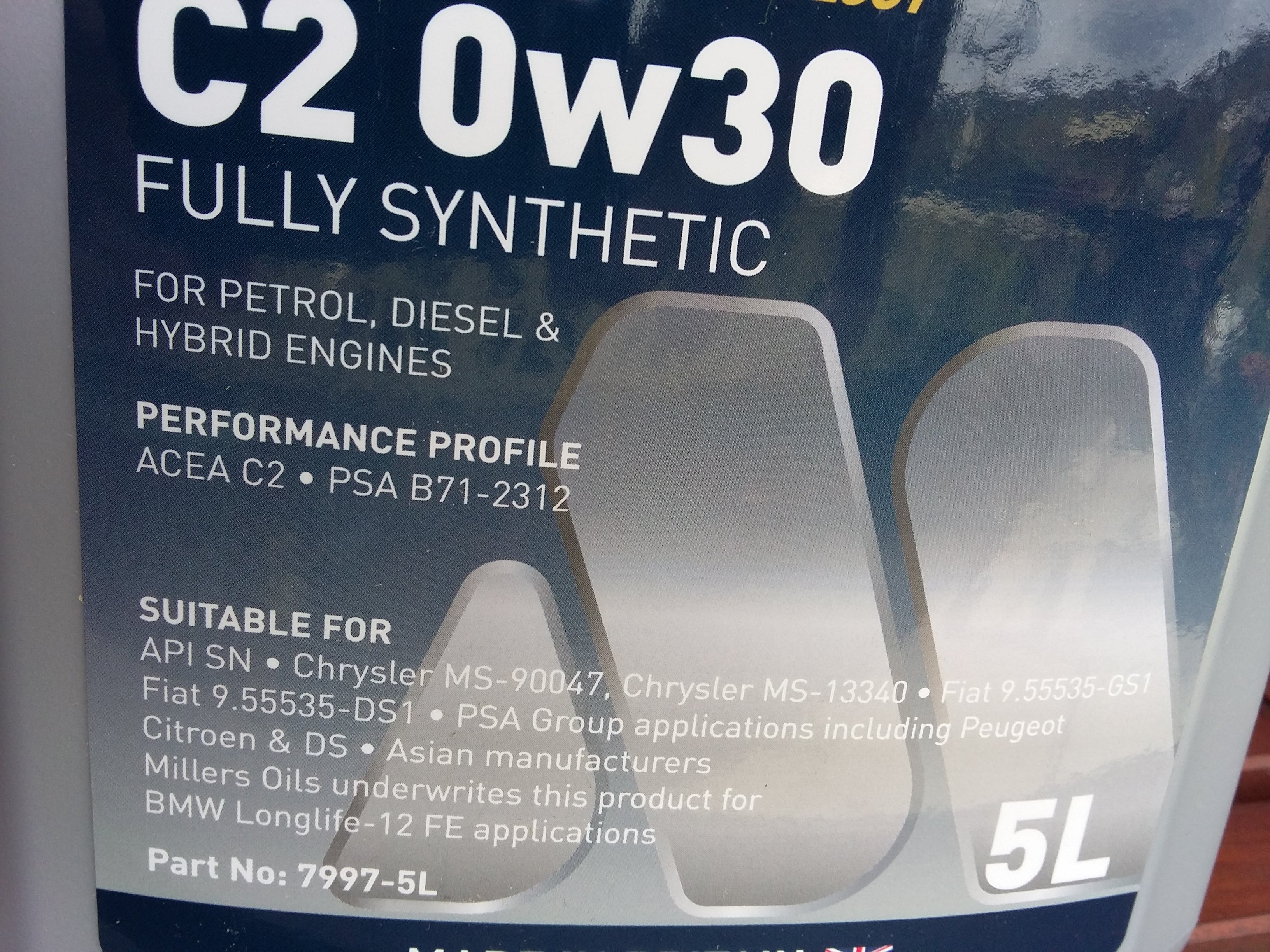

I believe that is the Millers I put in my TA, Nothing bad to say against it 🙂
Image from its change a while back..
Image from its change a while back.. View attachment 444850

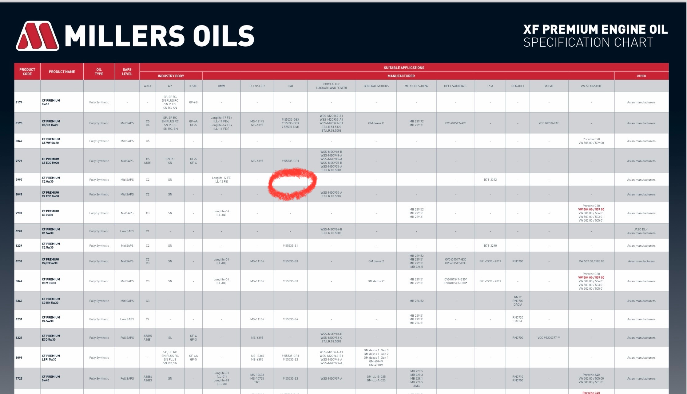

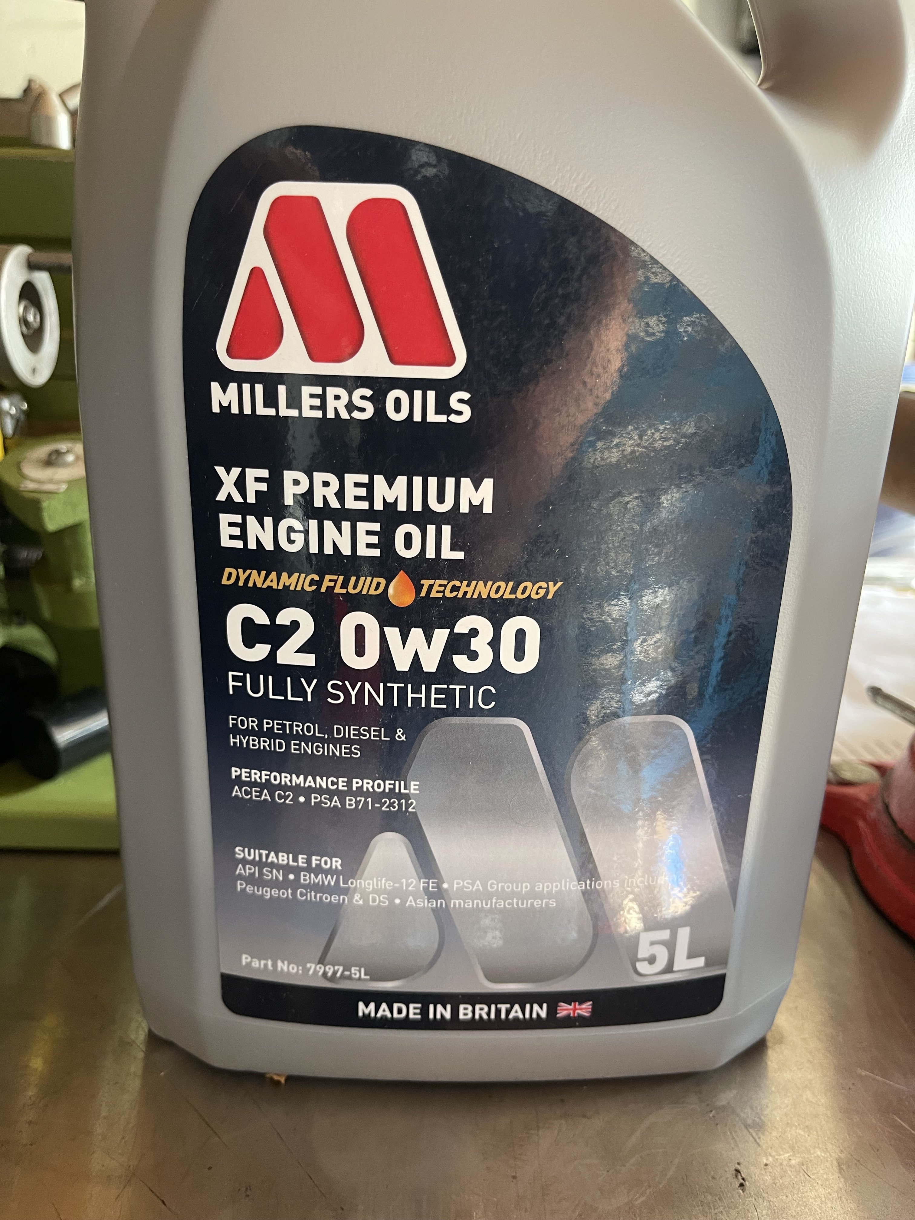

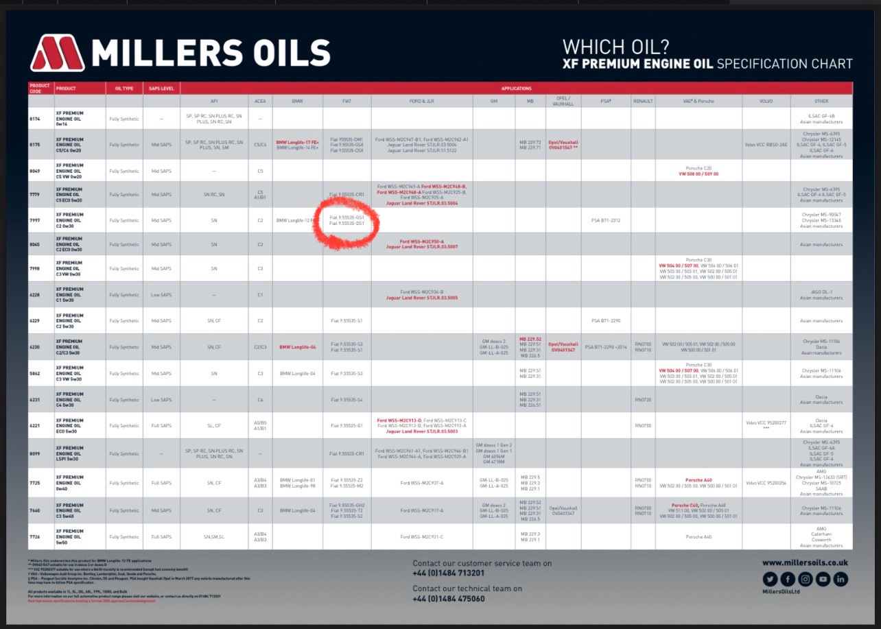

I have just purchased the exact same oil but it no longer has the suitable for Fiat 9.55535-GS1 written on it and the application chart on their web site for product code 7997 has removed the Fiat approval. How strange

Same chart, different approvals?

Yes, still says PSA B71-2312 on the bottle. I’m happy to use it, as it seems several on this forum use this oil with success, just seems odd that Millers have removed the Fiat accreditation.
Possibly just a tidying of it ..
now Stellantis rule the ROOST?
As I posted elsewhere..
My new purchase TA is on NAPA oil
Meets PSA spec.. But not listed for FIAT 🤔
