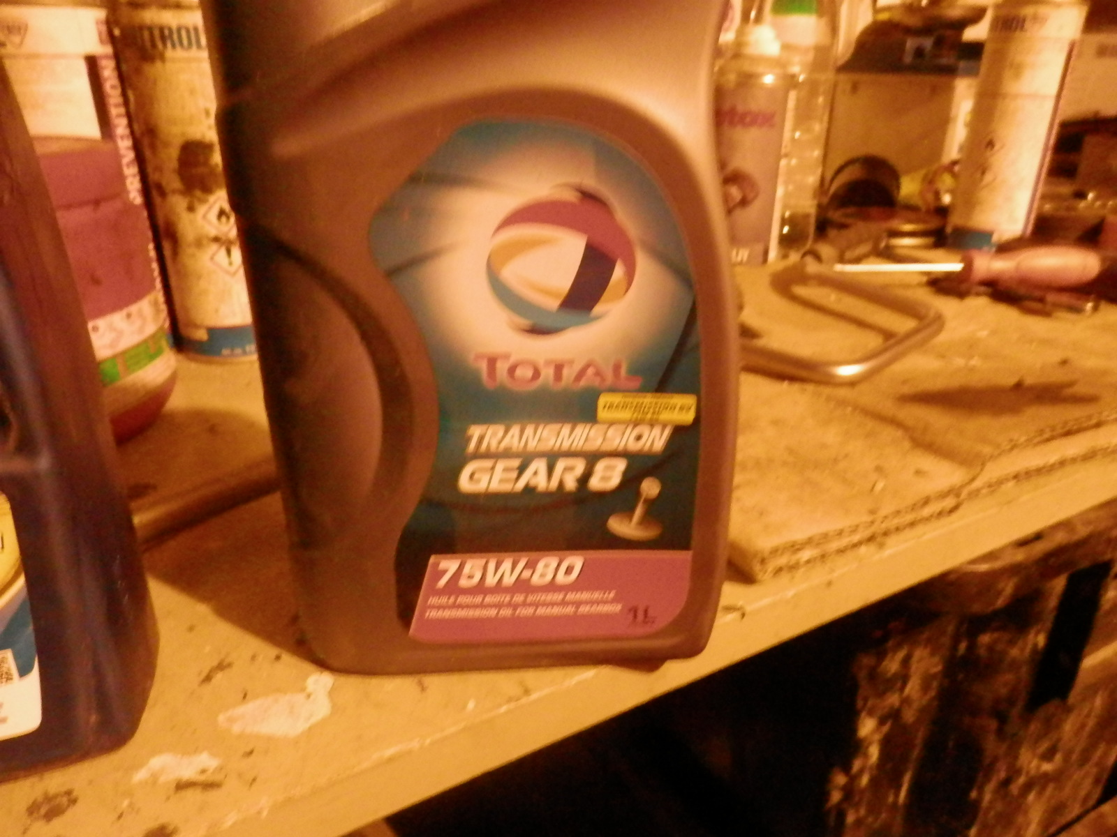

Also wondering when doing the clutch if that's good time to ask him to change the gearbox oil and if so which one is suitable for the MK 2 1.2 Sporting?
Might as well be done at the same time.
Total gear 8 was recommended here by one person and it works for me.

Thanks for the recommendation - I take it that's not a Synthetic Oil?
I saw Castrol Syntrans Multivehicle 75w90 Gear Oil at a bit of a discount so order 2 bottles of that, as it was fully Synthetic and had many great reviews from people saying it helped make their gears easier to shift.
Normally I buy most car things I need from EuroCarParts but their prices for GearBox oil was so expensive, ended up buying from Amazon.
That 90 might cause your gear changes to be very stiff

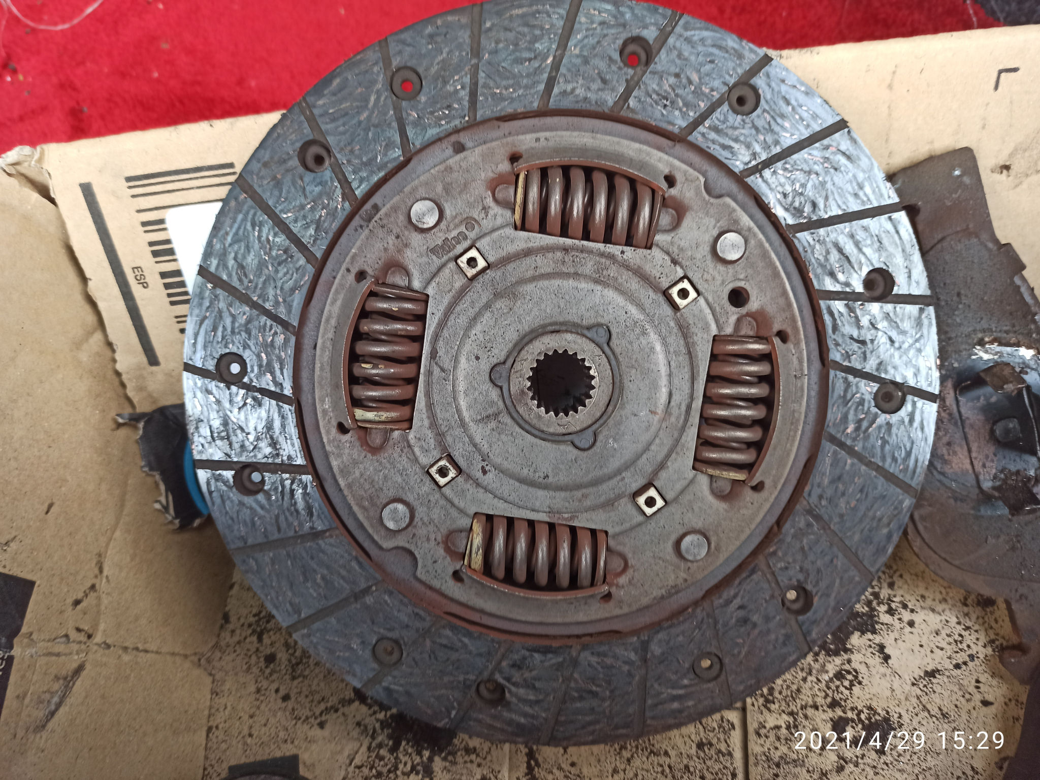

This is the clutch that was removed today - 21 years old and about 37,500 miles on it mainly in city driving.
Any observations about the clutch?

The clutch lining looks good but I am thinking the fingers on the pressure plate are more worn in the 3 to 6 oclock position and they will now have less contact and that will create an out of balance pressure on the rotating clutch lining. I do have my old clutch here so i will check mine in the next day or so.
Yes I do think the mechanic also pointed to the fingers part as being the worn out part.
Just got back from a 100 mile trip from one end of London to the other. Everything working great. The car pulls away nicely, no more juddering - The clutch is much lighter - think I've already gotten used to it.
