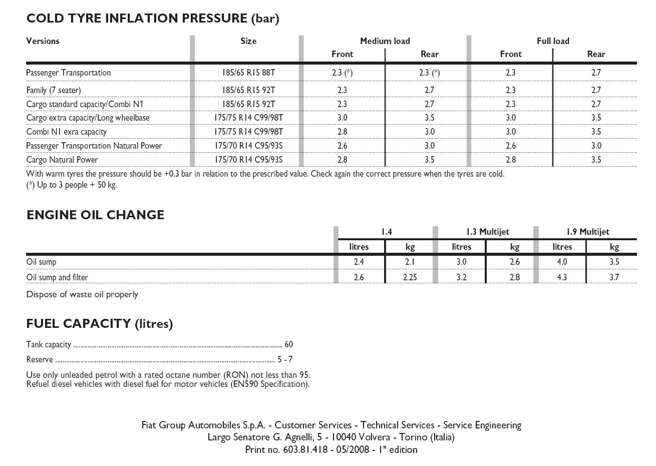

I am a newbie and have what is a strange question, I have a Doblo 08 req with a wheel chair access. could any one tell me of the fuel tank capacity because I am getting a fuel low light and a low reading on the dash and when I go to fill can only get about £12 of fuel in and the tank is full.
Thanks .
Hi, Welcome to the forum.
The 2008 Doblo owners handbook says 60 Litres.
