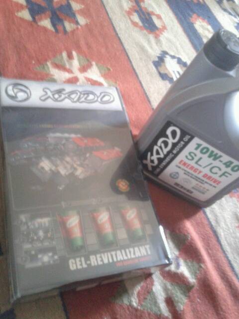

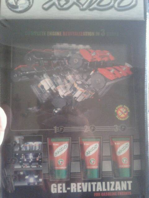

I just recieved xado revitalizant gel and 10w-40 motor oil for 235k km
After reading many reviews this gel is suppose to increase engine compression reduce fuel consumption and it tested by TÜV
I tought about share this here in case that anyone may need such treatment
has anyone tried it already?
