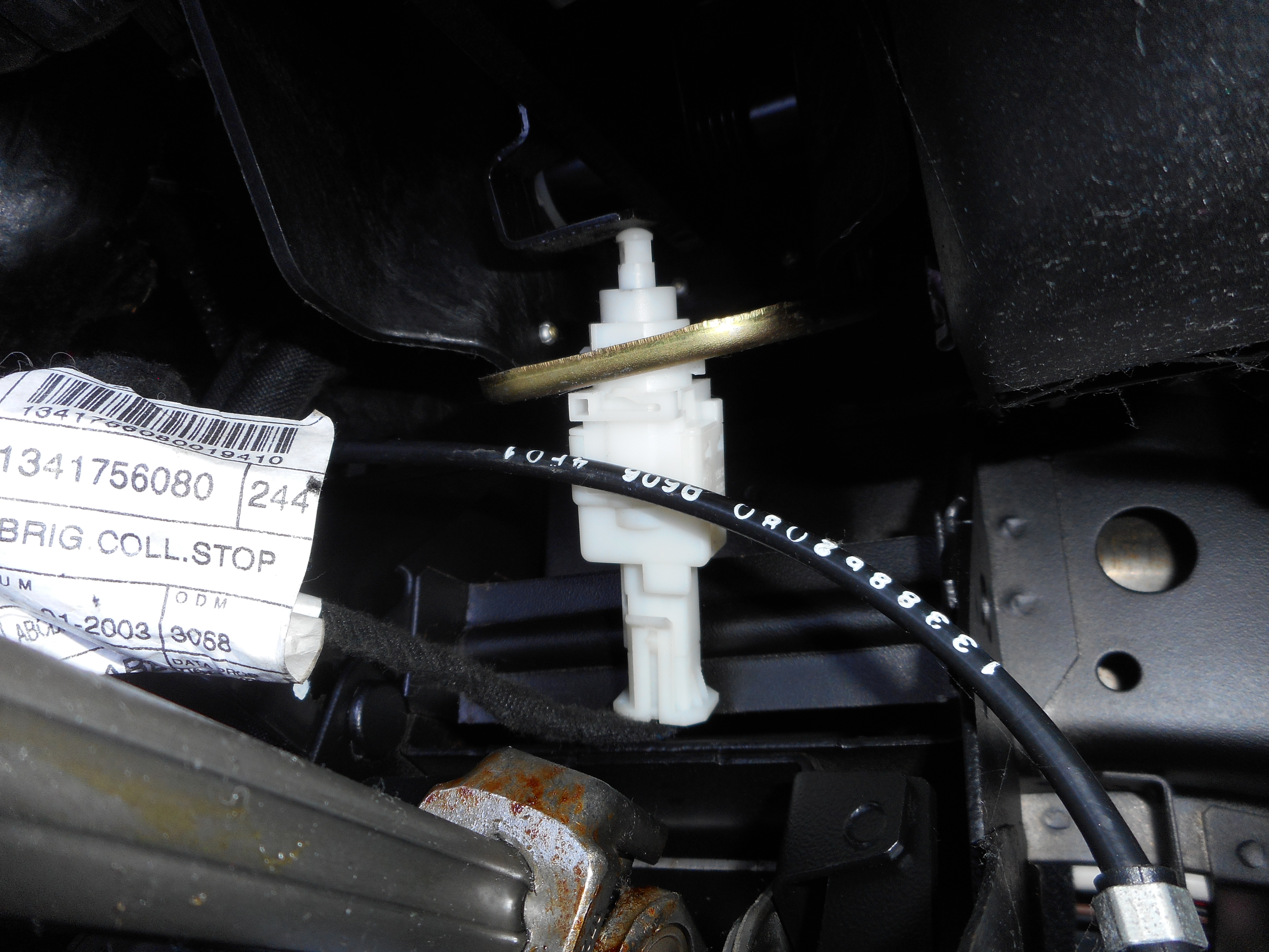

How the hell can I change the brake light switch?? There is no room to get it out, once the bayonet action has been done. It is easy to disengage the lugs, as its only a 1/4 turn, but it is completely impossible to pull the switch away from the mounting plate. Even the wiring plug can't be removed, as there simply is not room. If the plug could be taken out, the switch body would be easy. But its all solid steel all around the bloody thing. There is no room at all so short of smashing the old one to bits, (which would still leave the replacement impossible for all the same reasons), what can be done?
This is a real PITFA! Has onyone done it? This is a major, but MAJOR design fault.
Nurse! Medication!!:cry:

My answer to the brake light switch problem was to partly release the switch as you have done, and then file a slot about 3 to 4mm deep in the bracket above rear of the switch. (In the interests of structural integrity keep a radius in the corners.) After removing the connector the slot may be enlarged with slightly less difficulty. Also I trimmed about 1mm from the upper flange of the connector, using small side cutters.
The metal to be filed seems to be a stiffening bracket, and part of the steering column support. The steel could be high tensile and work hardened at the edges by shearing during manufacture, anyway filing seemed easier once I got through the edge.
I recommend using eye protection.
If your vehicle is similar to mine (2006 x244) I do not think that removing the switch support bracket is feasable, as it seems to be fixed to the pedal bracket with four pop rivets. The upper two are impossible to reach. That meant that the remaing option was to attempt partial removal of the pedal assembly. Filing the slot seemed the least traumatic option.

Its a ridiculous state of affairs, really. The 'everlasting brake switch'- it better be in view of the foregoing. I have to work upside down, wrong handed and no room to swing a file, so thought that I would have to bend the bracket down, remove and replace switch, bend bracket back. Trying to find how many and where are the screws that hold on the lower dash panel, and what needs to be removed before it, but my manual is lacking in some pages and much detail. I can't work directly in front of the area as there is stuff below the seat, so even if seat was removed access is still apalling.

Regarding the cause of the problem, I am tempted to speculate that it could simply be the adoption of the adaptor lead. The socket on this lead has a chefs hat sort of shape. It is the rim that will not pass through the slot. This rim is not present on the original harness connector. Another possibility is a design change involving lowering of the obstructing cross member, without fully appreciating the implications.
I think you are a bit off the track here,there is no slot. If there was, I'd be all over it as a possible escape route. I'm not going to put 2 relays in, that would be silly IMHO, all I need is a + ignition switched feed that goes away when the brakes are applied. There will be a way, without too much sophistry. I THINK! But we'll see, keep the info coming as ever, all welcome you know. Many people have done what I'm trying to do, just me trying to find any alternatives to possible pitfalls, and the crazee brake pedal scenario- thats what will crash and burn this time.
Ocwobio,
I have no wish to start an argument. I have better things to do. If you look at your photo attached to your original post of this thread. the slot to that I widened is immediately to the right of the switch in your picture, that is towards the LHS of the vehicle. At the other side of the switch the slot is obscured by the cable form attached to the switch connector. On my vehicle (2006 x244) the slot is a little over 13mm wide, and the section that I widened by filing the upper edge, will easily accept a piece of 15mm copper tube used as a rough gauge.

it looks like there are options, if a little involved. I will be looking for another, shorter, connector for the switch, which hopefully will give the clearance needed to permit getting the switch back far enough to disengage fully from its bracket and remove. Failing that, I wmay get my minitool and a small grinder bit and trim a clearance from the black angled bracket to allow room for the connector to be withdrawn sufficiently, or just re-terminate the wires to the switch with correct mating female spades. But first, i'm going to show the mounting bracket (the zinc passivated one) a little 'love' with an adjustable spanner or vice grips, to see if it can be strong armed down enough to get the switch out, without causing permanent trauma (to me or the plate!). Then once the parts are off, I can look for a workable plan B as to future proof potential dis/connection or removal if ever needed. There is an acceptable connector elsewhere in the dash that can be bridged, but it involves too much extra panel removal until I get lucky and find it. It all makes work for the working man to do.....

Hugh,, I was trying to get the switch out and putting as much force on it as I dared, and lo! The seperate part you refer to did indeed disengage at one side, and i could have easily got the top half off. But! I was wary that springs and contacts would shoot hither and yon, and if that was so, then putting the other one in thus wise would be impossible. When the old one is out, I will try pulling the parts from each other, see if that is an option for the other sufferes out there, but until then, not risking it, lol.

Having been through this exercise, I would not recommend trying to reassemble the switch while lying with your head wedged under the pedals, and with very limited access for your hands.
Thanks for the link to the crowbar technique. It must have been a very short crowbar. Tyre lever perhaps? To be of any help, it would be necessary to permanently deform the steelwork behind the switch. Not the best of ideas, considering that it appears to be part of the steering column support.
