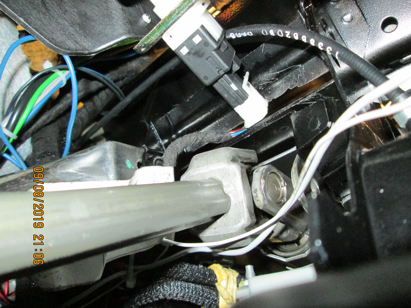

Communicator- you refererred to a 'slot' behind your switch, I did not have this to contend with, just an angle on a cross piece that angled down towards the connector plug. That was in retrospect a pain but able to be dealt with without surgery or bending the bracket as I was first inclined to try. I don't know if my pic shows in enough detail? I would have thought it being Fiat structure, it was the same. Never mind, 'tis dealt with now on my wagon.

For "slot" please see photo. I am not pleased with the standard of my filing, to the right of the switch in photo, but it worked for me.

Haha! It looks all too familiar! Was it only yesterday.......?
Indeed it was. It is identical to my set up, I see where you filed it. It doesn't look that bad, you are too modest- remember just how bad access is, and take a crumb of comfort.
As I said, I would be able to cope now, I believe. If I had been as badly stumped as I thought I was, I could have broken the old one off, it occurs to me, and just used heatshrink insulated spades on the new switch, and as long as they fit well enough I reckon it would be Ok. I have had a look on the Intermotor online catalog for stoplight swsitches, and there are lots that only connect with plain spades, and even come with them.
