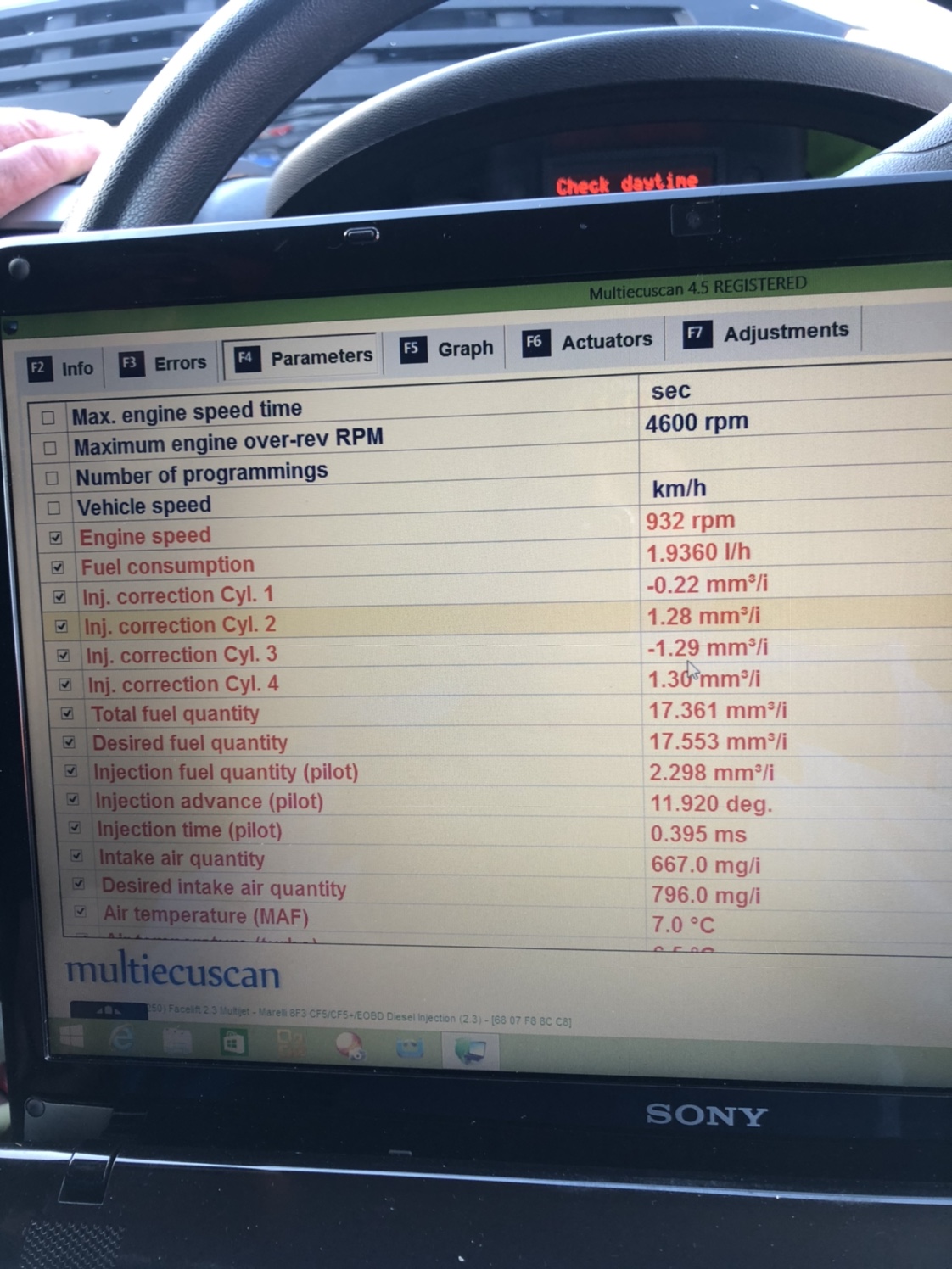

Thanks as i am having a starting issue also.
Never used this MES before...
are you using OBDII cable or bluetooth OBDII dongle?
Can you capture the Water in Fuel, glowplugs and post photo?
This is my photo... Trying to see the normal reading.
I drained fuel out of the filter but no water.
No warning light on dash either but program says it's on?
It would really help me if you could.
Trying to make sense of MES and determine if this bluetooth dongle is reading properly?
