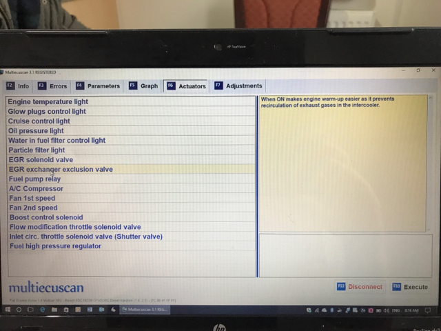

I found this on simulate mode does anyone know if this would help, I take it this does not deactivate the egr valve just a part into the inter cooler, finally can MES deactivate the egr valve
