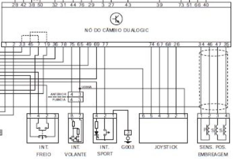

Hi I am working on a mate's Grand Punto 2008 1.4 petrol auto.
Gearbox problems
Codes P060C control unit faulty (microprocessor)
p1772 Gerashift lever switches ( one of 4)
Does any one have a wiring diagram for the actuator please, I have access to Autodata but they have nothing on the auto
I could do with the diagram and pin data if possible
or any other information on this problem please

Anyway, the gear-lever is built around 10 Hall-effect sensors whose status are internally converted to four analogue signals going to the AMT controler. No clue what those signals are/should be :-(
The attached drawing might not be the correct one so be carefull with using it !
BRs, Bernie

Found a much better quality wiring diagram …
BRs, Bernie
If someone here helped You fix -or better, understand- your issue, hit the thanks icon @ bottom right corner, it's free and makes us feel helpy ;-)
edit: replaced picture
Hi Bernie, That is brilliant, I will mark out the power and grounds and check them tomorrow as the car is at work.
Many Many Thanks
Paul
