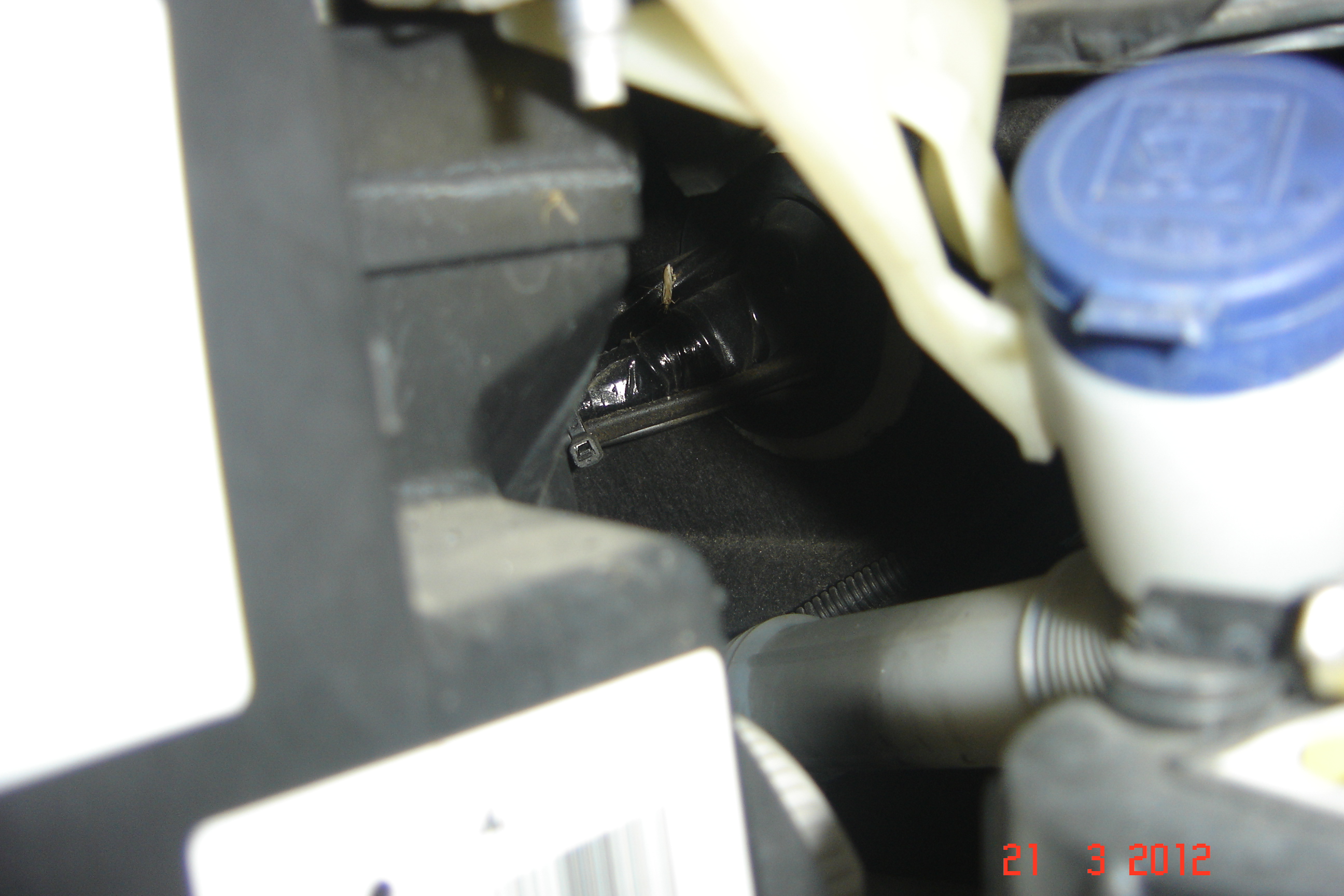

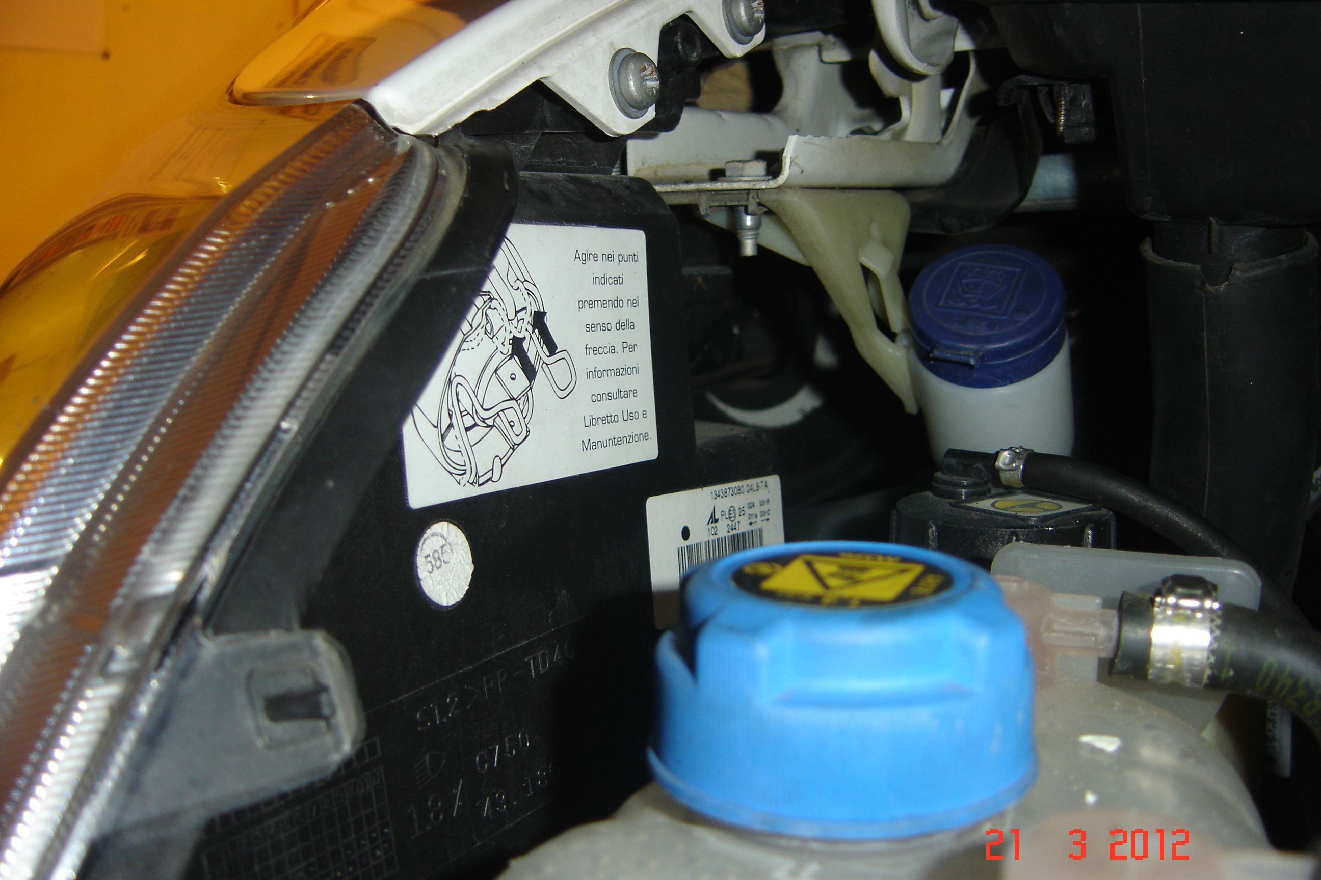

DFK, I've got an X250 in the shop tonight so took a couple of pics for you. Pics looking in to firewall from in front of van, view behind RH headlight.

Thanks.Hopefully will go at it this weekend.
Hi ARRK was trying to get the headlamp off so removed the top plastic ok but when I took the screw out of the lower plastic is was loose but would not come off. Didn't want to just force it and break some clips. Any tips on which way I should pull it.
We often have to put a small screwdriver in the top section of the panel to pop it out. Put some tape on the screwdriver so it doesn't mark the panel.

Thanks for that. 2 clips both at top center.
Yes you have to remove rh headlamp to gain access to wiring grommet I pushed a wire coat hanger through but there was quite some resistance so smeared a little grease and went through ok then taped my wire to the hanger and gently got them through so next job is to cut out holes for the lamps in the bumber and wire up the relay nearly there just to add a separate switch as dont want canbus problems!
