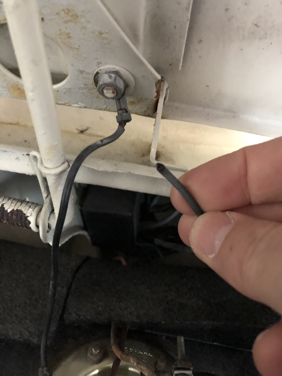

IMG_7517.JPG perfect diagnoses it seems. An earth wire has severed. Will fix this later, but 99% sure it’s the source of the problem!
View attachment 200396 perfect diagnoses it seems. An earth wire has severed. Will fix this later, but 99% sure it’s the source of the problem!

The issue has been rectified, in that I've managed to re-connect the wire, but I haven't relocated them yet. I certainly need to, as you can see the wires bending as the bonnet is closed, so it's no wonder that one of them sheered/snapped.

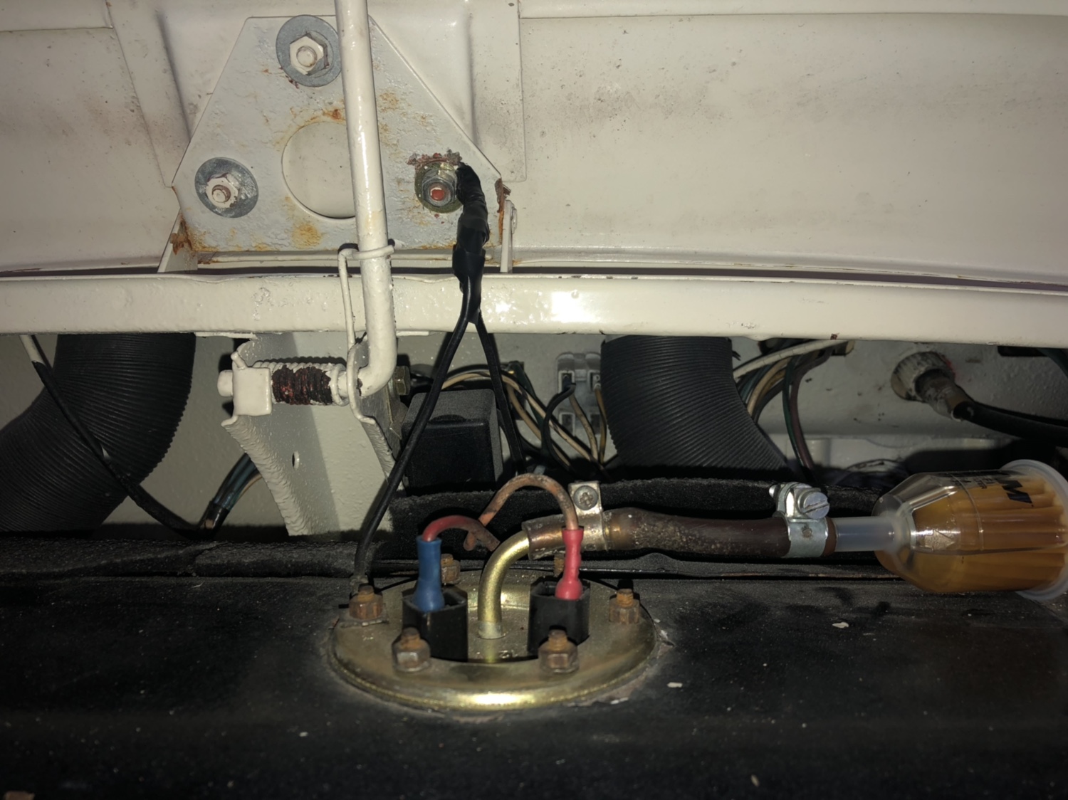

It’s directly below where you currently have the wires attached to the bonnet lid. See picture below, it’s the little silver cylinder by the heater hose. You can see the black wire you are dealing with in front of it.
Mine looks very different, and is bolted to the strut in the centre. Relocated the wires there though, as they no longer get folder by, or are stretched by, the action of the hinge.
