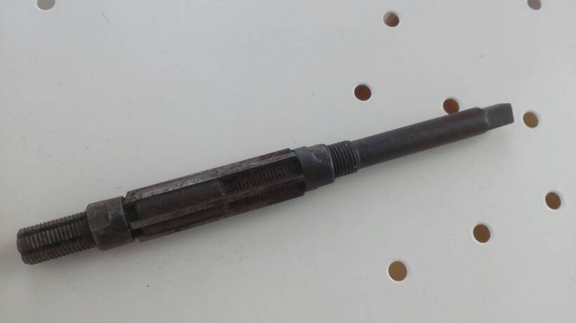

Look what I found. It needs a good clean. Frightening when I realise that I bought it for my first 500, which was 35 years ago.[emoji79]

does not have a pilot extension.... to locate in the second bush :(
or you end up are hoping to ream them in line...
That's the bit I didn't know back in 1982 but somehow got it through two MOTs. I hated kingpins and the regular need to renovate them back "in the day" was one of the reasons I fell out of love with 500s. It didn't used to be so easy to get spares or refurbished parts. I will look out for pilot(s) now.
the end of the reamer needs to be able to accept a pilot shaft.. usually they are specifically designed to do so...
it may be an internal thread, I don't think it would be too hard to have a machine shop do something...
simply drill the end of the shaft (yeahh I know probably hard metal) and make a corresponding extension that is slightly smaller, then a cone that slides on this that will locate in the opposite bush to the one you are reaming so the reamer will go through the one while the pilot and cone keep it straight in line with the second.. then flip it around.. and reverse it...
And you know how much effort I have put in to finding out about King pin Reamers...
or you could just weld a nail on the end an put a bit of wood in the bush with a hole in...
I would like to know if the Factory one is a double reamer or a single with a Pilot cone and extension...

The factory reamer might even be two factory reamers as it was with my prewar Austin. One reamer had a plain bottom end and the other had a plain section near the top....same effect as a pilot. The pilot wouldn't be hard to make from appropriately sized pipes and sockets from my scrap box.
Bet you have some 15mm copper pipe!!! bash it on the end of the Reamer
put one bush in... Ream it with the 15mm copper tube extension and a it of masking tape to pack out the kingpin without the bush
then turn it around and remove the masking tape as the king pins are 15mm !!!
Jobs a goodun..

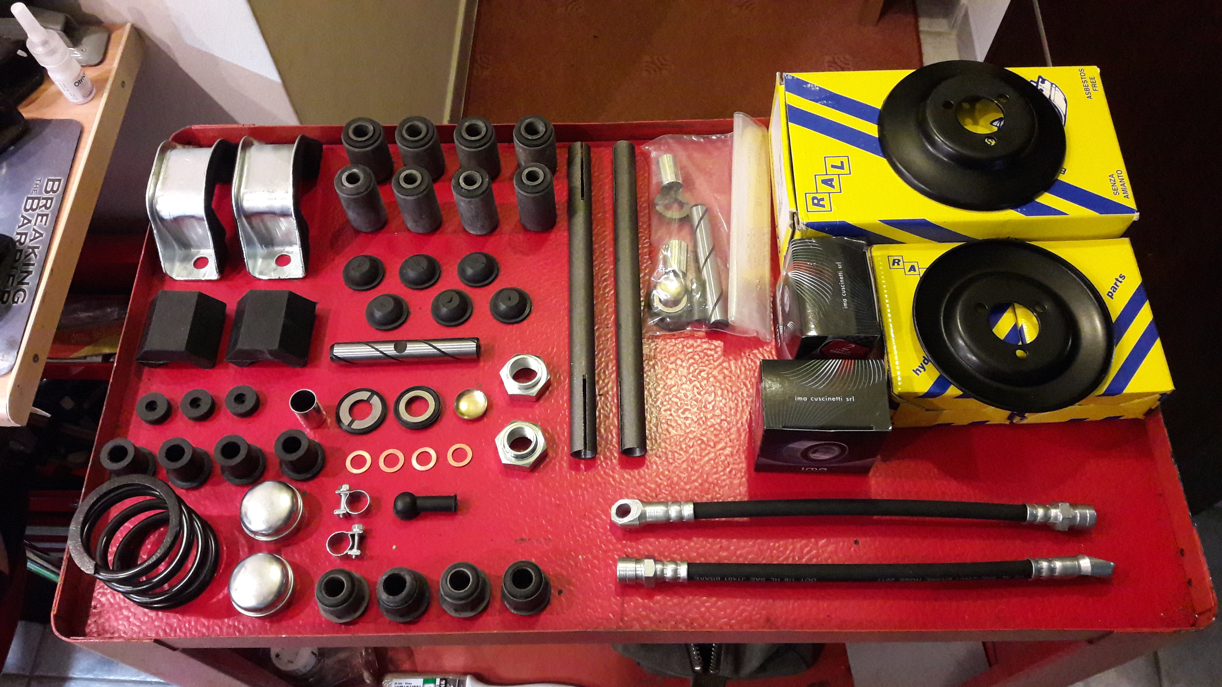

king pin set arrived yesterday. Set comes with two washers do you know which one goes up and which one goes down? The right one is thicker and smaller in diameter than the left. Also those two washers doesn't fit so i will have to take one down to make it fit.

One of the best moments of restoration is when new parts arrive, opening and inspecting all those little plastic bags.
