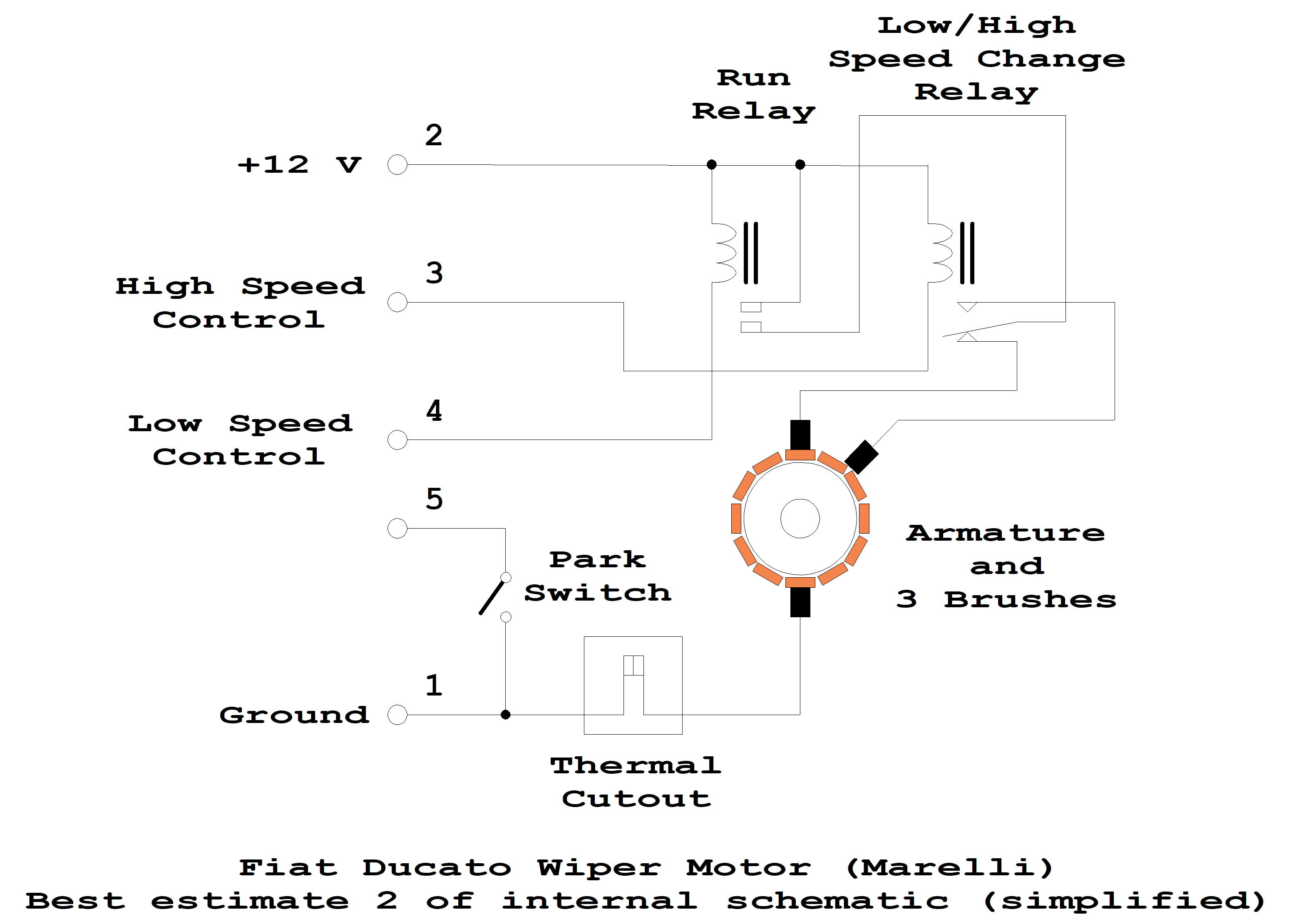

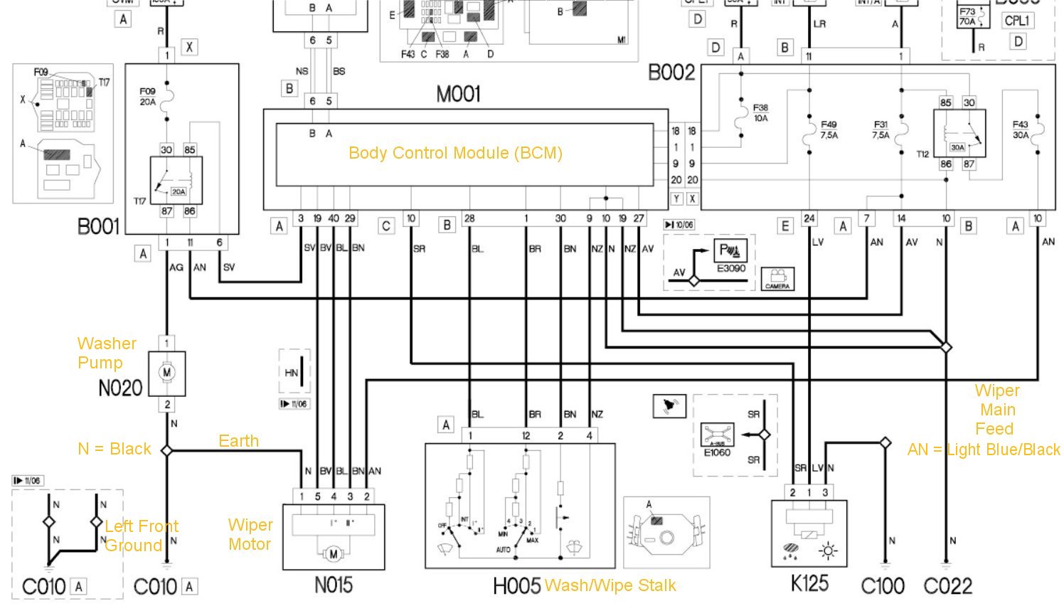

Hi Shortan
I only have schematics for earlier vehicles (2006 onward) but maybe yours is similar ? Attached is a schematic for the vehicle, and another one drawn by me to show what is inside the wiper motor.
The stalk switch tells the Body Control Module (BCM) what to do. I think your switch is OK.
The wiper motor gets +12 volts on Pin 2, via relay T12 and Fuse F43 (30 Amps). Ground is on pin 1.
There are two "logic" control inputs driven by the BCM, Pin 4 is grounded to run and +12 volts to stop. Pin 3 is grounded for High speed and +12 volts for Low speed.
There is one "logic" control output back to the BCM, Pin 5 is Open Circuit when the blades are sweeping the screen, and Ground when they are parked.
Wiper motors take quite a high current to run. It is unusual that the wipers still run with Fuse F43 removed, unless you have a short-circuit to +12 volts in the wiring. Check again that you have removed the correct fuse.
The next step for you (or your auto electrician !) is to connect thin extension wires to the 5 connections of the wiper motor and check all the voltages relative to a separate ground whilst it is running. Fold the blades out to avoid high friction on a dry screen.
