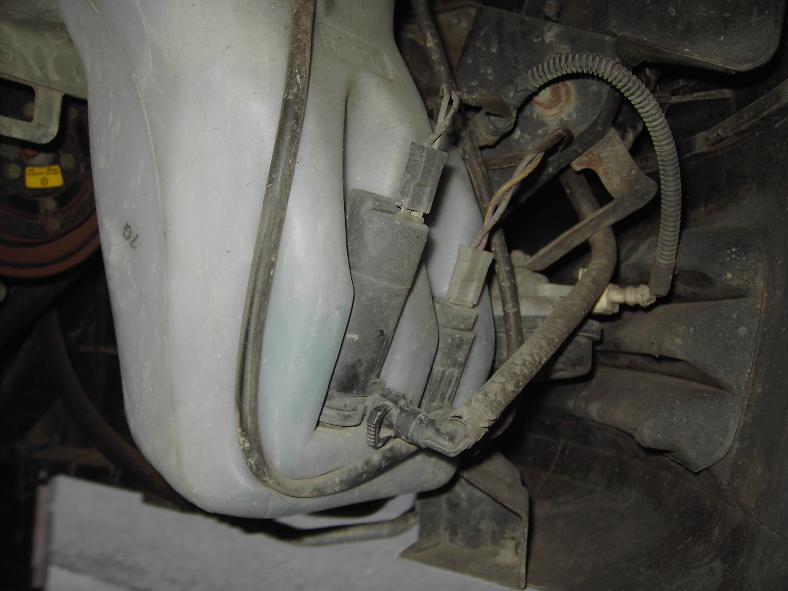

My washer pump has stopped working, no life in it. How do I access it to see if there is a loose electrical connection?
Hi, Welcome to the FF.
The windscreen washer pump is behind the right front wheel arch liner. The same pump is used for both the front and rear washers by reversing polarity at the two electrical terminals.
If your car doesn't have headlamp washers there will only be one pump attached to the washer reservoir, not two as in the picture below.
