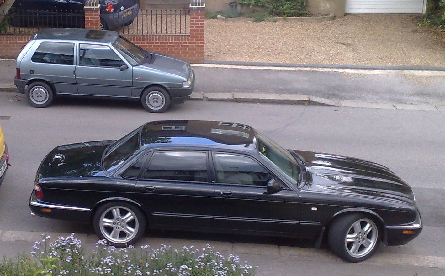

I`m currently tinting my spare set of glass for my Uno.
Having read the VOSA guidelines I think theres a possibility you can have up to a 30% tint on the front side windows, assuming the car being tinted has `sundym` tint glass as standard, a 20% film should be passable?
My 99 Jag XJR has black tint glass as standard & is a pretty hefty tint as you can see, & bear in mind it has a white interior.

The Jags about a medium tint, so its marginly better, still not good enough to spot plain clothes though...
