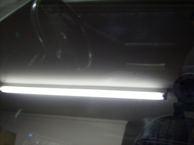

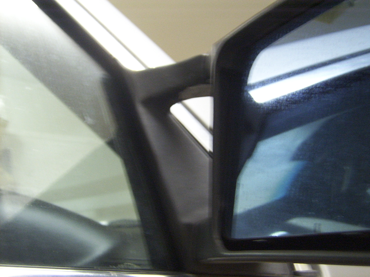

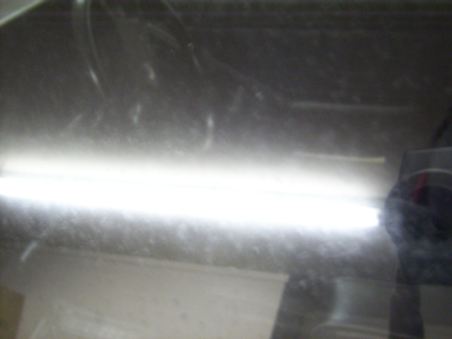

See attached pics - before and after cutting compound, I think you'll be able to tell which is which :)
-Alex
